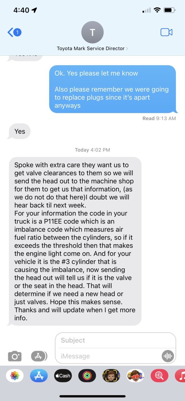

    Doesn’t seem like they are giving you the runaround at all based on that pic. And voila, a code finally appears. The brother code of the one I thought you may have (P11EC). I believe the usual solution is a new head.

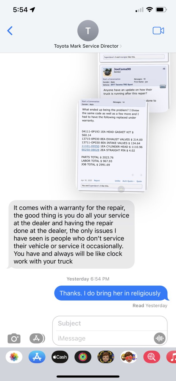

    Thank you Bill for your prediction. Thank you everyone for your support. It’s stressful to deal with I’ll admit. I couldn’t have baby or done right by this this anymore than I did. 08349615-6206-4A41-A5EA-19CB8066AA17.jpg08349615-6206-4A41-A5EA-19CB8066AA17.jpg
