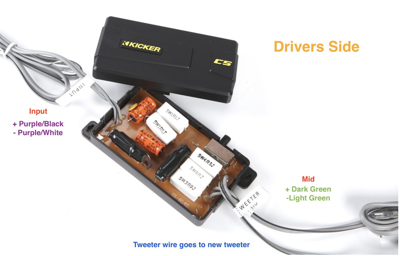

    The wires FROM the head unit to the tweeter are full range
    You DO still need the wire from the tweeter to the woofer, because that is what will be connecting your new woofer to your crossover
    Hopefully this helps
    Then, using the wire colors listed in post #6, repeat with passenger side

    the grey woofer wire from the crossover (labeled MID) needs to be connected to the green pair of wires at the tweeter location. This is how the audio gets through the wire boot and into the door where the woofer is. You can certainly try to run your own wire into the door, but its a bitch for sure.

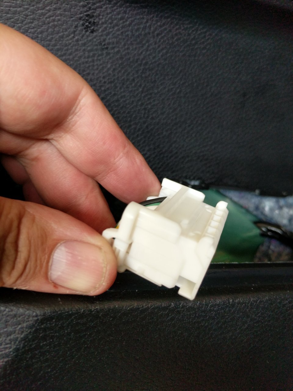

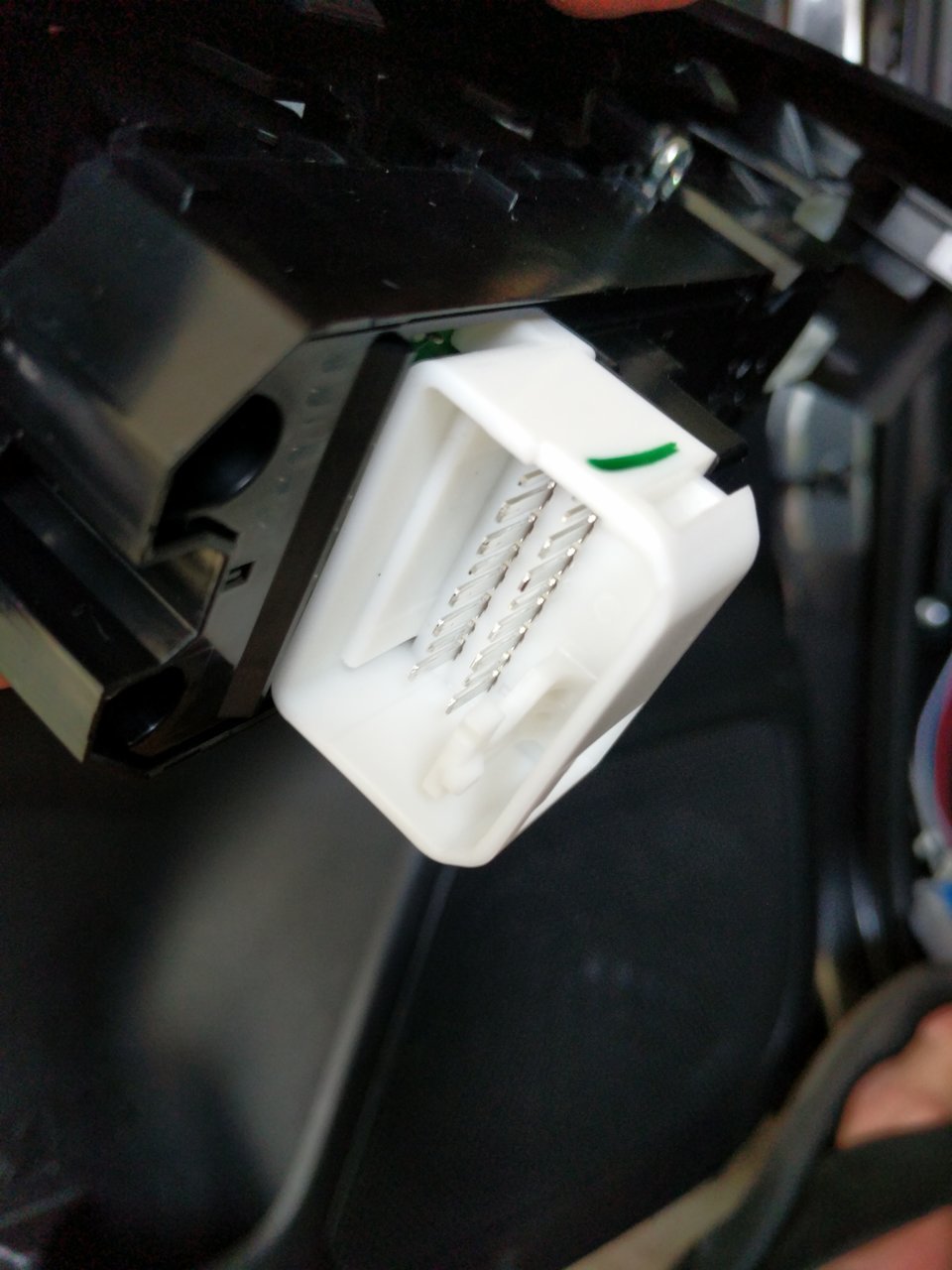

    One final question...how do I get the drivers side molex connector to hook back up with the window switches...there see.s to a trick I'm missing!

    Oh gosh. Without having it in my hand I don’t remember. I dot remember it ring difficult (but again, I do car electronics for a living so my thoughts are a bit skewed)

    I don't recall there being anything special to get that connector to plug back in. Just line up the green marker lines on the side of the plug and switch connector and push it in (you can see one in your picture). If I recall it only goes in one way.

    Maybe I broke it getting out but it just doesn't seem to want to reconnect. I did all the other doors with no problem. I don't want to force it too hard so I don't break it in case there is something I'm missing.
    I have it lined up correctly and it goes in about half way. There is a sliding locking mechanism that seems to keep it from reconnecting.

    that connector is 2 pieces. the part you are grabbing slides away from the other piece. hope that kind of helps.

    I know the slide part has to be out and it locks in as you push in the plug
    I think
    It’s been a year since I did my system so I’m foggy
    Sometimes just putting it down for a bit and coming back makes it work

    yea its like a sliding mechanism. youll need to separate the two pieces.
