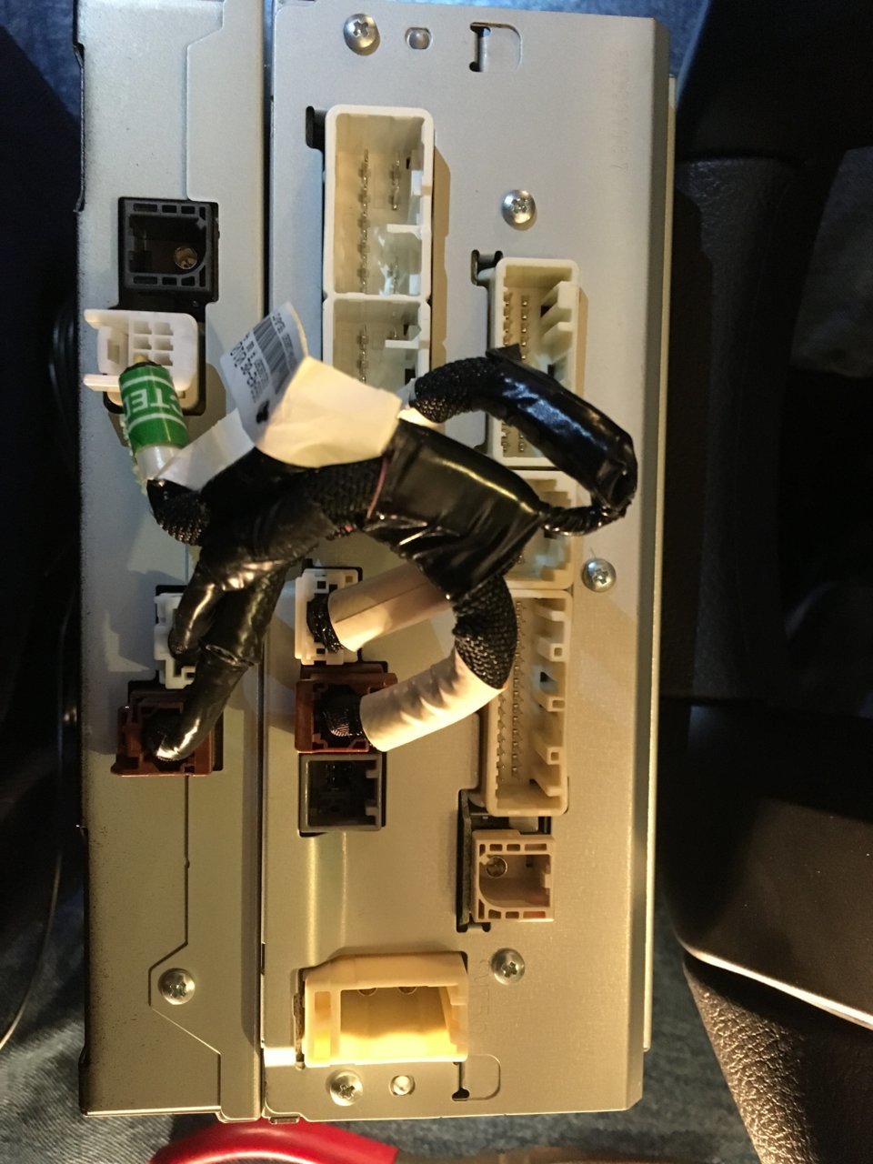

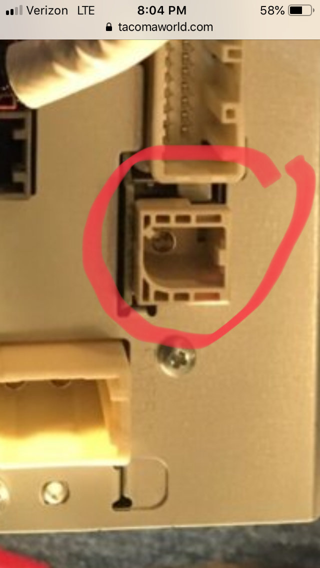

    I bought an upgrade radio for my 2018 SR (radio came from a 2017 Tacoma with XM). Great fit .. except:
    • My 2018 did not have XM therefore no XM fin connector is present. So,
    • I have an add-on Sirius XM antenna from the Dan (Thank you Dan - TacomaWorld DBuck294)
    • I have no issue adding the add-on Sirius XM antenna, however where do I order the connector for the XM radio to the add-on antenna? anyone know? (pic below of the back of the radio)

    Thank you Redneck! I will order now .... so, pardon the newbie question. Is the NAV antenna a separate antenna? and does it connect to the same port as the XM?

    GPS/Nav antenna plugs into this port:

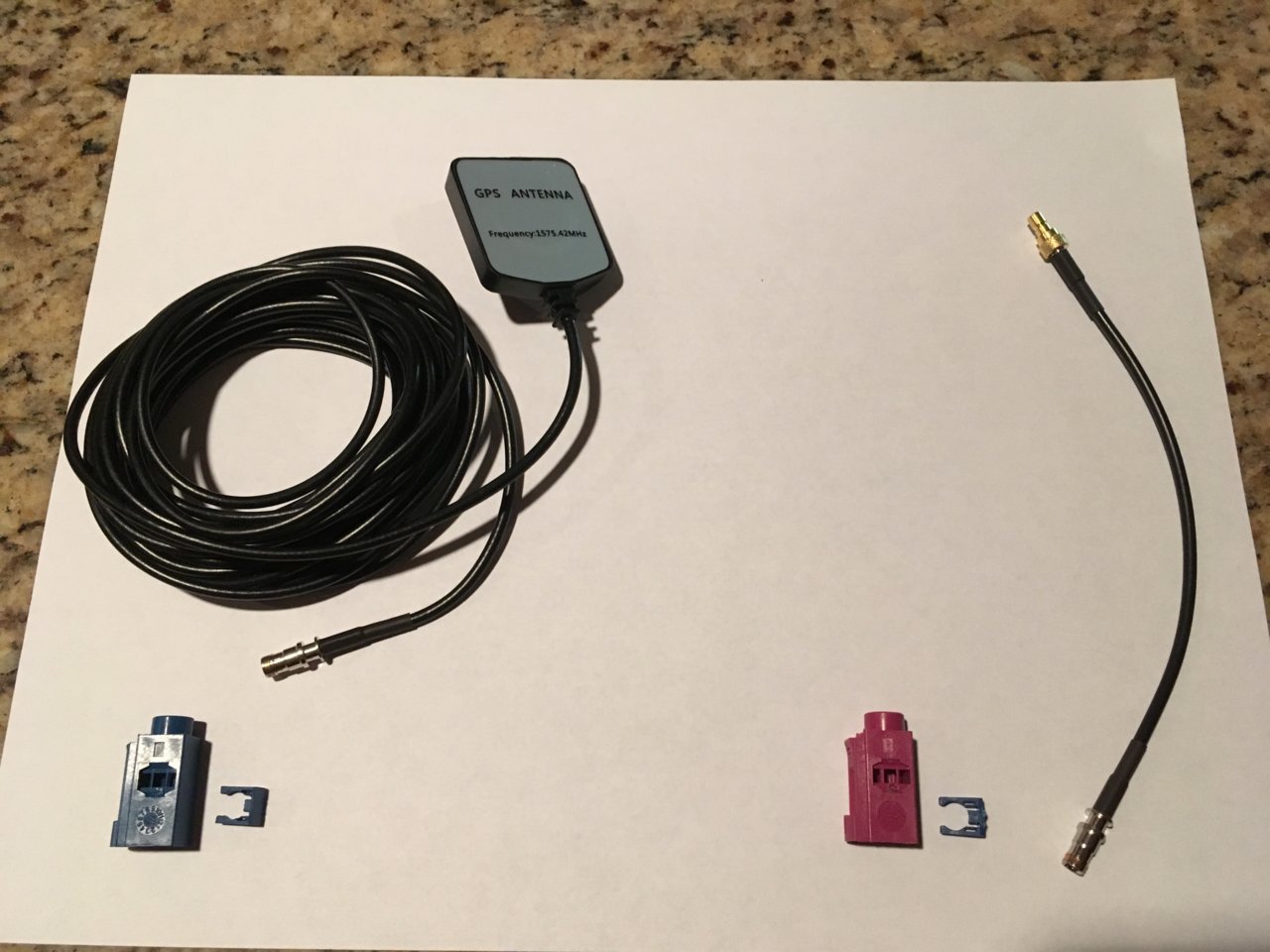

    (with tremendous support and guidance from 09 Redneck) I ordered the 2 links below (they will both be delivered to me on Friday):
    Active GPS Antenna Fakra VW Audi MFD2 RNS2 MFD3 RNS510 Sat Nav (make close work): [$12.99]
    https://www.amazon.com/gp/product/B006AKVX2S/ref=oh_aui_detailpage_o00_s00?ie=UTF8&psc=1
    Eightwood Fakra H Pink Female Socket to SMB Plug Male RF Cable 15cm 6" for Sirius XM Satellite Radio Antenna (to connect the XM antenna to the stock 2017 Tacoma XM radio): [$8.89]
    https://www.amazon.com/gp/product/B072L7WPK6/ref=oh_aui_detailpage_o00_s00?ie=UTF8&psc=1

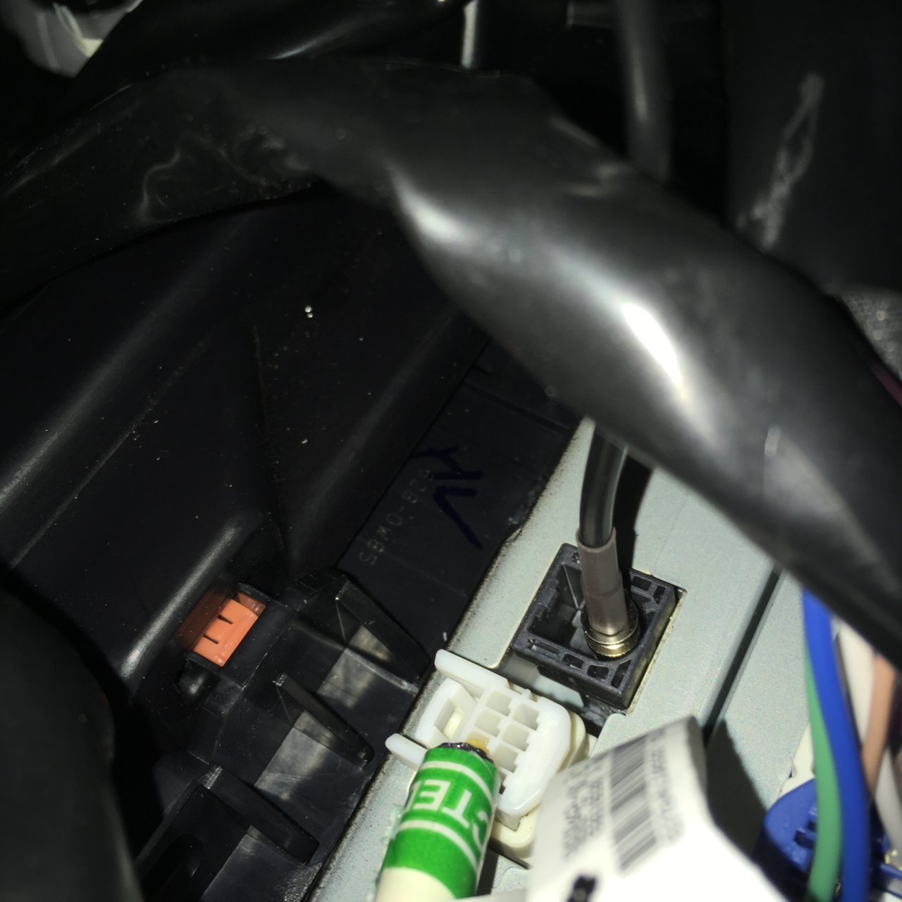

    SUCCESSFUL UPDATE:
    First, many thanks to DBuck249 and 09 Redneck for their invaluable guidance and support:

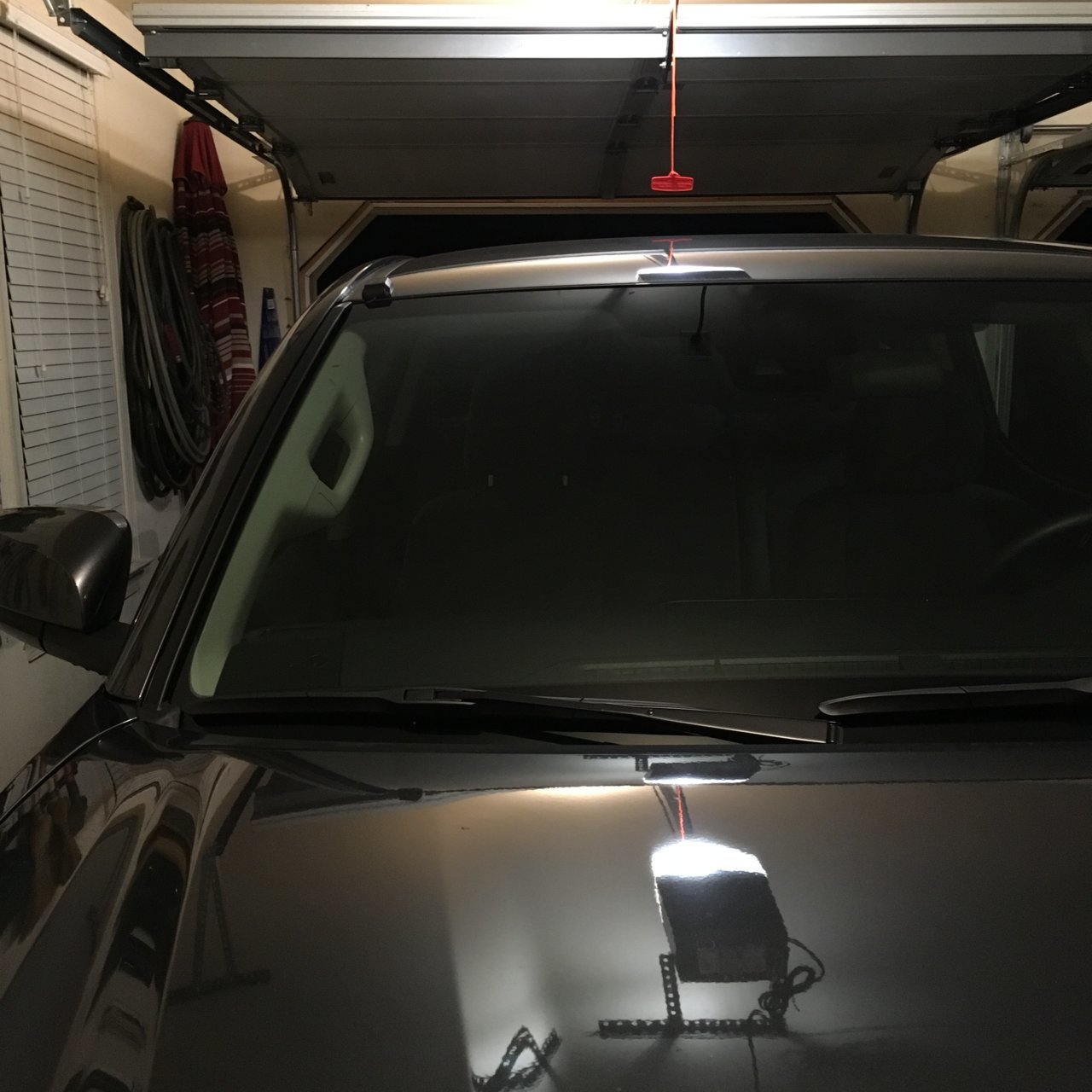

    1. Although you'll see the Sirius Antenna installed on my roof (it's magnetic), it won't be there long (I will find the fin wires and use the fin, but until then, I'll have XM)

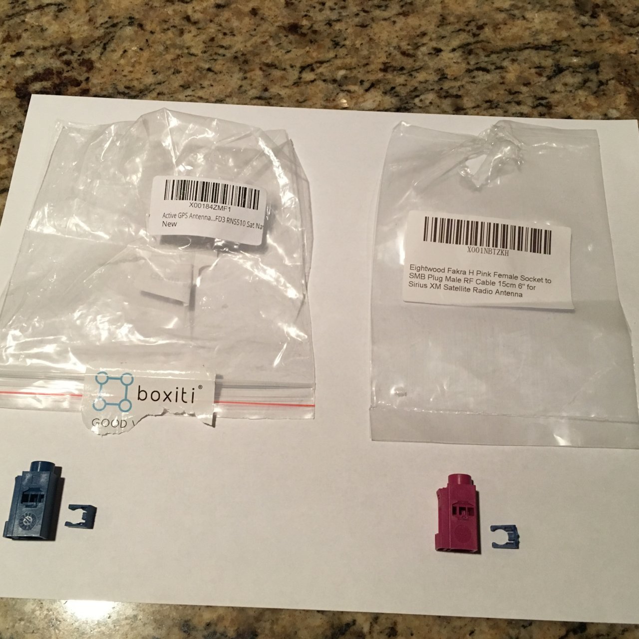

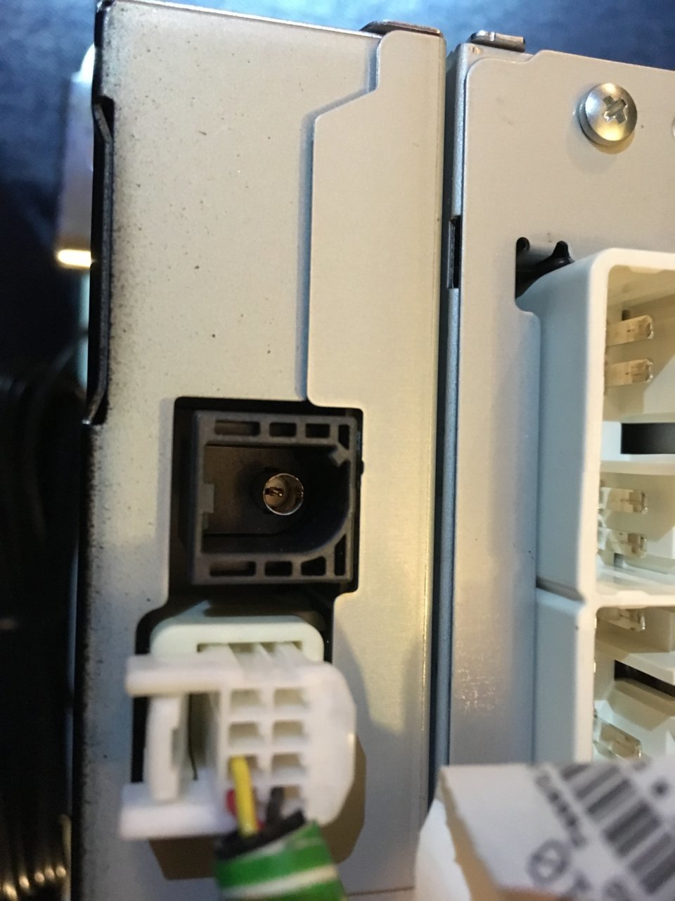

    2. I ordered and installed both (from Amazon) the Active GPS Antenna Fakra VW Audi MFD2 RNS2 MFD3 RNS510 Sat Nav (make close work): [$12.99] to allow the clock, weather, and traffic functions to work on the stock 2017 Tacoma 510102 XM Radio and the Eightwood Fakra H Pink Female Socket to SMB Plug Male RF Cable 15cm 6" for Sirius XM Satellite Radio Antenna (to connect the XM antenna to the stock 2017 Tacoma XM radio): [$8.89] to allow the XM to work
    3. XM Antenna: I ran the antenna through the passenger side of the firewall using an existing wire harness rubber boot
    4. GPS Antenna: Just sits on top of the radio
    5. Took about 1 hour and 30 minutes from start to finish (running the XM wire through the rubber boot on the firewall took 1 hour of the 1 hour and 30 minutes
    6. TIP: the plastic boots remove easily from the connectors (see pic attached). There are plastic inserts on each plastic fitting that are removable via a jewelers screw driver. These inserts hold the connector in-place and once removed, the connectors are pulled backwards through the plastic connector pretty easily. This made the job much simpler than I had anticipated.

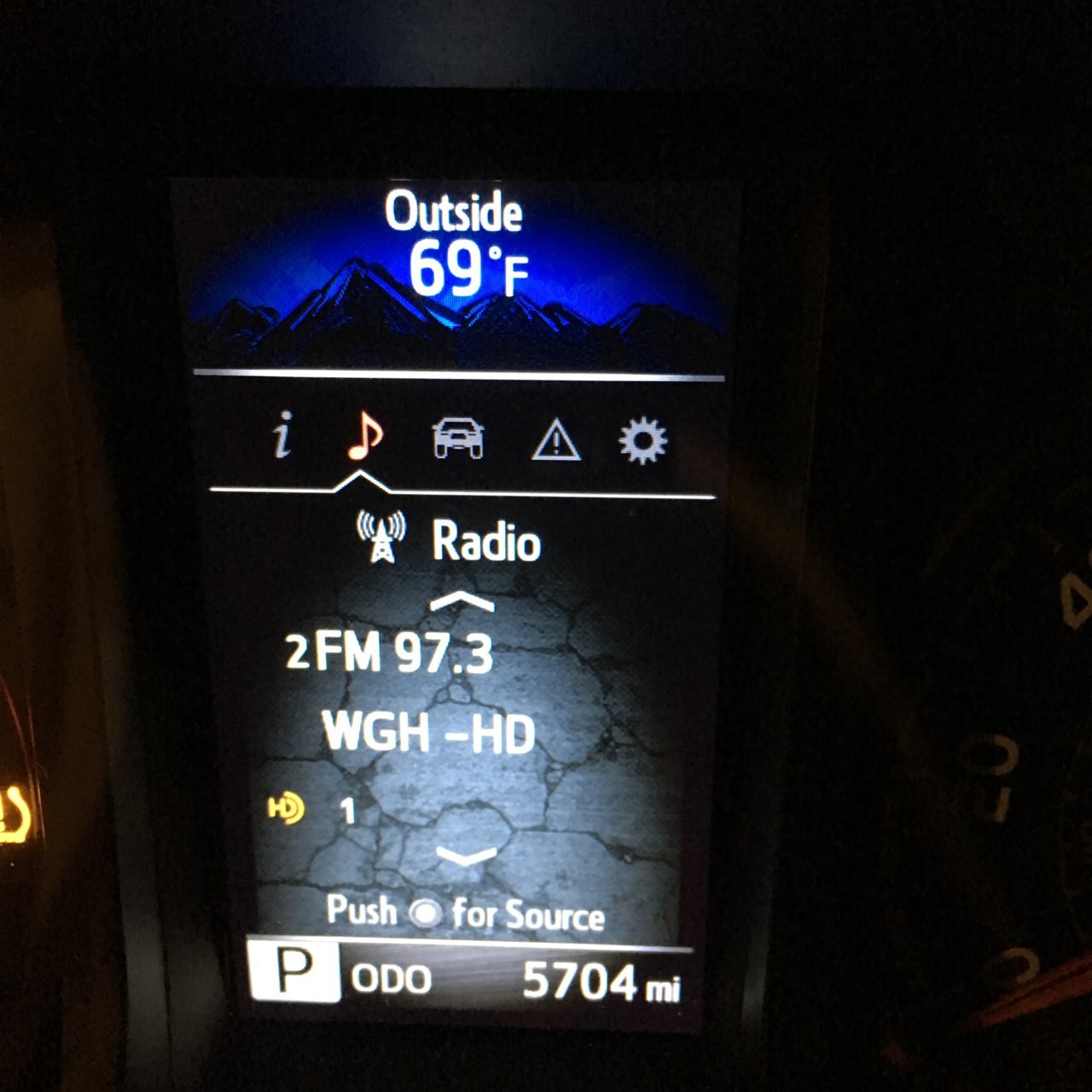

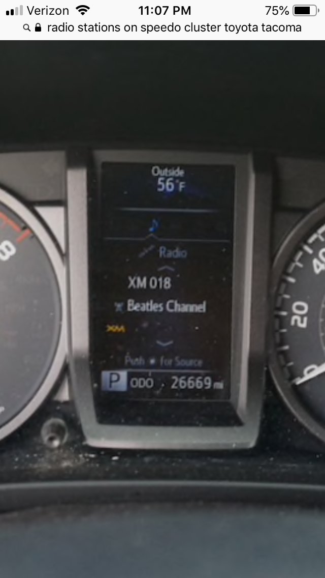

    Glad it all worked. Also, do the radio stations show up on the center speedo cluster now? Pic for reference.

    ronsheffield
    ronsheffield [OP] Bought a GMC Sierra (loved my Tacoma though)
    Jul 22, 2018
    #260177
    24
    You are the man!!!! Yes it does ... I had no idea.
