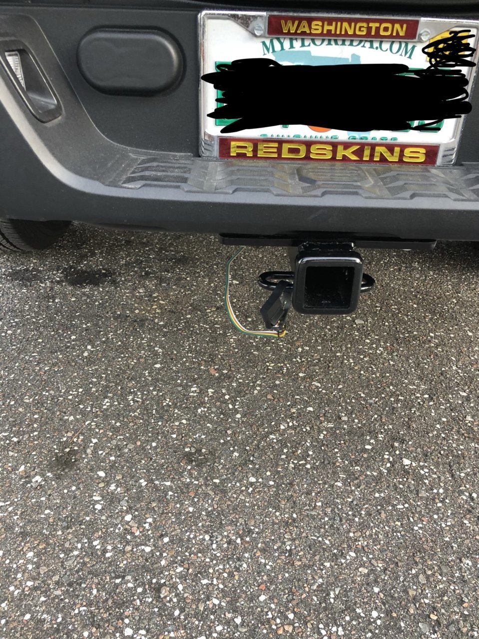

    Ran into a snag. When i went to the trailer place the guy ran out of the 7/4 pin connector so he installed the 4 flat connector instead. Now i have to cut that off.

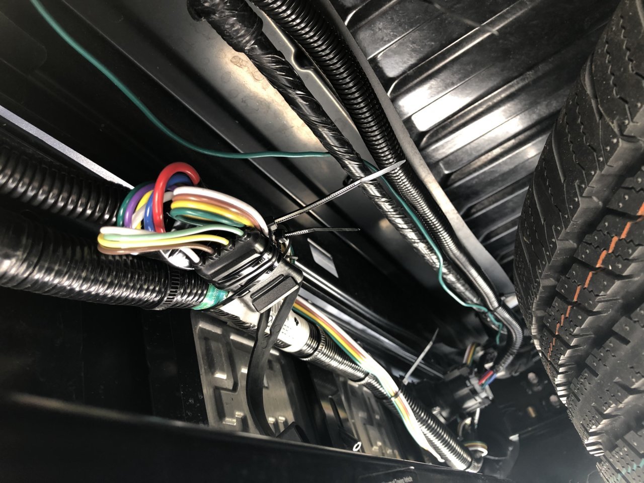

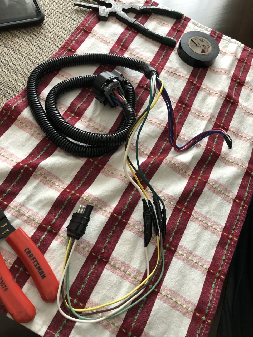

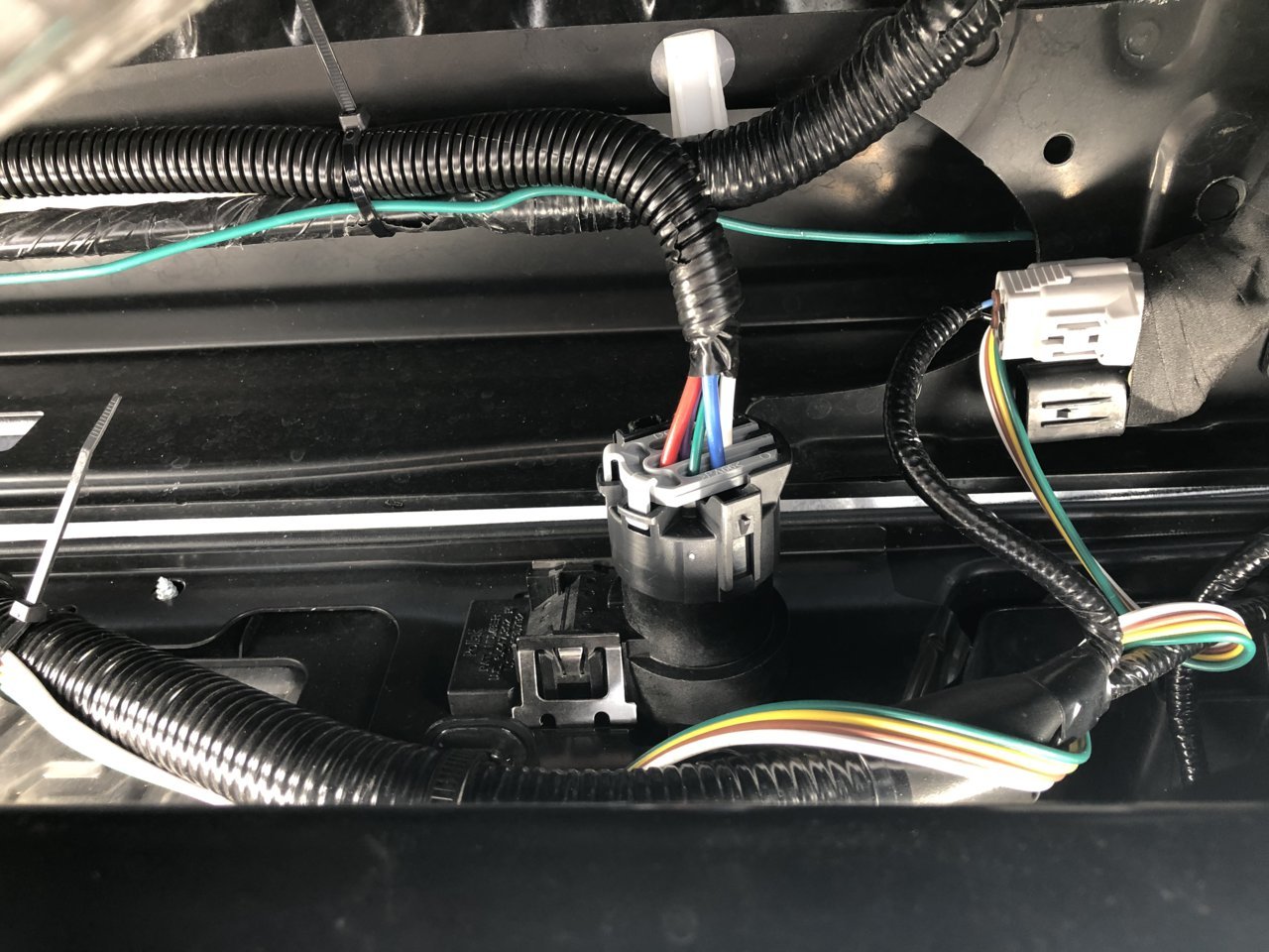

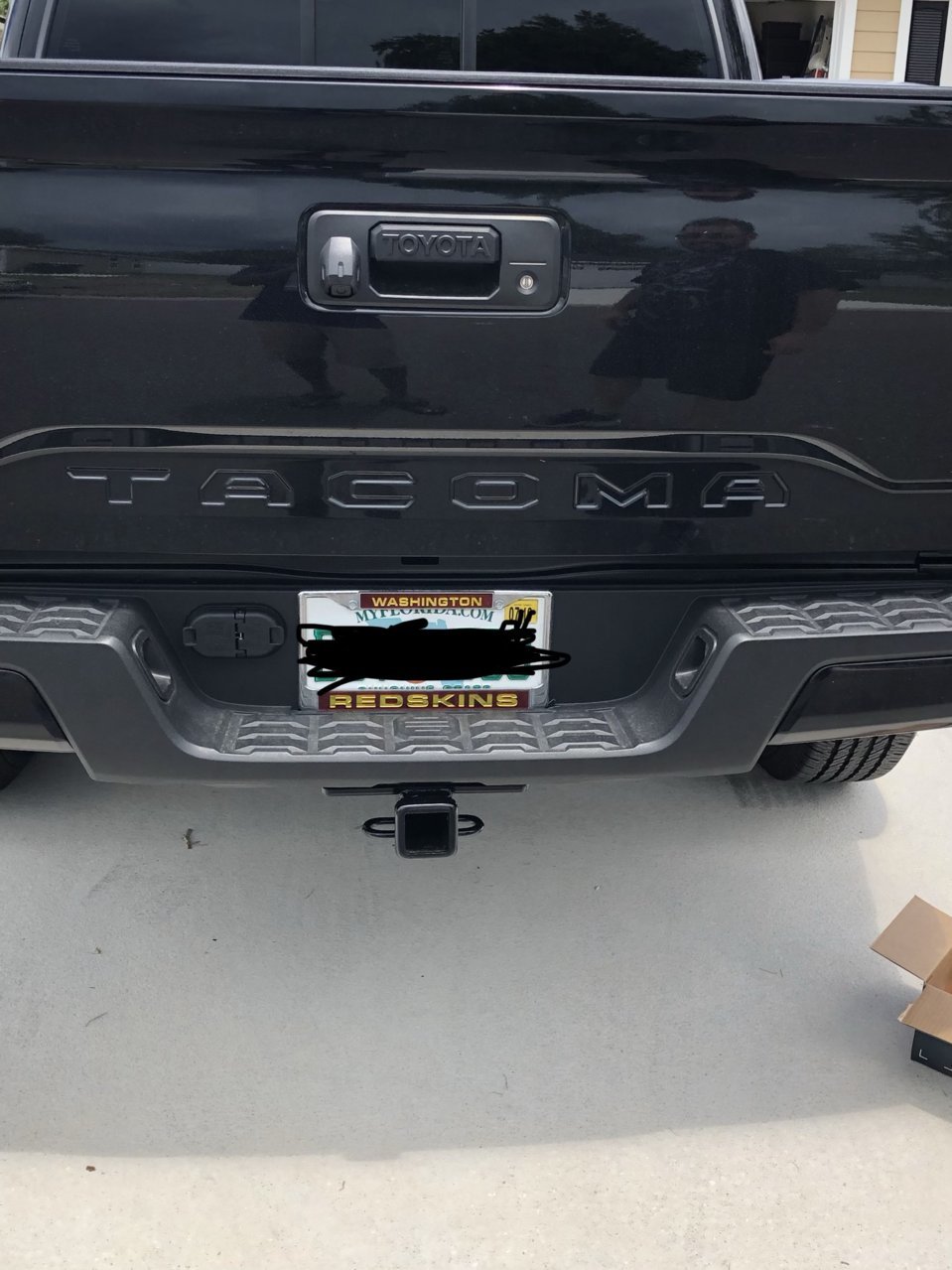

    I fixed it. Here’s what i got. I went by the manual for the wire connections. So far so good! Thanks for the help. 596CE826-E0FA-4CDA-B80C-6B9CAC2B098D.jpgD87CA8DC-71BB-492C-9503-918AEA63ACFB.jpg526E639B-232F-4A62-9FB4-A325FAE117B9.jpg7825C0D9-624F-485D-8929-EA6B485B17B2.jpg7498B318-F68F-4956-8247-067671FE2074.jpg

    Looks good! Nice job :thumbsup:
