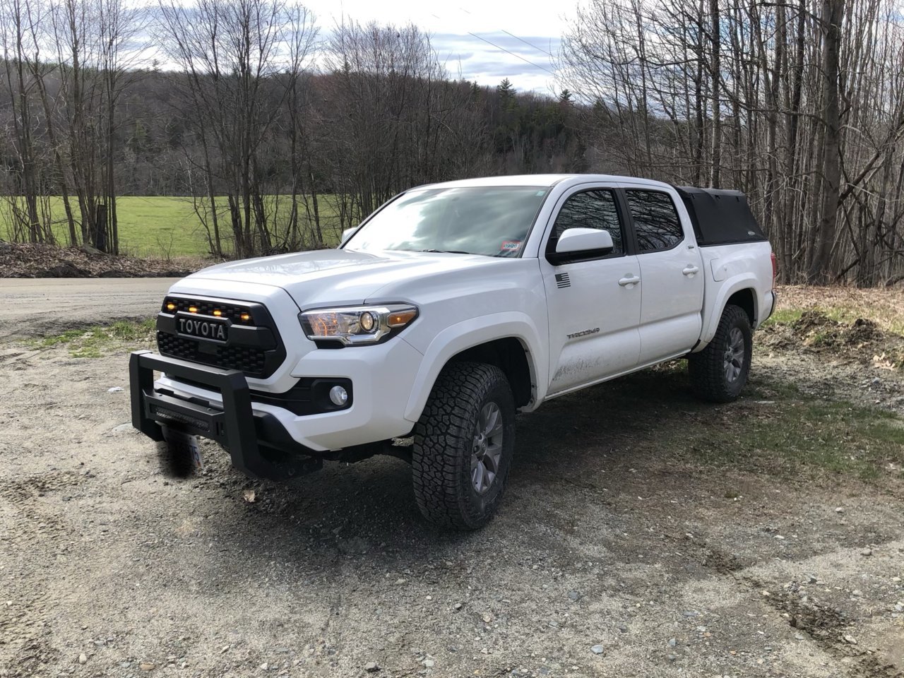

    Have them on mine. Some places like Costco won’t install non OEM recommended tires according to some members here. I have 265/75/16 on stock sr5 rims no funny anything just much better looking. You’ll be fine.
    Taco_mike73 likes this.

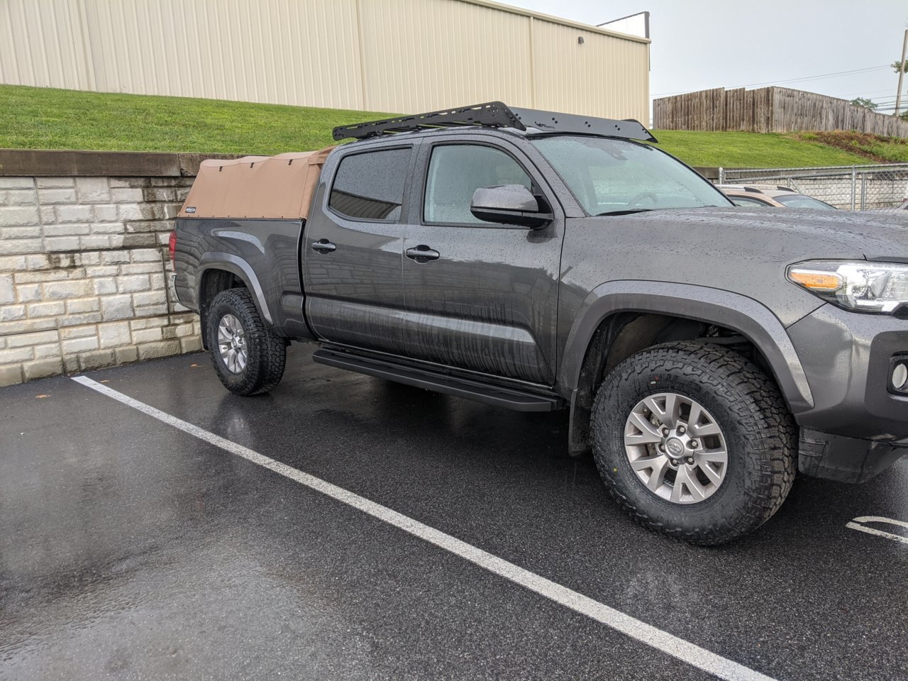

    Cavalry Blue 2019 DCSB SR5 4x4
    You'll be fine with 265/75-16s on SR5 wheels. Here's mine.
    Stock suspension, no rubbing.
    SmoPo16, RepoMarket and Taco_mike73 like this.
