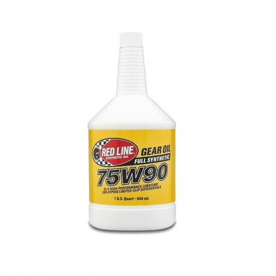

    To answer your original question, yes Redline 75W90 is good and one of the only Group V poly ester pure synthetics on the market including Amsoil and Motul.
    Along with their MTL for the man trans I use it at 100k OCI. It’s highly recommended by the internet’s authority on oil
    https://www.bobistheoilguy.com/forums/ubbthreads.php?ubb=cfrm
    You can use 75W90 or 75W85 which is for CAFE standards, just like 0W20 for engine oil when other countries are spec 0W30 and 5W30 for the same 3.5L

    But mainly concerned is there is two types of gl-5 which is has friction modifier and has nothing.. dont want to get the wrong one

    The friction modifier is for a limited-slip differential. You don’t need it, but it won’t hurt anything if you use a gear oil that has it.
