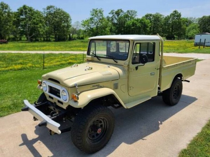

    I was glad to hear your truck was covered (finally) and then you can make the choice to stay in it or do something else.
    Every manufacturer has their problem children. Right now, I wouldn’t even know what truck to buy today in this segment. Seriously. I probably would import something like this:
    Would I buy a 3rd Gen Tacoma with the 3.5? No. I’ve owned three first gens (2 were NA, one was SC), two limited 4Runners, one 2nd Gen Tacoma. I never had any major issues with any of these vehicles.

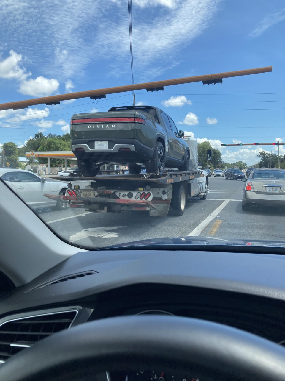

    Hope this makes you feel better.
    In a parade of a few other flat beds with all crashed up cars.
