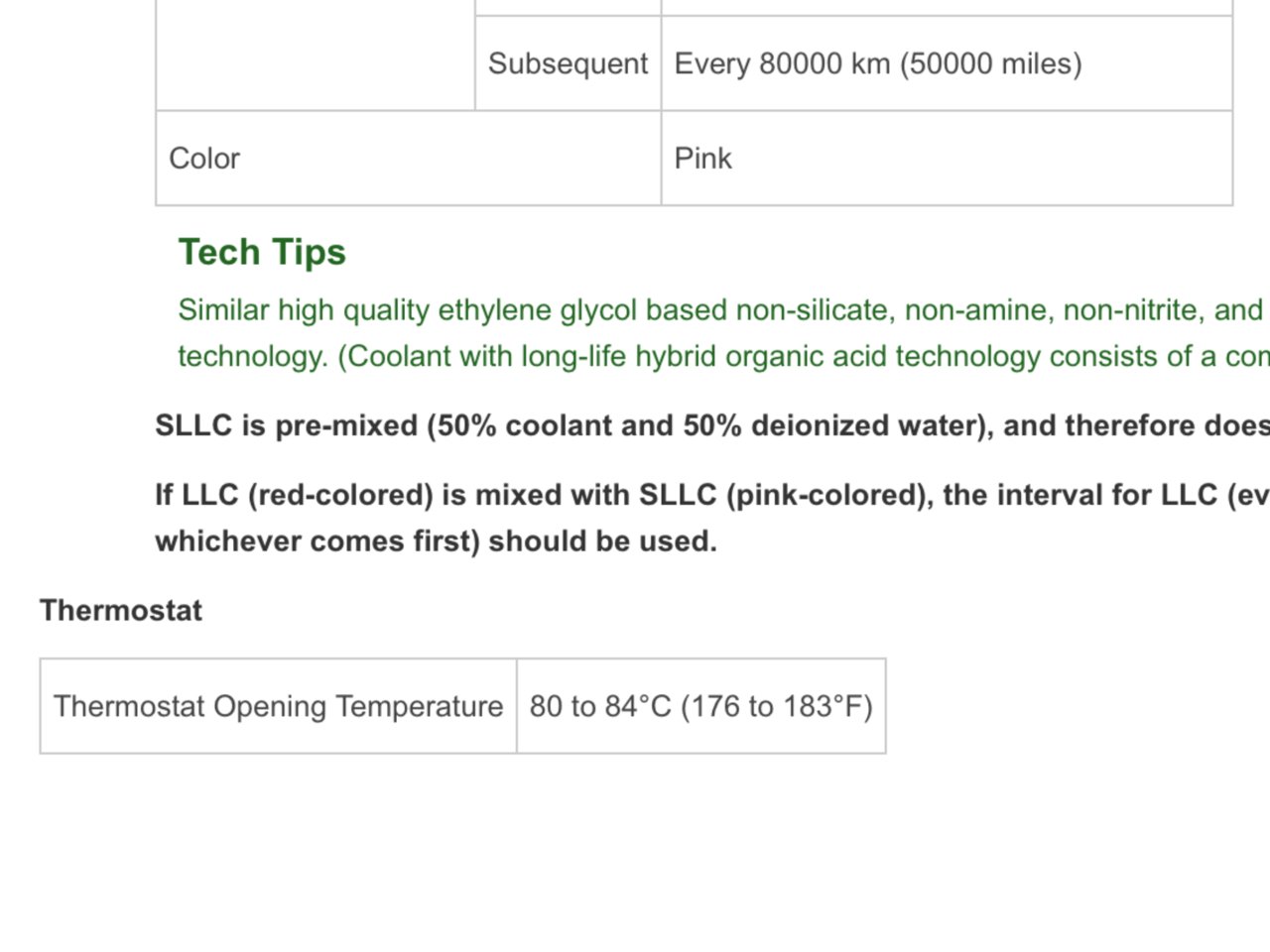

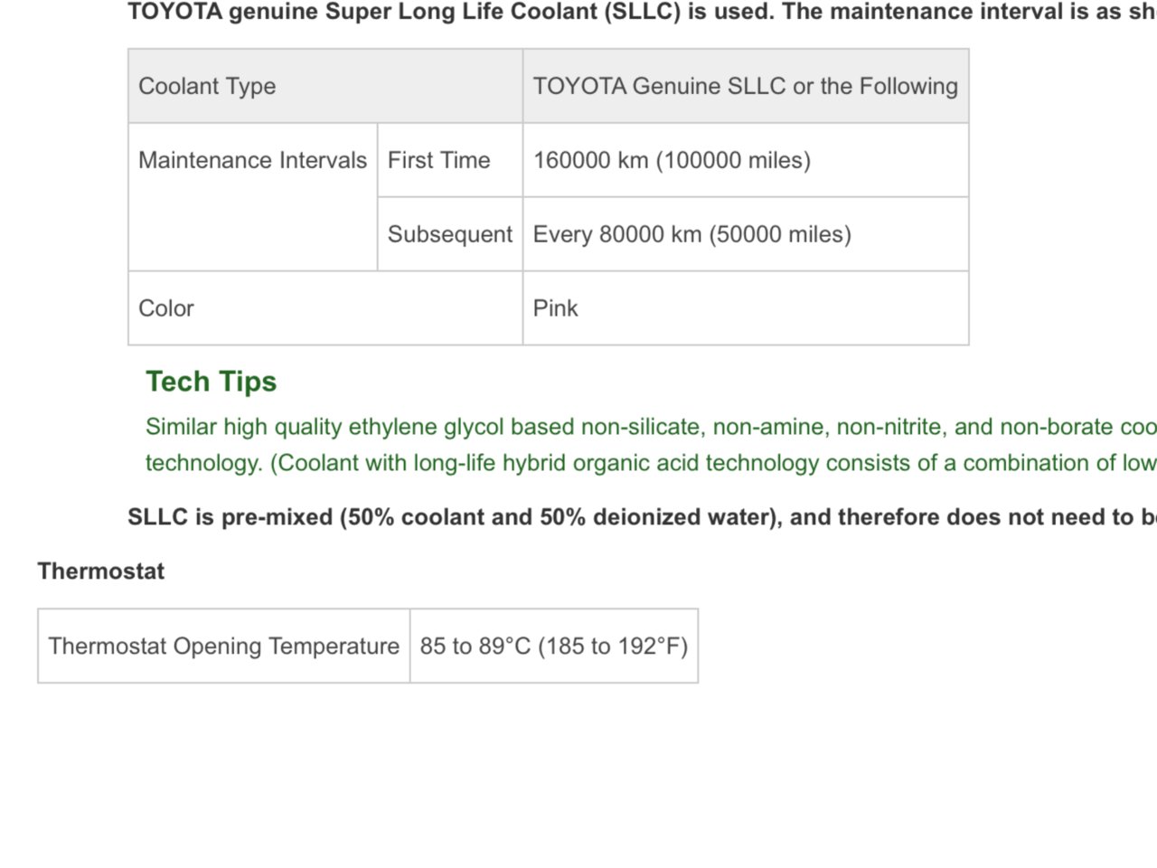

    How would running it hotter increase mpgs and/or meet CAFE requirements? Do the 3.5s usually run in the 200s?
    I’d hope the engineers would’ve designed the engine to withstand whatever operating temps they were going for, but I’m fascinated by this theory.

    No cooler thermostat is available. It's a funky design.
    The hotter coolant raises the temperature of the oil, reducing friction. That is right from the Toyota literature. Add the the hot DI lean burn and we have exhaust valve issues. Again, best guess... could be wrong.
    2GR-FKS
    Regular Toyota cold engine t-stat.

    I don't think 10 degrees warmer in coolant temp is going to burn a valve. The lean DI I'm sure doesn't help with temps. My opinion is something is causing these valves to hang open and that's what's burning them. But at this point we're all just guessing.

    192 degrees really isn't that hot for a modern engine.

    Plus the thermostat has nothing to do with the top temperature a motor runs at. A 180 degree thermostat just opens earlier than a 190 degree thermostat. Your motor could hypothetically operate at 1,000 degrees with a 192 degree thermostat. The thermostat just controls when the coolant starts flowing vs. Staying static so the motor can warm up.

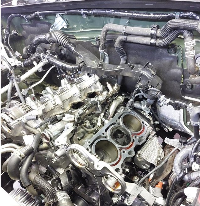

    16K miles Gentlemen! Start saving those pennies!

    Did they cover OPs repairs? I couldn’t find that in the posts, but I’m not very patient :)
    They didn’t cover my 2020 at 65k miles but I had extended warranty, so I can see how they may treat someone without additional warranty differently (maybe they consider mine covered and not as big a deal).. i am still annoyed with Toyota in how they handled it, but I can see their side from an immediate business stand point. Just makes me less likely to do any future business with them. Trouble is that Ford, GM, or Chrysler do exactly the same shit and have terrible failures as well..

    Looks like you have a crack in the same exact spot as a few others? @Taco Tyrant

    Lenoir NC.
    2020 Army Green TRD PRO - 2023 Genesis GV70
    Stock FOX 275/65/18 At3w 18X9 Fuel Vapor's
    Nope. No crack. Bad cylinder head.
