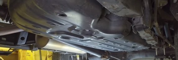

    Welcome to Tacoma world. Sorry about your troubles. I've been here awhile and I don't recall any threads about punctured gas tanks. I suggest you pick up a metal gas tank skid plate at the many reputable vendors we have. I've only had TRD models and as far as I know, they have a plastic skid pictured below. As far as the recalls, the dealerships are obligated to remedy the recalls by law.

    The OR and PRO both come with gas tank skids, the SR, SR5, and Sport don't. I'm unsure about the Limited trim.
    I had a gouge in my SR5's tank after a mild trail, so I picked up a gas tank skid from RCI. It was cheap (I think something like $150 shipped on sale). You will also have to buy the gas tank hangers from an OR package to have the mounting bolts on the bottom of the tank, these are what I used: https://www.amazon.com/gp/product/B00CPVC2M6
    Don't consider it a manufacturer defect; most cars don't have gas tank skids, and you just got unlucky from road debris hitting it. It's not a common failure.

    My OR has a flimsy-ish OEM skidplate. I think it's plastic, if I recall correctly. It's on my list of things to replace... Eventually I'll extend the skid plates all the way to the fuel tank.
    It's right there at the bottom (Fuel Tank Protector) of this diagram ^^^
