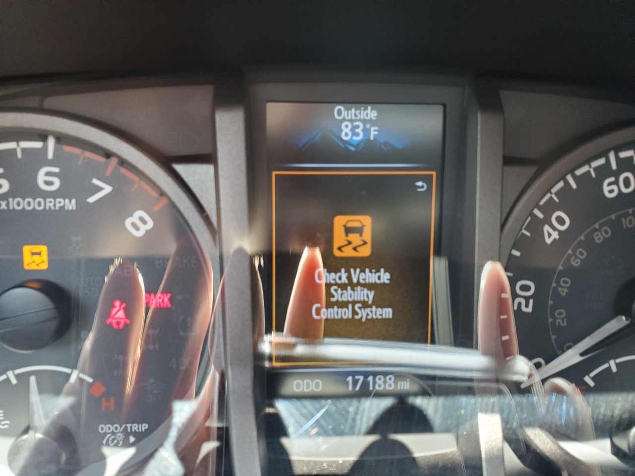

    After doing a 3" suspension lift on my '18 TRD Off-Road the TSS system, specifically the Pre-Collision System and Stability Control System are all bugged out with errors. I have gone into settings and turned off the PCS system but the malfunction error in the photograph pops right back up. I have found no way to turn this warning off.
    Now I have contacted a dealer about this and was met with a borderline confrontational service rep who was saying "There is absolutely nothing that can be done if you lift that truck, and we refuse to touch it."
    After doing some research I found that it is a simple recalibration that can be done in Toyota service locations but its liability issue. Toyota seems adamant that they don't want to recalibrate a system that deals with automatic braking and speed control. Some people say in forums that Toyota was willing to do a recalibration but most shops are staying away from it.
    I am reading some posts about lifted '18s that have had no issue, I am not sure why mine is affected but here I am. A common recommendation I see is to install the TRD Pro grill where the sensor sits 2" lower. I am thinking this will work but I figure the system is going to need to be reset somehow. Or, best case, when it turns on and the sensor registers that it is sitting much lower, everything will be fine.
    I am hoping someone out there has run into this same issue and found some kind of workaround. Most recommendations I see say to just get 2017 before Toyota added this TSS nonsense but that won't exactly work for my situation given I already have the truck and the lift.
    Any help or recommendations would be GREATLY appreciated.

    After going to the stealership, the fix was a "Zero Point Reset". Ran me about $125. Hopefully, the lifting shop will reimburse me, as it was an alignment issue and not a TSS sensor issue like I feared. I will blast this across the forums in the hopes I can help someone else with issues with lifting a 2018+ Tacoma with TSS package. From my service history from Toyota.com:
    THE VEHICLE SETTING CODES FOR THE YAW RATE SENSOR BEING OFF. CLEARED CODES AND PERFORMED ZERO POINT CALIBRATION ON YAW RATE SENSOR
    As for all my research about throwing off TSS sensors when lifting a truck here is what I have found:
    • A 3" lift will not throw off the TSS sensors
    • If you get PCC and Stability Control Errors all you need is a zero point calibration (most lift shops can do this)
    Important note: 2018 Tacoma's have had a recall on the front TSS senor for it being susceptible to water damage. If your truck is lifted, they will not perform the manufacture recall repair. Your only option through the dealership is to. Disable Pre-Collision Control and Adaptive Cruise Control if trying to fix your front TSS sensor on a lifted 2018 Tacoma. Since my TSS sensor was still working, I opted to not have them turn it off, though if it does get water damage, the dealership will not repair it due to liability reasons. From what I understand it is a very simple bandaid fix with some caulking around the sensor wires which I will probably research how to do myself.

    *******UPDATE********
    I feel you, the TSS is nothing but headaches. However, I do have some good news for you. I was in the same boat and had a lift done Friday and had to sit around all weekend with the VSS and TSS warning messages while fearing that the dealership wouldn't touch it due to safety reasons. But I can answer your questions and provide some tips to get it fixed:
    1. The lift threw off the alignment, the same errors your seeing is very common when people hit potholes or rocks as well. MOST alignment shops can get that fixed. Especially if they are familiar with Toyotas because it is a Tacoma centric issue.
    2. Most dealers I spoke with will not recalibrate the TSS sensor due to safety concerns, they don't want to be held accountable for a system that deals with automatic braking. So if the alignment shop cant fixes the errors, take it to a dealership and DONT MENTION THE LIFT. I told the dealership I hit a pothole and the warnings came on as the VSS/TSS combination error is an alignment issue. This way they couldn't blame the lift.
    3. The dealership did not have to recalibrate my lift, they had to do what's known as a "Zero Point Reset". This is something all alignment shops should be familiar with. Best to keep it away from a dealership if possible because they are super opposed to touching lifted Tacoma's for TSS issues.
    Bottom Line Up Front:
    o TSS / VSS combination errors come from missing a "Zero Point Reset" after doing the tire alignment at a lift shop. It should not be an issue with your sensor alignment. Make sure you mention this "Zero Point Reset" at the alignment shop and this should fix the problem. If you have to take it to a dealership, then DO NOT MENTION THE LIFT, say you hit a curb or pothole and these warnings came up, they should fix it for about $100.
    Unfourtantly due to the grill swap and lift, if you run into any issues with your TSS sensor in the future, you will be hard-pressed to find a dealership that is willing to fix it, which is problematic considering ONLY dealerships are equipped to do this calibration. But luckily I do not believe this is the case with your truck.
    Worst case scenario the dealership can disable the Automatic Braking and Adaptive cruise control and disable the warning message from popping up. If I ever have an issue with the sensor I figure this is going to be my only option, I hope my senor holds out but we will see. I really like adaptive cruise control.
    Best of luck man! If you have any other questions let me know.
