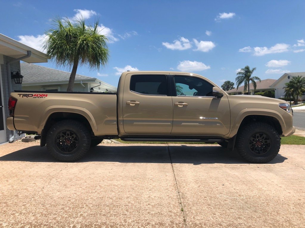

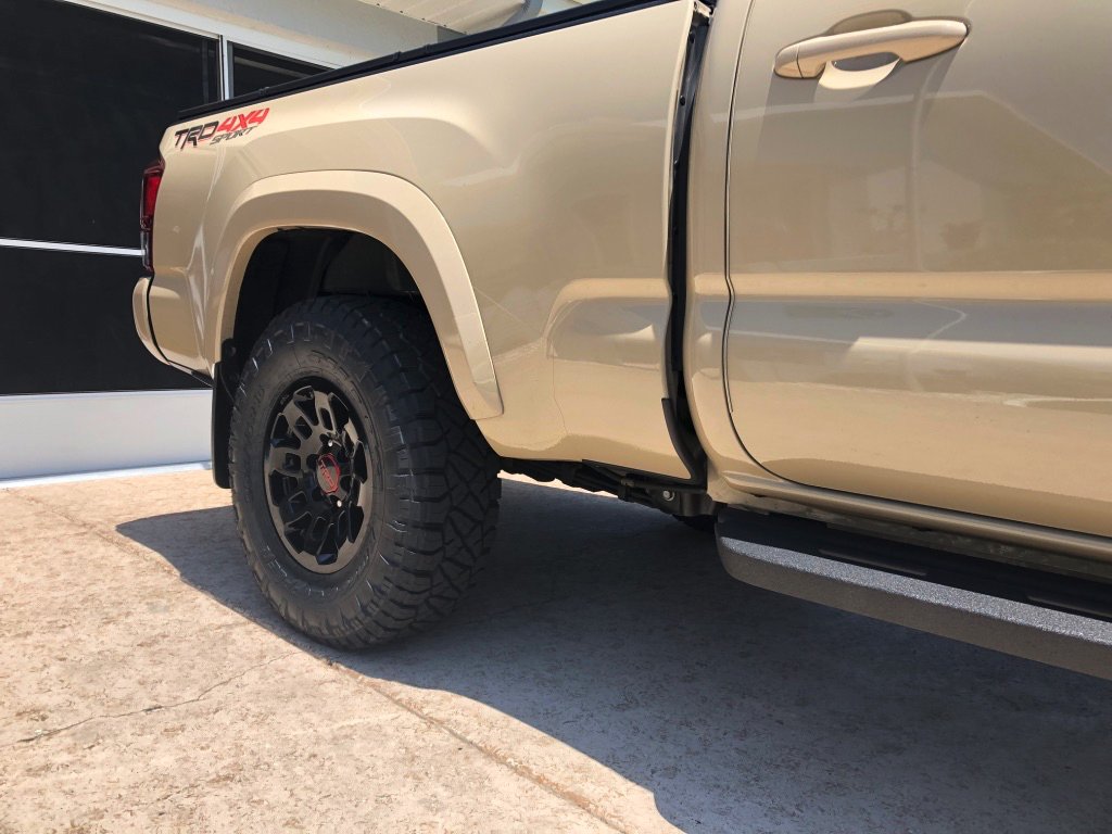

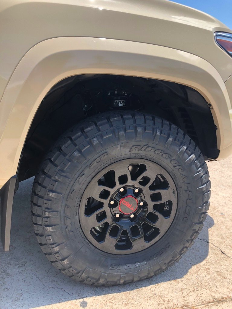

    I ended up doing the 2.0 FOX struts for the front. Install was very easy. I have not done rears yet but didn't care because it wont affect height, still deciding on those. Had my TRD PRO wheels and 265/75/16 Ridge Grapplers installed today. Here is the final product.

    Thank you. So I am never good at describing things but everything feels good. Just the fact that it leveled it out was worth it IMO. With the tires it feels like it shimmies a little bit up front on the highway (maybe because of the more aggressive tread?) but nothing bad like I feel like I have to white knuckle the steering where. Mind you I have never had a truck with anything more than a standard tire. Also, like others have said virtually no road noise from the Nittos. And for the struts, obviously it leveled it up front and not sure but it feels a little softer I think, which is nice. Overall I am very very happy! If anyone is ever in the Tampa area you are more than welcome to meet up and check it out and take it for a ride.
