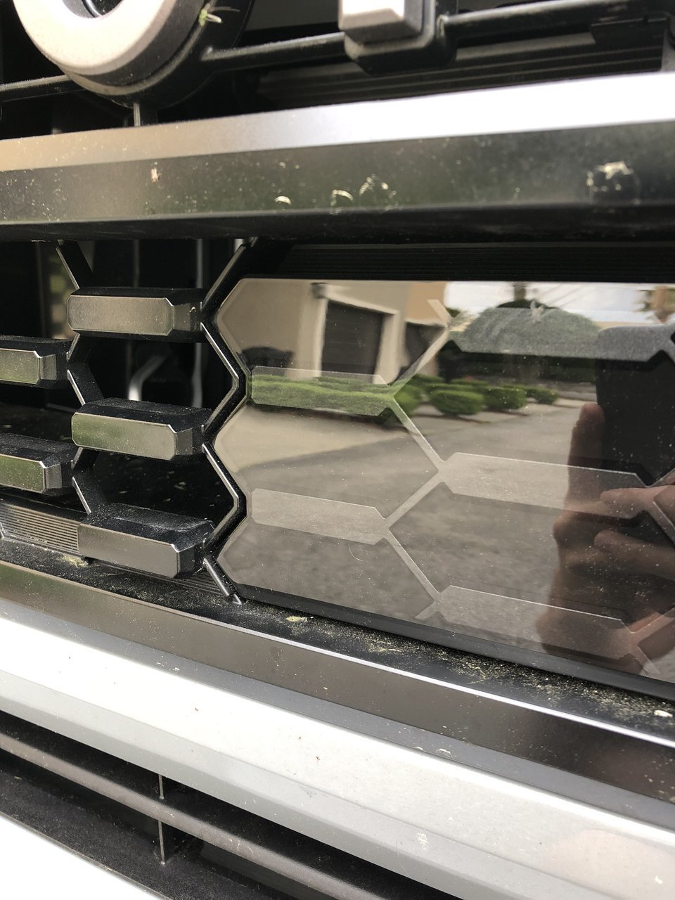

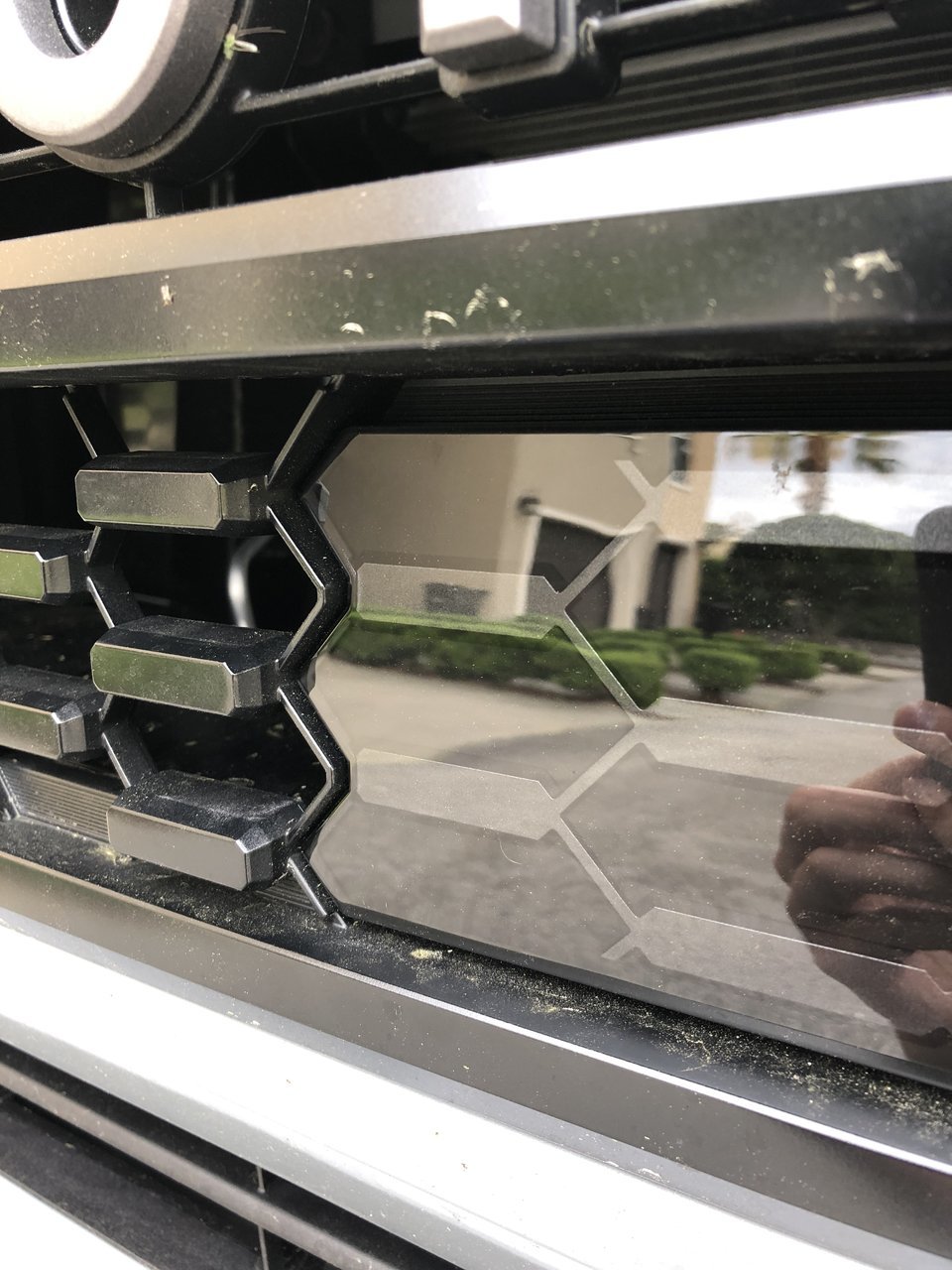

    I have an ‘18 OR with the TSS and swapped the Grille out at my local Toyota Dealer to the OEM TRD Pro Grille for the ‘18s. I had the Grille installed by Toyota about a week ago and it has the cutout for the TSS, the Grille garnish plate was on backorder but came in yesterday. It seemed like a pretty straight forward install (snaps into Grille) so without much thought I just popped it in. The problem is that the upper portion of the garnish is loose. It is not in danger of falling out but it definitely moves back and forth while driving. I’m wondering if anyone else is having this issue? Or if anyone took their time while snapping it on and can let me know if I missed something. I also cannot easily remove the garnish, I haven’t forced it much because I’d rather not break it. The top releases fairly easily but the bottom will not
    It is a little difficult to see but if you look closely at the top portion of the garnish you can see it is slanted inward here
    image.jpgBelow it is in its normal position flush with the bottom and with the Grille
    It moves freely between those two positions

    I just installed my grille today. The OEM garnish was pre-installed. The top tilts backwards a bit as in your first photo. It is tight as there are two star washers on the back. When the washers are in place and the garnish is tight, the garnish is not "flush" but tilted back at the top. I think this is normal ... The star washers go over the two nubbins that protrude into the grille at the "top"... the bottom of the garnish are "snap in tabs", so there really is no play backward or forward at the bottom. But when the star washers are in place, the top tilts back... at least that is the way it appears on mine. BTW, the TSS works just fine.

    I recently noticed this on my grill, I went to the dealer since they had 3 pros on the lot. All 3 had the garnish tilted like this.
