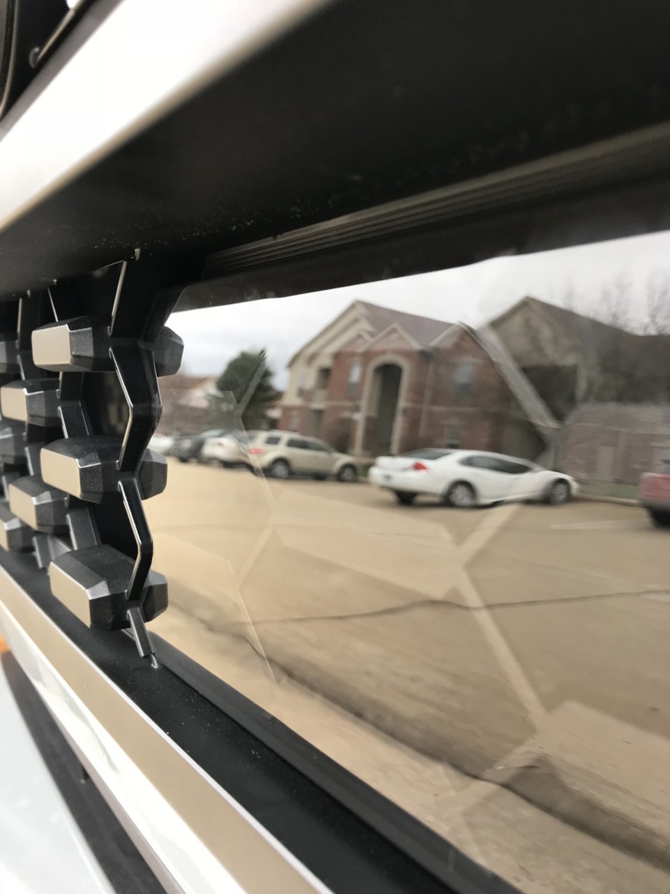

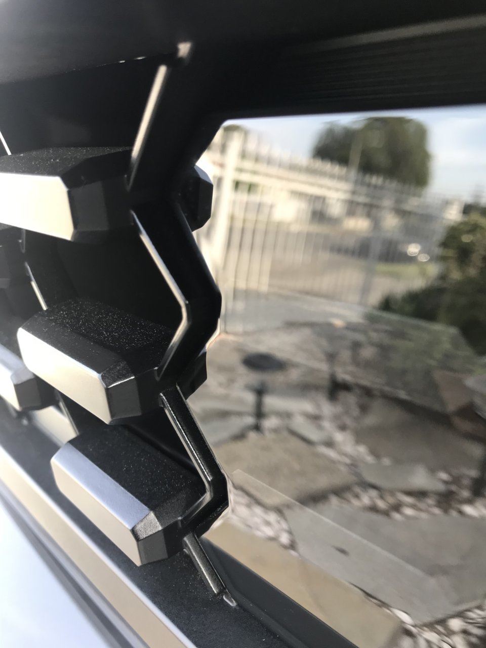

    Does anyone know if there’s suppose to be a slight backwards tilt on the garnish? The grille is OEM. Am I missing something?

    I just put a dab of epoxy, I think it will be easy to Dremel off if I ever need to.
    I don't remember there being one on mine, scared to check now. If no one else does I'll look at lunch.

    Just installed an OEM one today with garnish on my 2018 , used new star washers with a dab of hot glue to make sure garnish was tight and didn't rattle.
    didn't notice any tilt let me go check it out.

    yes mine does as well , just installed it all this morning. Drove about 50 miles today using the cruise control all worked great.
