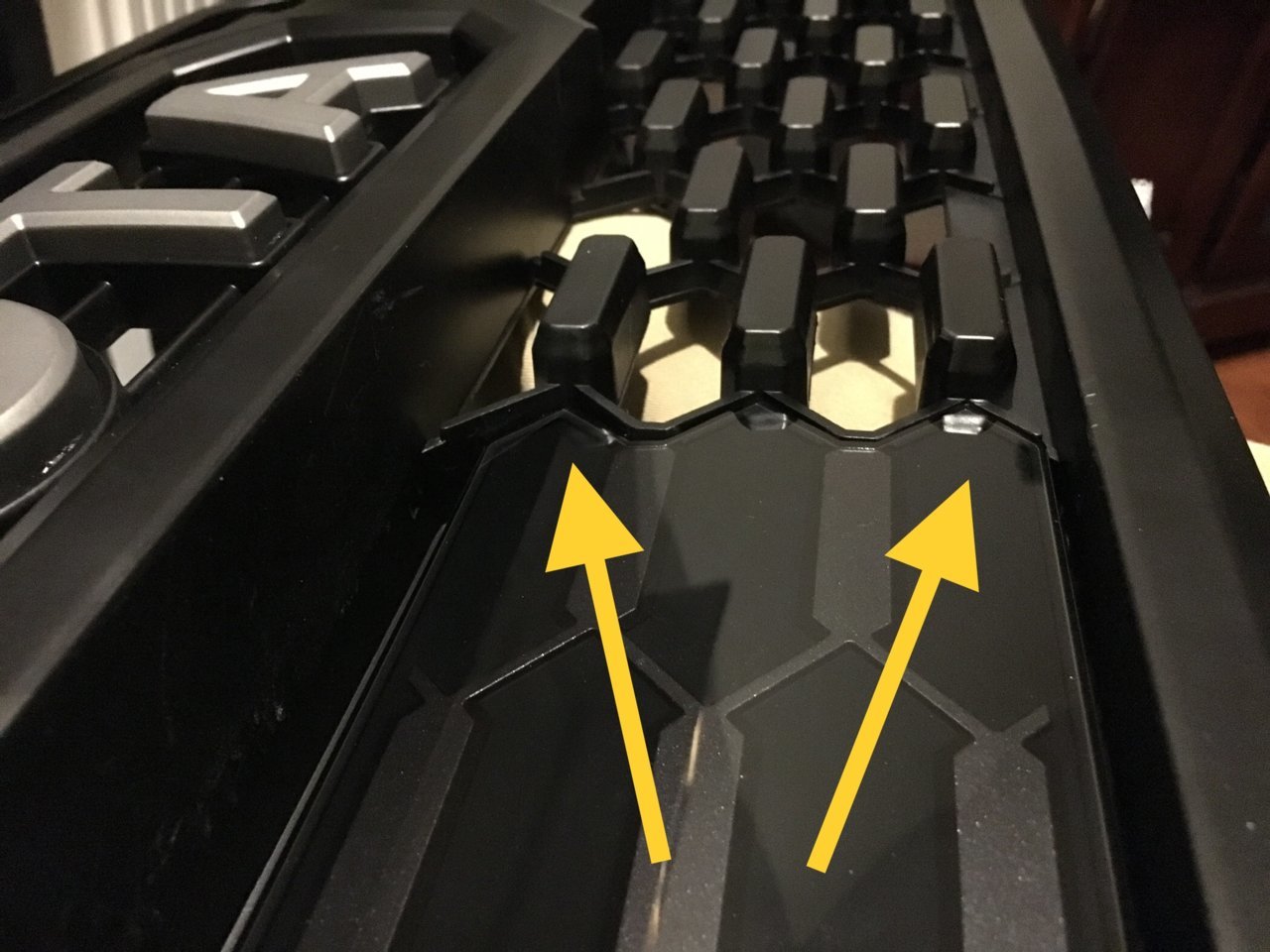

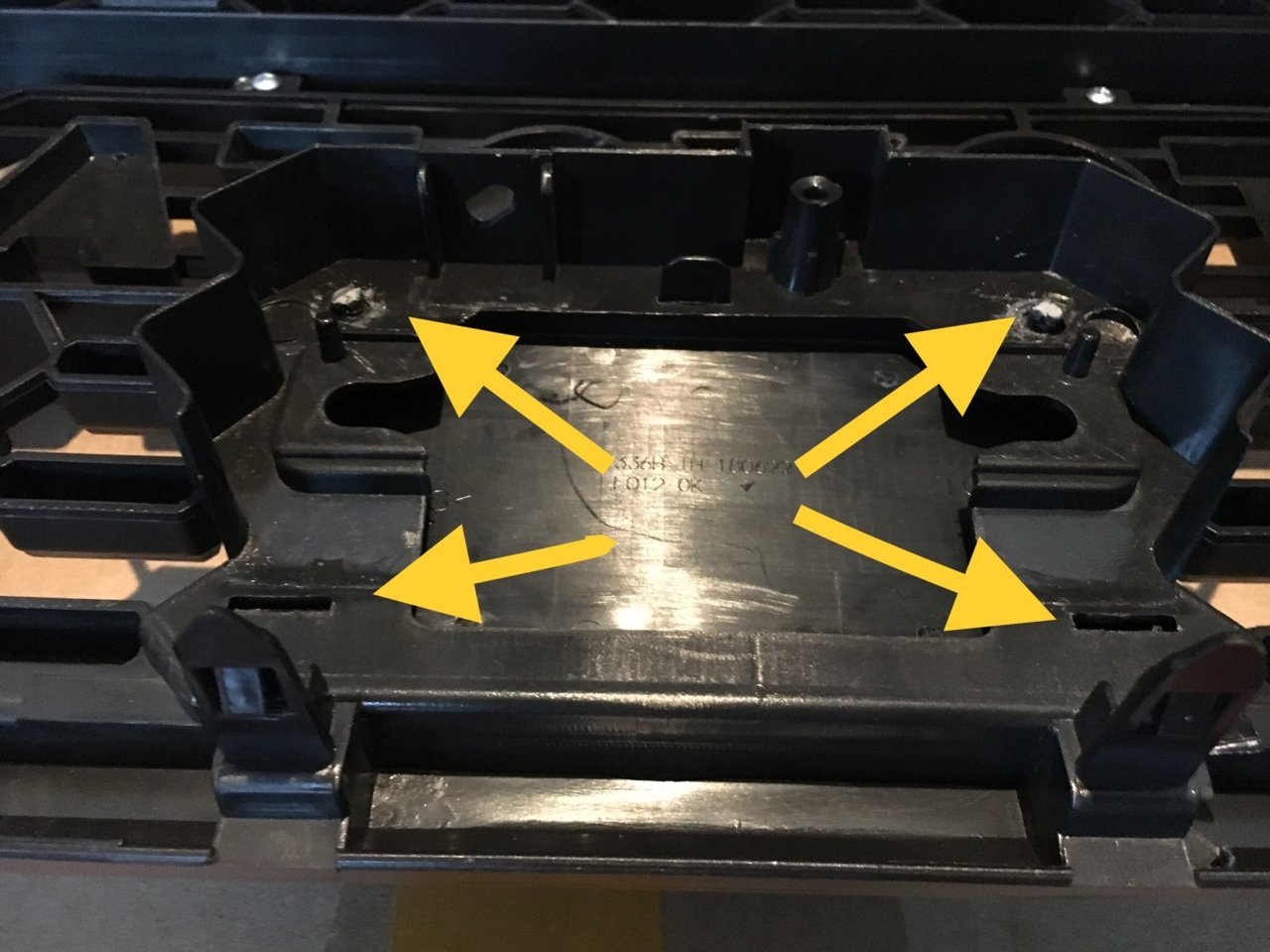

    After much debate, I ordered a Pro grille via Ebay. After installing the garnish, I noticed top of the garnish is not sitting flush, instead it’s rececessed compared to the bottom. I have the lock nut washers holding the studs on the back of the garnish in place, so it’s difficult to make any further adjustments. Anyone else have this experience?

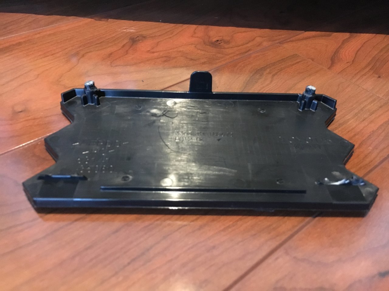

    I should have left the garnish as it was. I tried to maneuver the garnish to get it more flush with the rest of the grille, but ended up breaking the two lower tabs of the garnish. I also broke off the studs at the top of the granish which were held in place by lock nut washes. I’ll probably try to use epoxy to hold the garnish in place. Overall, I’m extremely frustrated.
