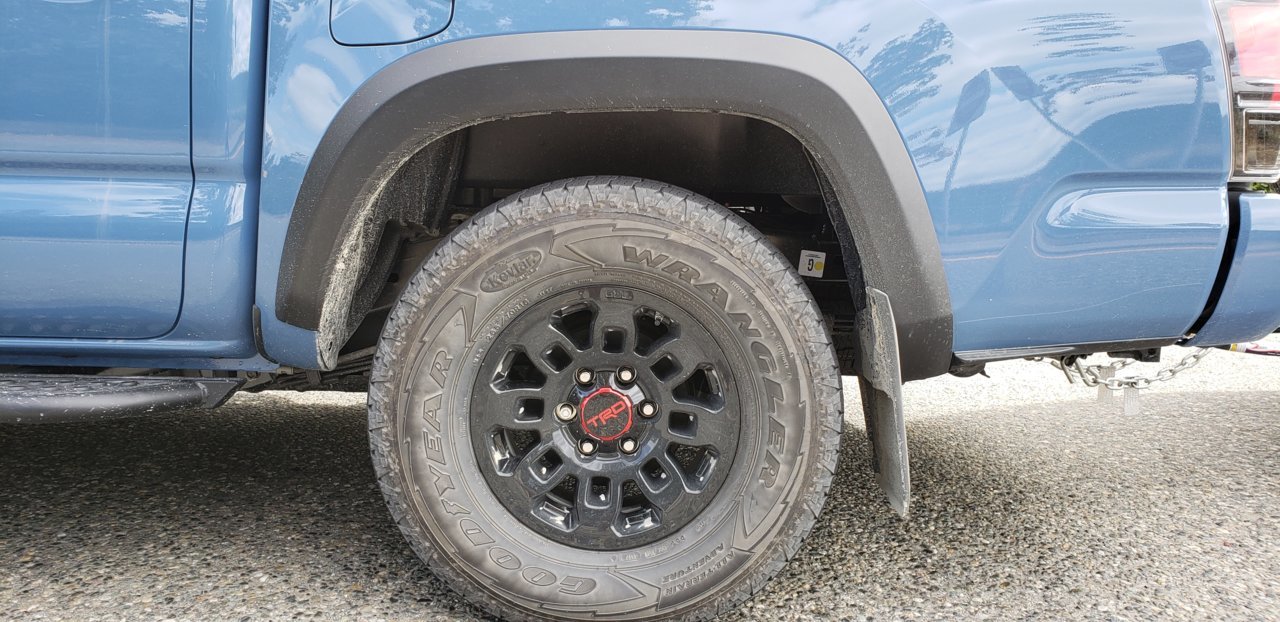

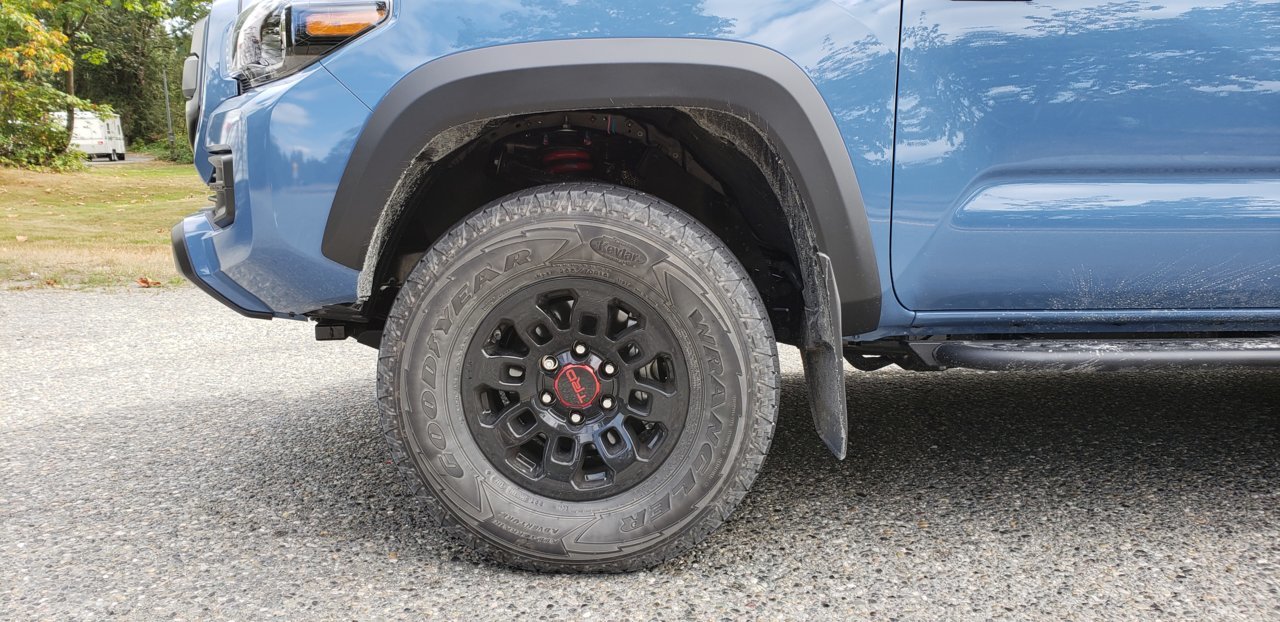

    Hi, new to the site and owning a Tacoma. Just purchased a 2018 Trd pro (manual) and Jayco 154bh baja trailer.... but I have noticed at least 2 to 2.5 inches of sag on the back springs.
    I have a e2 weight distribution hitch installed.
    The trailer is approximately 2600lbs dry and 3300lbs wet.... approximately 500lbs of tongue weight.
    Is this normal to see this amount of sag in the back with an equalizer weight distribution hitch installed? If yes, are airbags my only option level out the truck?
    Do the airbags void any suspension warranty?
    How do airbags change the ride when offroading without trailer attached?
    Thanks and apologise if this question has been asked by a other pro owner.

    @TRD101 - I haul a good amount with my TRD Pro as well, with similar weight on a 14’ tandem trailer. Hauling SxSs, Dirtbikes and whatever else I can cram on there.
    I too am looking into options as I write this. Not wanting to compromise my suspension ride quality I have been looking at the following options:
    - Icon or similar Brand Add-a-leaf progressive springs.
    (This keeps your springs on the truck and adds another set of leafs to cominsate for the load). This is good if you have a constant load, but not so much when you drop the trailer. Rather not as plush as you are used to, due to the fact you have changed your spring rate in rear and kept the same in the front.
    - Air Bag (I am researching this now), but I myself have added gear and a rack, so I am leaning towards a add a leaf or a whole new spring set.
    - A new set of rear springs.
    Icon, Deaver, Alman, and others make a leaf pack that is progressive (which is what’s on there now) that can just straight up handle more weight. These companies also can adjust the amount of leafs used vs thickness.
    I will keep you posted to my findings.
    Search the Forum for TRD Pro suspension. You will find some threads specific to this exact topic. Some of which are helpful discussing options.

    Yup mine sags. Had to lessen the drop on my hitch.

    Sumo SPrings are the easiest and cheapest way to help, i added them to mine and I had 1000 lbs in it a couple weeks back and no sag..

    Id say thats about normal for these trucks with that amount of weight. It shouldnt hurt anything or cause bad handling.
    If you do get an add-a-leaf, or a new leaf pack, be sure too keep the factory overload spring (AAL) or buy a spring pack with overload leaf(s) in them. This is what helps with heavy loads and towing the most, and keeps it the safest as they prevent the springs from going into negative arch with heavy loads (bad for truck and dangerous while driving).

    I'm towing a similar load and also have the e2 hitch. You need to adjust your hitch to reduce sag. Easiest way is to add all 3 washers to the hitch. Consult your owners manual or let me know if you have more specific questions.
