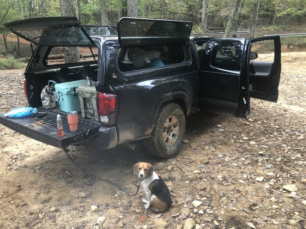

    2019 2.7 4x4. Ditched the little 245s that came on it and put falken 265/75s on it with aluminum wheels. Won’t be going any larger. Truck has an approx 400 pound shell on it that doesn’t hardly ever come off. Frequently tow 1500 pounds. After the tires it now gear hunts pretty bad at 70mph or above. I’ll also be adding full front bumper with winch, skids, and sliders. I was thinking of 4:56s but I’m starting to think that won’t be enough. How about 4:88s? I want to drive at 80mph and be able to stand it without it being at 3k rpms in 5th or 6th (if 6th ever kicks in) gear. Maybe throw a header and catback exhaust on as well to help it breath a lil better ?After all the extra added weight I’m going to lift the front approx 1.5 inches and compensate the back as well with heavy leafs. I love the simplicity of the 4 cylinder and don’t want a 3.5 and don’t want to fork over 40k for a 4R. How farfetched is my plan? Help a brotha out.

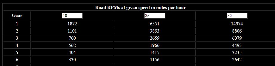

    But if it were me, the only choice would be 5.29's. It's the largest ratio you can get. You have a double overdrive transmission, so you'll be turning about 2650 RPM at 80mph. It give you the option to go to a bigger tire also (which would lower your rpm).

    You’re saying at 80mph the rpms would be 2650 after 5:29s?

    Yup. 2642 RPM to exact.

    Damn.whats that table? I need to be able to use that

    http://www.grimmjeeper.com/gears.html
    It doesn't currently have the gear ratios for your transmission so you need to manually add them at the top of the form.
