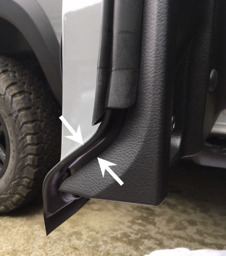

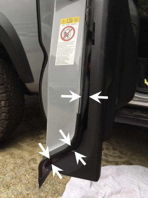

    So I removed my rear passenger interior door panel in order to fix a creaking noise. Like many others I found several of the red "pins" had been crushed during installation. I replaced them and am putting the panel back on. I am having issues with the bottom corner...corner where the seat belt bolt is located...not fitting snug against the door. There remains about a 1/3" gap. See pics with and without weather strip. Is this normal? My drivers side (which I have not removed) fits flush. Can someone please show me a pic of their panel fitment at that location.

    anybody??

    After removal, mine did that too. I was very careful on pulling it off and reseating it until it fit correctly. Something wasn't lining up right.

    That is not normal. Keep working at it.
    I had the same squeak / creak on my left door.
    There is a great video out there on YouTube that shows the removal. You've made it past that part.
    Just be sure that you have all the clips aligned as best that you can.

    Thanks for the replies. I went by the dealership and looked at a truck there...the gap I have is not normal. I'll keep messing with it.

    Well I found out why my panel had a gap. I ran seatbelt to the bolt at bottom of door...on the INSIDE of the panel. Duh!! Amazingly, it all worked fine. I’m gonna see if creak gets better. If not, I now have some experience with the panel, so future on/off will be much easier. Thanks for all the help!

    Ha! That will do it.
