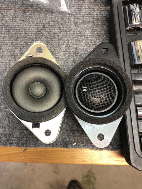

  8. Feb 28, 2020 at 9:08 AM
    CanesFan95
    CanesFan95 Well-Known Member
    Jan 18, 2020
    #316448
    136
    Florida
    Currently Shopping...
    I keep seeing this thing about Subaru tweeters on here and am confused. Isn't Subaru a whole different car brand? Why would people wanna take speakers from some other car brand of all things and put 'em into a Tacoma?

  9. Feb 28, 2020 at 9:53 AM
    dangeroso
    dangeroso Just float along and fill your lungs
    Apr 4, 2018
    #249394
    1,854
    Jon
    Dallas, TX
    2018 Tacoma TRD Sport 4x4
    It's a higher quality version of the same speaker. See below (Stock Tacoma speaker on the left, Subaru on the right):
    BC61442-B-1457-4-F3-F-824-C-F67773-BBC49_5b55bdd6527d7610007d639a63051a401dfe8e21.jpg
    musicisevil likes this.
  10. Feb 28, 2020 at 9:56 AM
    doogiefoognits
    doogiefoognits [OP] New Member
    Feb 27, 2020
    #320525
    3
    Indianapolis, IN
    2019 Tacoma TRD Sport 6MT
    Subaru and Toyota have been sharing parts for a while. Note how a Subaru from the same year as your Tacoma makes the exact same beep noise when you lock/unlock the car.
    Also, on the head unit front, if you've ever been in a 2016-2018 Subaru (I had a WRX) the UI on it is dead up the exact same as the Tacoma.

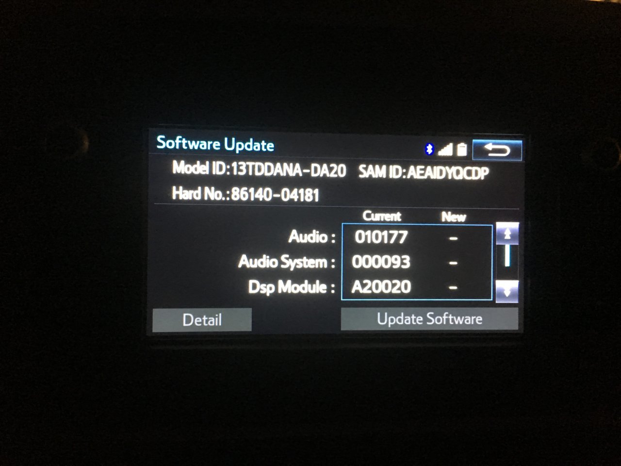

  11. Feb 28, 2020 at 10:01 AM
    Tacoma Mike
    Aug 6, 2011
    #61230
    31,438
    Southern Maine
    What year is your truck and get me the radio number on the faceplate.

  12. Feb 28, 2020 at 10:04 AM
    doogiefoognits
    Feb 27, 2020
    #320525
    3
    Indianapolis, IN
    I'll piggyback off this... I have a 2019 and the radio has 510365 on the front. Any hope?

  14. Feb 28, 2020 at 10:52 AM
    Tacoma Mike
    Aug 6, 2011
    #61230
    31,438
    Southern Maine
    E tune premium 510365 has an update
    Ref:
    TSB 0003-20

  20. Feb 28, 2020 at 4:05 PM
    #20
    bassmusic
    bassmusic Well-Known Member
    Feb 17, 2020
    #319549
    296
    Spicoli
    2019 SR5
    Checked here, don't see anything - doesn't mean dealer might not have something for us but the bluetooth skipping is my main issue I'm having.
