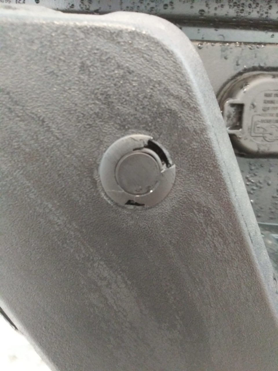

    Hi! Hope someone can help me with a compatible retaining clip that fit to rear sensor OEM 89341-0R060. Some guy hit the rear bumper and clip broke, but clips are not sold separately. Just need the clip, sensor works perfectly.

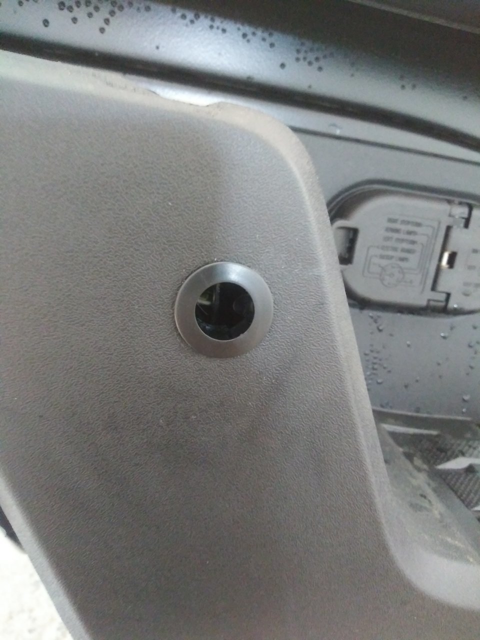

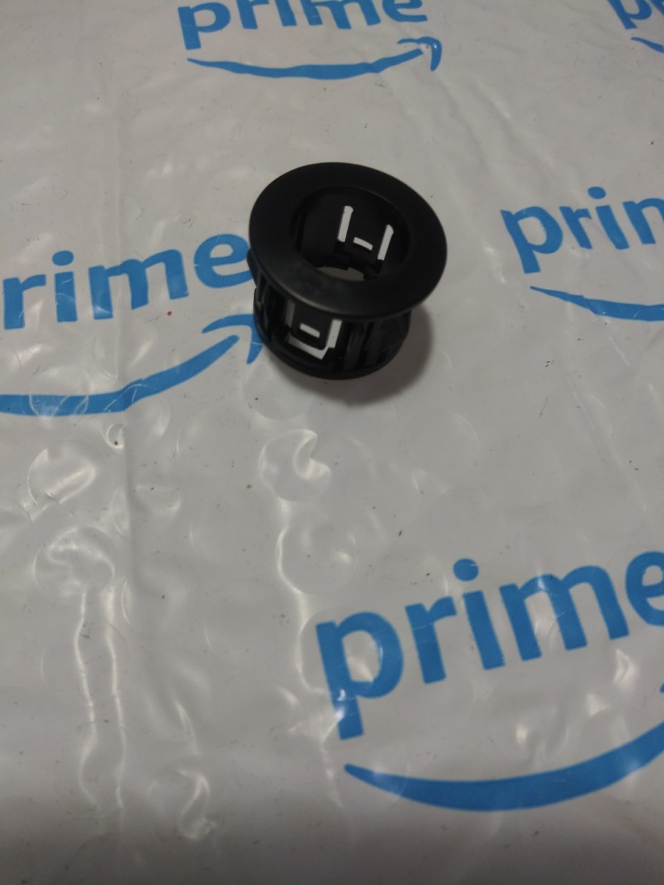

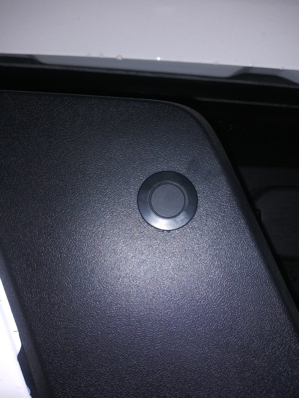

    HI! I got the $18 sensor today from Amazon, and for my surprise the retainer is a perfect fit in color, texture and size. I'm posting pictures, I also did it myself (not bad for a woman) without unmounting rear bumper.

    Awesome! Does it match the other sensors in size (regardless of fit)? What was the process for replacing it?

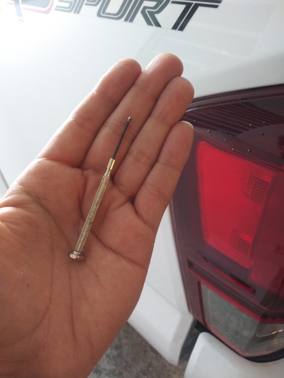

    Thanks for your advice. I did it myself with a small screwdriver and was perfect. 20190313_160646.jpg 20190313_155629.jpg

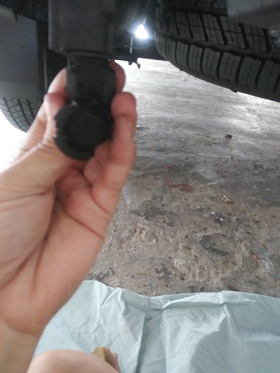

    Yes it did match, by the way the sensor is the original and the retainer is replacement part. I will keep the replacement sensor as emergency backup.
    Process:
    • very small screwdriver to pin out clip from the sensor and some sensitive massages as one user said in the blog.
    • I pushed the sensor inside the bumper, and it drop out easily.
    • then push retainer a bit to the bumper and at the same time put the sensor on the other side.
    And that's all. Very easy steps that takes 15 minutes.

    I didn't unplug the sensor. There's no plenty space in that bumper, I got lucky with small hands.
