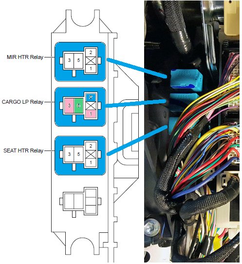

    I am guessing you need a relay. I've read that some come with the relay and some don't. You can easily check this. There is actually a thread for this mod where all the parts are laid out. Sorry I don't remember it. I am sure you can find it.

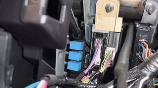

    Hi folks, have same issue, were is that missing relay supposed to be located?
  8. May 23, 2023 at 1:24 PM
    caribe makaira
    caribe makaira Well-Known Member
    Feb 13, 2011
    #51121
    11,748
    Caribbean, Puerto Rico

    But I looked inside and have the 3 relays, the upper cargo light works fine, just the bed light are not working, any idea?

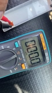

    I measured and have 1v

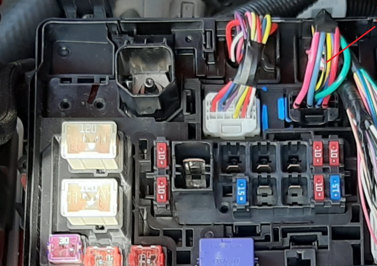

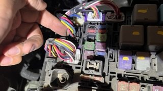

    Your Taco might be missing the wire from the engine bay connector to the cab connector on that Cargo circuit.

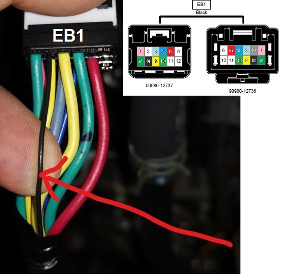

    Look, I found the black wire in the engine bay connector

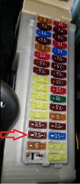

    Ok, did you very the fuse?
    (2017 fuse panel)

    I’ve measured 0.3v at lamp conector

    Place ear near relay area, listen for relay "click" while pressing and releasing door open/closed switch. Do same for on/off on Cargo switch.
