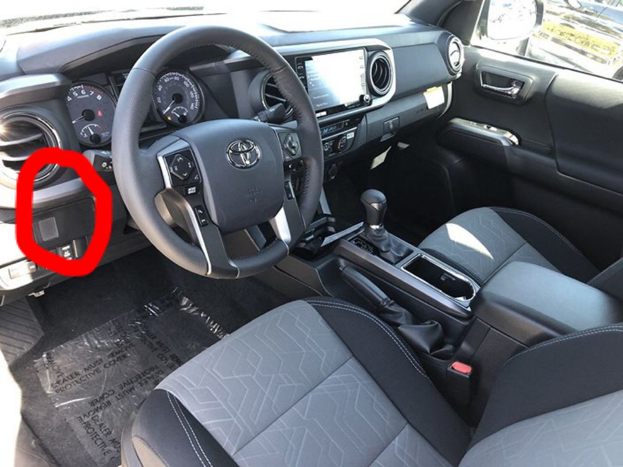

    Looks like there will be a soon released 2020 version anytime camera. Just got a 2020 with everything but the advanced tech package I wasn’t impressed by the camera quality for the $$ and didn’t really need the side cameras. I do however like the option of adding a front camera and rear camera that can be used at any speed. There’s a blank here but I know people with previous year models were losing either their bsm button or parking sensor button...hopeful this blank could be used for the switch but I’m guessing the wiring will need to be extended to allow. Anyone else with a 2020 find another company offering forward facing cameras yet?

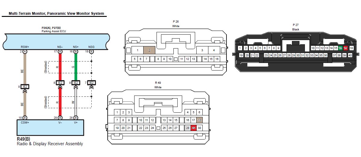

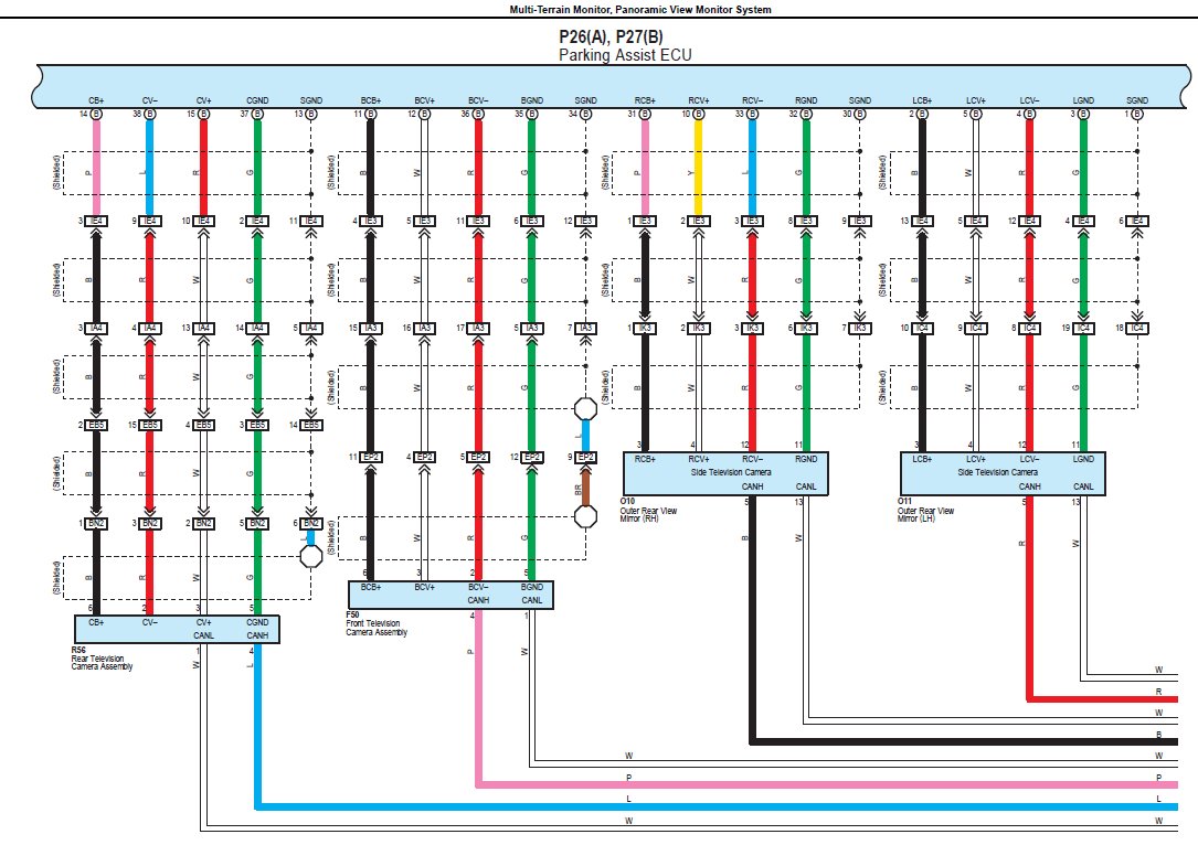

    Damn. Good research, man. So strange that they would do that.

    Easier to replace the camera module (Parking Assist ECU) separate from the Head Unit, which just displays the views selected.
