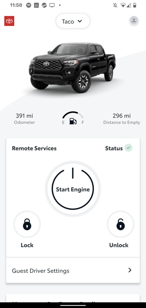

    Here's a pic of it with the app. Alexa works too with a PIN #.Screenshot_20200603-115932.jpg
