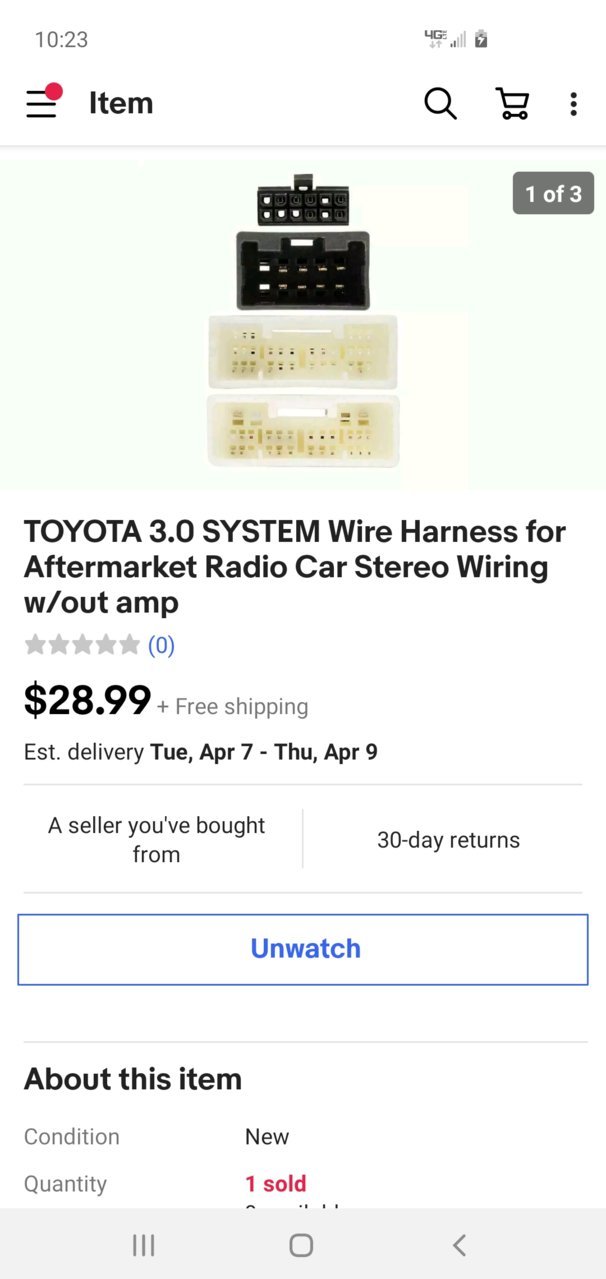

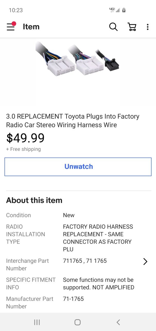

    After finding both of these connectors / harness kits online (just now) through google there they are posted above. Almost ready to pull the trigger on my cart to start the Kicker Key amp upgrade. Good work OP!
    I only need the 2 black male and female connectors with pins for the factory 10 pin connector (R51) on the 2020 head unit.

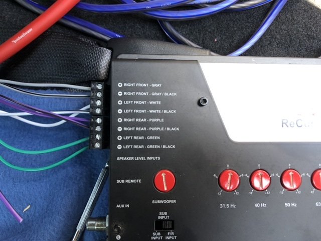

    I just ordered a wire kit for the Recurve / amp system from taco as well. I used the same setup with the recurve in the 2015 I had before. So I'm happy to hear I should hopefully be getting the correct one to redo the process. Now its just a waiting game to see how long it takes to arrive. Estimate was about 10 days.. How long did your order take? Especially with the way things are now.

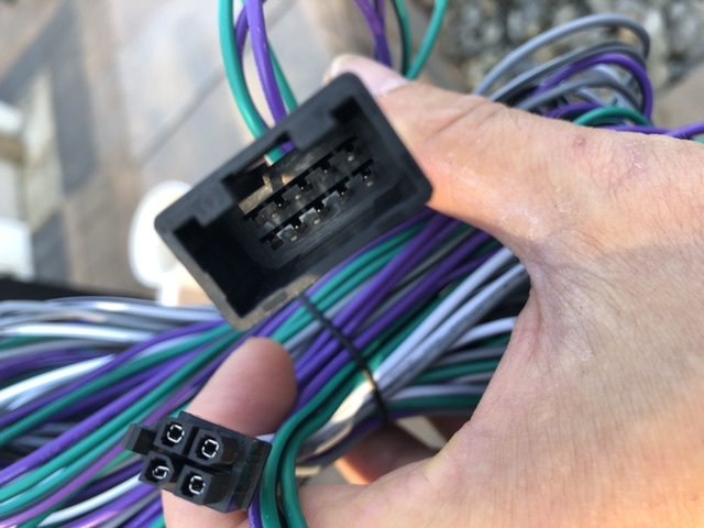

    I received the wiring harness.. The speaker side is correct.. but the other section of harness T tunes sent me just seems to be an extension of the R51 side of things. I have power and ground run to the back. I guess I will have to figure out some sort of remote turn on?

    You mind posting a pic of the full harness they sent you

    @destin_meeks the section of cable is pretty much as the OP showed. The only useful part is the 10 pin which does fit the radio, however it only has the speaker wires. I'll take some photos hopefully today.

    Looks like 2 of the same plug.

    No, the square end is made to plug straight into their in-house amplifier. So it’s getting cut off in your system

    Correct. It’s color coded for the recurve unit

    Just need to hunt for a switched source and then run the remote blue. Also going to run the bass knob somewhere up front while I got the console out .
