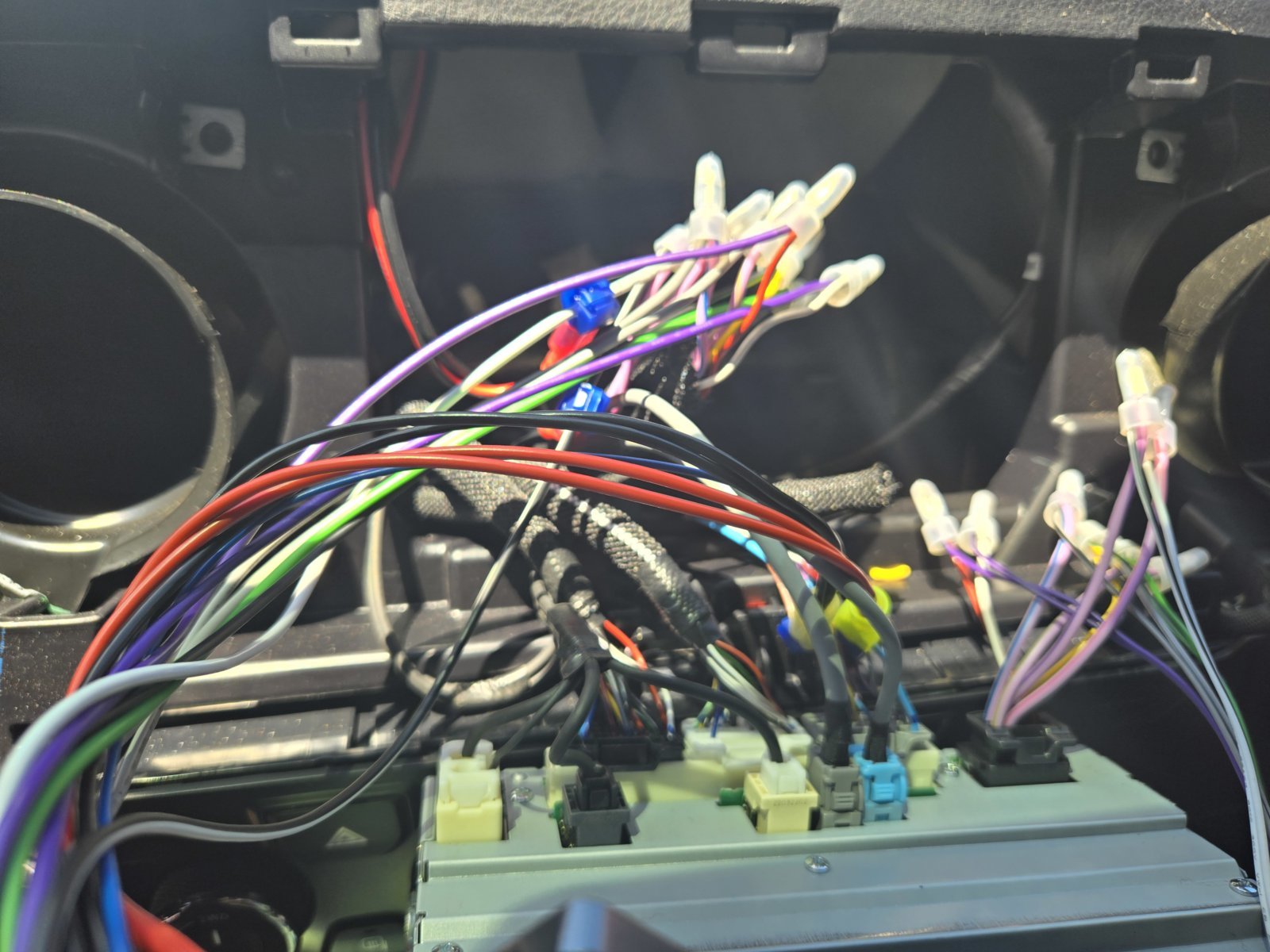

    So after further observation and turning the hideaway completely off, there is nothing coming from the key amp to my speakers. So aggravated about this

    What did they actually do? Four 10mm bolts is all that holds the radio in. Pop that sucker out and post a pic of the wiring they did

    This is what I got, looks like a shit job and they had no idea, didn't even use the red wolf connector I game them by the looks of it

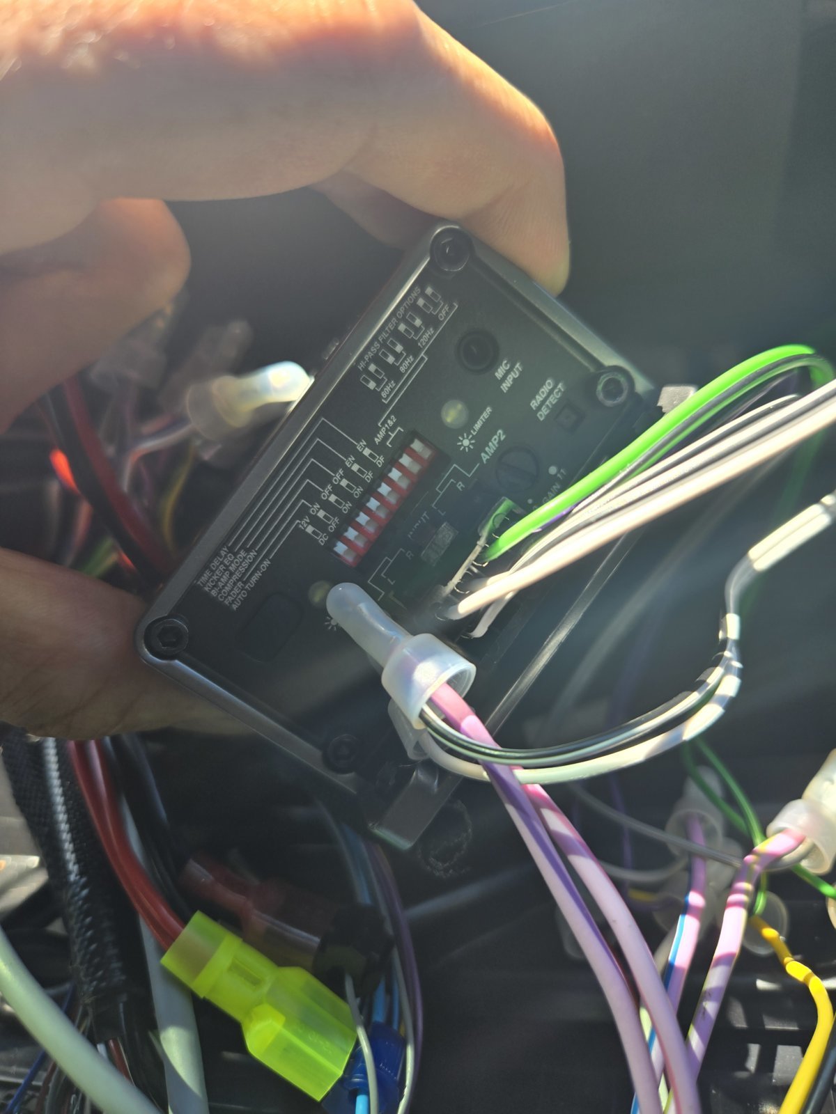

    The dip switches, the mic is gone. Wasn't in the box, isn't hooked up

    They did not use the red wolf harness. They cut your factory wiring right in half
    they also tapped the subwoofer into the key output and not input, and they t-tapped your power and ground
    absolute garbage install and they should be ashamed

    Yeah I'm pissed, it's a freaking mess in there, I should have just did it myself after all the research I did. Buy I figured hey I will just pay the audio shop guys and they can slam it in there no problem and boy isn't that what they did. I feel like they trashed it and yeah it's gonna have to be completely redone, like I said they didn't have the mic in the box or the red wolf harness I supplied them and i specifically said this is to make a t harness so you don't cut into my factory wiring. And then wire ties. Wtf

    Hey Dustin those dip switches are all jacked up too aren't they, like I thought I had power going to the fronts from the amp but I don't think nothing from that amp is working now. When I turned the hideaway off completely. Hell the stereo sounded better before they did all this. I have nothing coming from that amp to drive those speakers I feel. I should have known when they said this was the first one of these they had installed.

    That should have been an immediate red flag. Idk what your setup is but for me, I have kicker cs 6x9s up front and kicker cs 6-3/4 in rear with subi tweeters in A pilllars and my dip switches are DC ON (1st one down position) and all the rest in the up position.
    Make them undo your botched job, make them put it back to factory and get your money back. Try again yourself. It's not that difficult of an install
