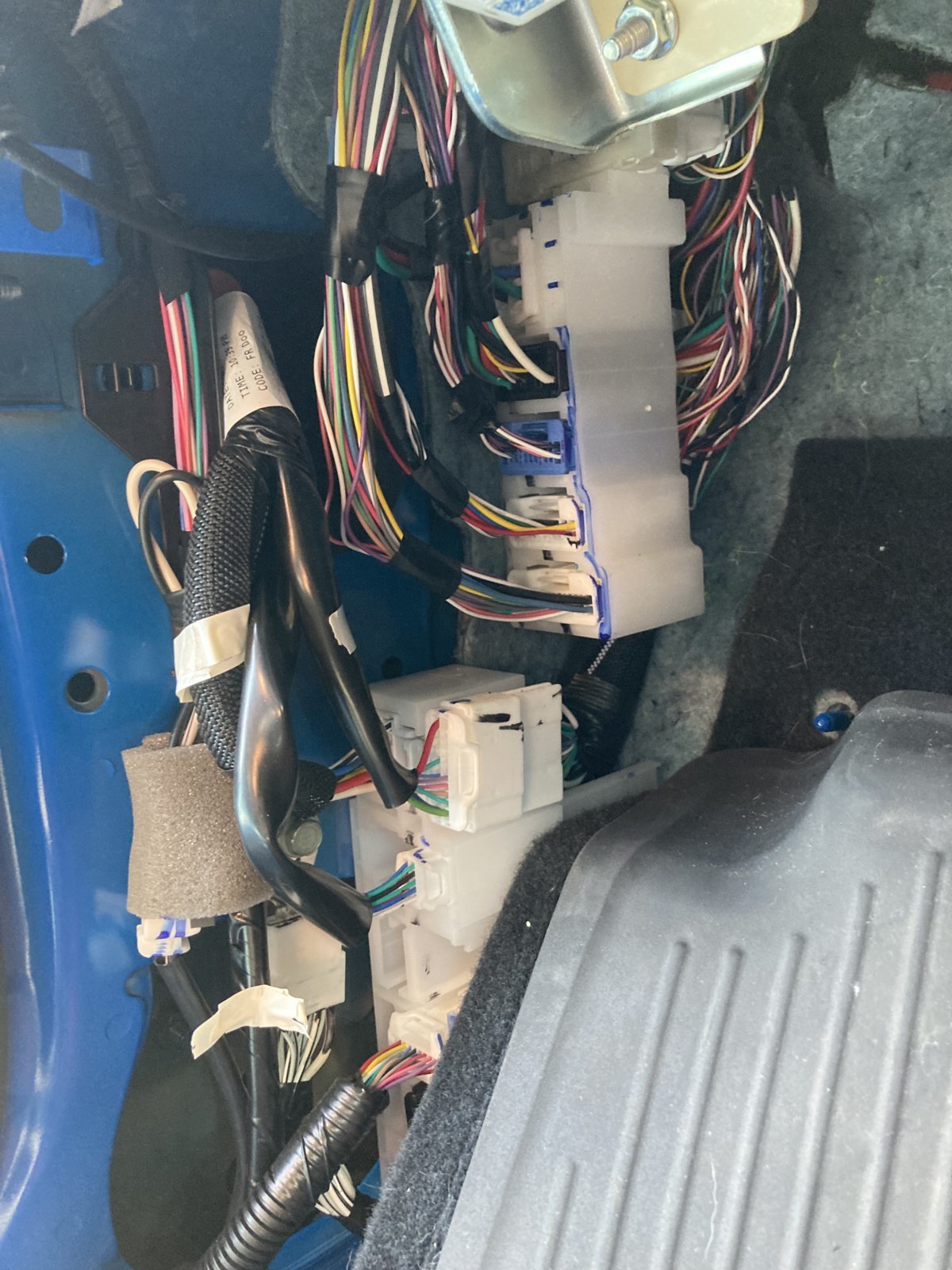

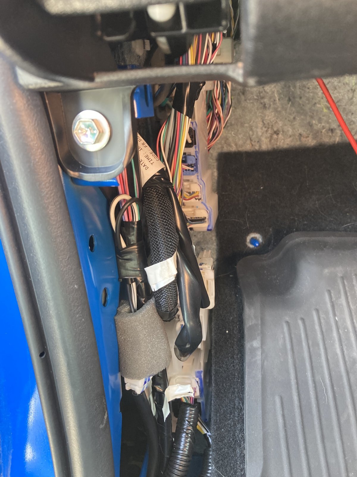

    @destin_meeks, here are a few pics of the area where I would like to have my ground. Is there a bolt in either pic that would be suitable?

    This bolt is a factory ground. If you ever see a bunch of white/black wires, that is Toyotas color for ground wires.
    I believe there is one behind the head unit as well

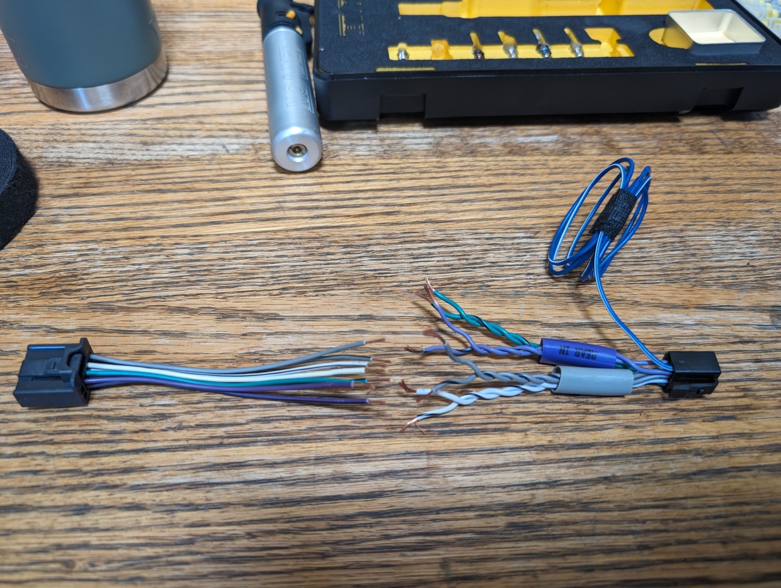

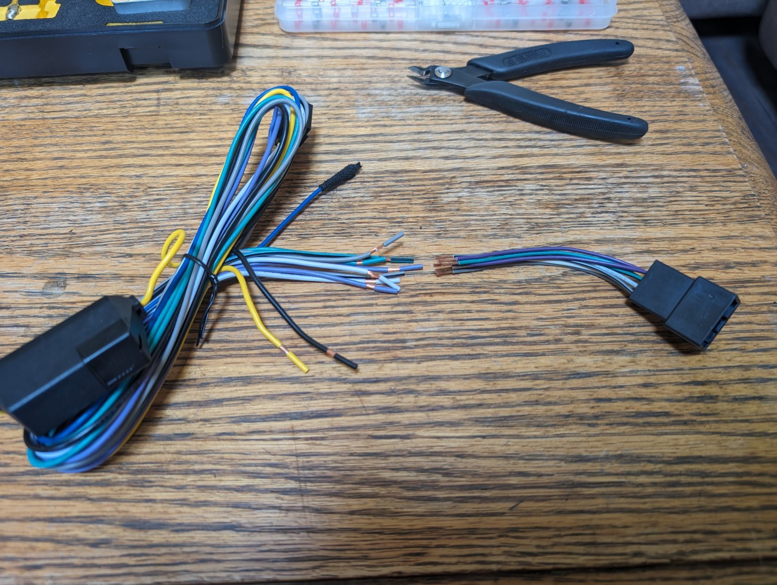

    Can someone tell me if I'm on the right path? I have the Alpine version of the Kicker Key, I've been reading through 3 threads about this. But there is so much information and it's so widely spread. I have a 2023 with the 8" entune hu. I bought the redwolf harness and I'm hoping this is the correct orientation. Blue wires remain unused, yellow and black on the speaker side harness are power and ground respectively, and I have a power kit that will go to the battery and a chassis ground. Other than that, connect colors directly to their counterparts on the other side of the splice (grey to grey, grey/black to grey/black, etc). I'm about to start soldering these, so please let me know if I'm using the wrong harness or my setup seems off.

    Yep, match the colors and you’re all set.
    you may want to consider extending the input side a bit. Those wires are super short and it will be a struggle to get that power pack in there
