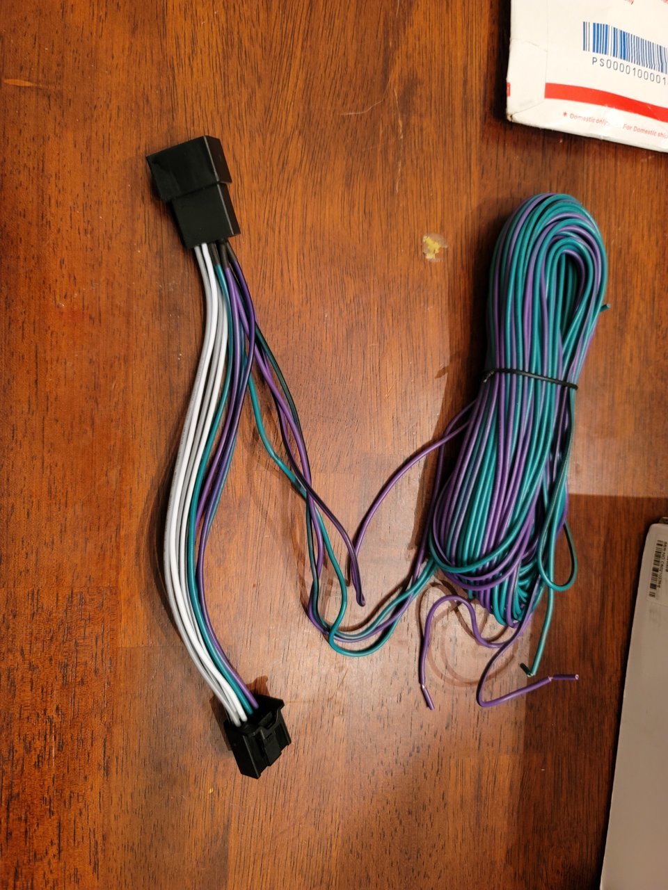

    Hmm, I was under the impression that the "add an amp" harness did not have the speaker wires and was only needed for power, ground and remote turn on if you wanted to run it through the radio harness. I am pretty familiar with audio, and Toyota Audio in general as I used the same taco tunes harnesses for my previous 4runner amp and powered sub. The only think that is different and causing me some confusion is that the Kicker Key doesn't have any pass through RCA outputs (from my understanding) for a sub so I am having to get the speaker signal from the radio for the powered sub as well. Something I didn't not have to deal with in the 4runner.
    does anyone have any pictures of the 2020+ add a sub and add an amp harnesses that have not already been spliced into factory wiring? I think a visual will help me. I don't trust that the taco tunes site has the correct harnesses displayed when selecting 2020+ on the drop down menus.

    yes exactly. the amp harness is only used so that you can get the male and female connector for R51, which is the speaker leads. The default wiring uses the rear leads to get the signal for the sub. that is not optimal. as you build your wiring I recommend you tap the front speaker instead.
    all of the other connections on the amp are not from the back of the radio. power run from the battery directly. remote turn on not needed if you set the amp and sub to use signal detect.

    I’m 100% sure the add an amp harness only includes the speaker leads. I believe this is for 2020+ though since their speaker leads are all in one plug. I’ve never seen the add a sub harness so I couldnt tell you anything about it

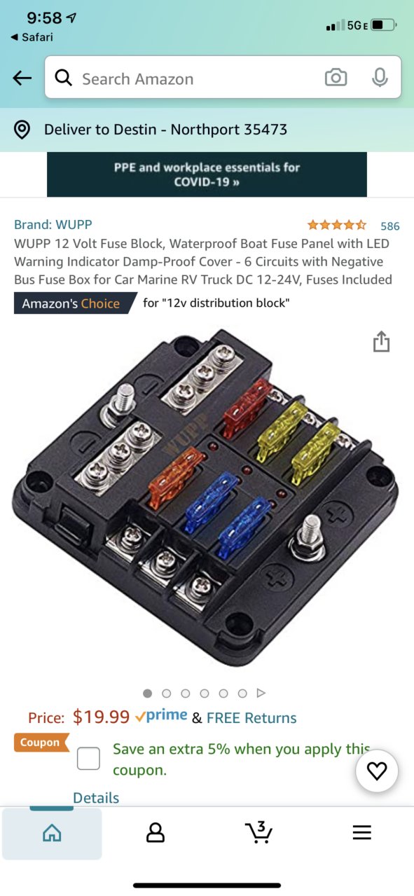

    You can get something like this that will accommodate smaller fuses and wires, but they typically are 6+ outputs when you only need two.
    they’re cheap though.

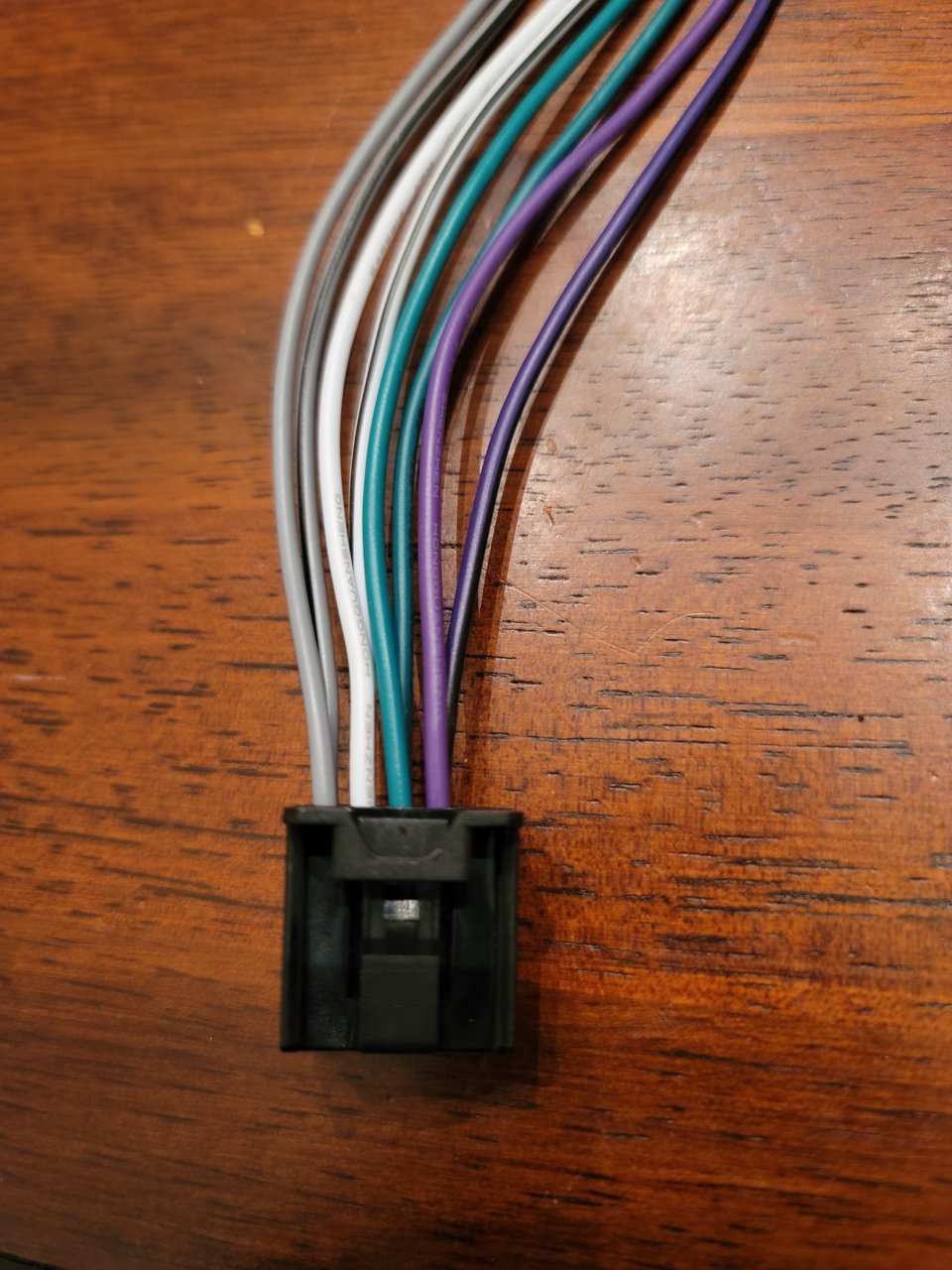

    @destin_meeks I'm sure you've touched on this a thousand times, but mind confirming FD, FP, RD, RP on this Toons harness for me?
    I'm assuming FD(Grey's (top + bottom -), FP (White), RD(Green), RP(Purple)16104944318964612334406194901423.jpg

    White -front driver
    Grey - front passenger
    Green - rear driver
    Purple - rear passenger
