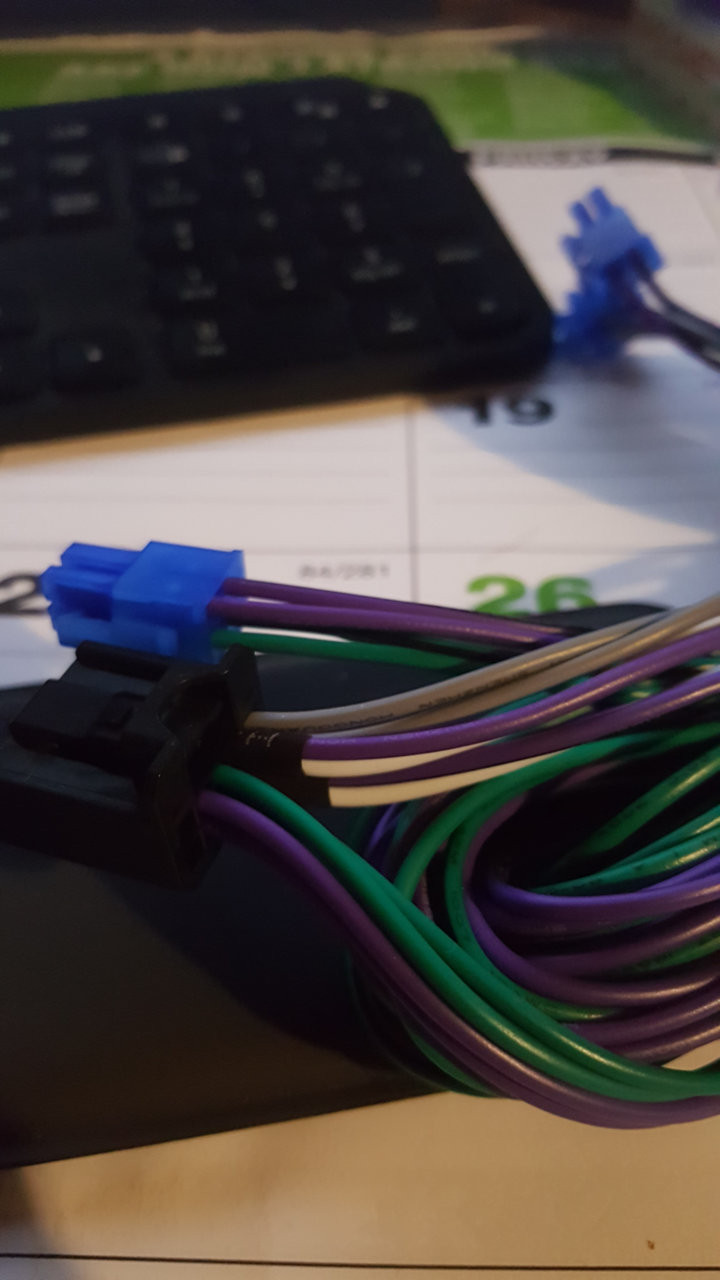

    thank you for that great write up. It seems the "unnamable" add an amp harness that I recently purchased for my 2020 has the pair of purple wires for the sub signal paired with the hu output "white speaker wires" inwhich I believe is one of the front speakers(fL). All need to do is splice in a pair of wires for the fR to connect to the Key500.1. D@mn just match the wire colors up, I had gotten confused how I'd do the wiring until I saw this thread.

    That’s weird. The one I ordered like 6 months ago had the sub tapped into the purple wires (one of the rear speakers). Maybe they realized they were idiots for doing that and redesigned it. Haha

    My guess, they read your comment and fixed it, lol. Got this about a week ago
