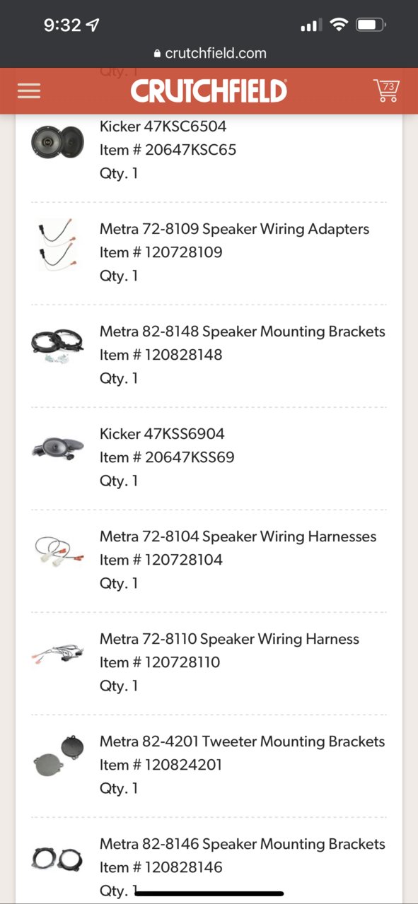

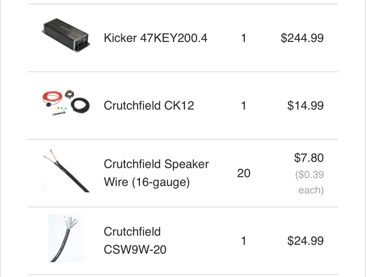

  17. May 16, 2022 at 9:38 PM
    #137
    RTweet
    RTweet Well-Known Member
    Jun 29, 2021
    #369956
    1,323
    Oregon
    2021 White TRD Pro, MT
    Ugh…I think I’m in over my head after reading through this. I’m not installing a sub just yet. Do crossovers/component speakers make a difference? Sorry for the photo dump, but I’m hoping one of you pros will look at my gear and tell me what I might be missing for a clean install w/o too much cutting of OEM:

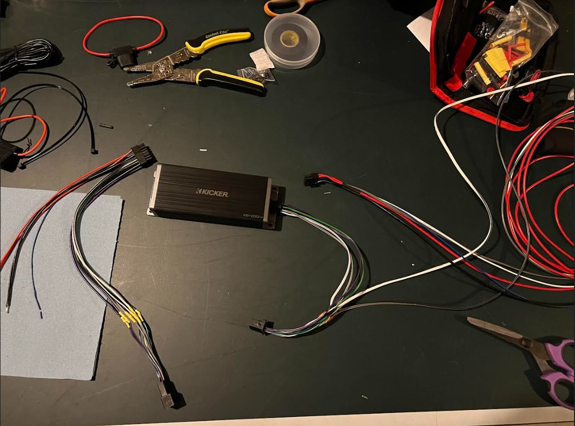

  19. Nov 11, 2022 at 7:50 PM
    #139
    DawsYoda
    DawsYoda Member
    Mar 21, 2022
    #393147
    20
    Casey
    Colorado
    ‘21 Army green Tacoma OF
    3.5 inch RC lift Kicker speakers/Key/Hideaway Leer Topper
    So I haven't seen anyone post a photo of the new '20+ harness. So I took a photo of mine, assuming I didn't stray from @destin_meeks guidance, it should be right ha.
    Used the yellow heat shrink so you can see where its cut/soldered. The harness from the hideaway 3 way splices with the kicker key input side speaker(grey/white) and the redwolf add an amp harness I got from Amazon.
    Bob1971 likes this.
  20. Nov 12, 2022 at 4:14 AM
    #140
    destin_meeks
    destin_meeks I used to fix people's crappy stereos
    Jul 14, 2017
    #223997
    3,933
    Destin
    Tuscaloosa, AL
    2017 SSM DoubleCab TRD Off-Road 4x4
    Looks spot-on to me! Get your power wires run and you’re golden!
