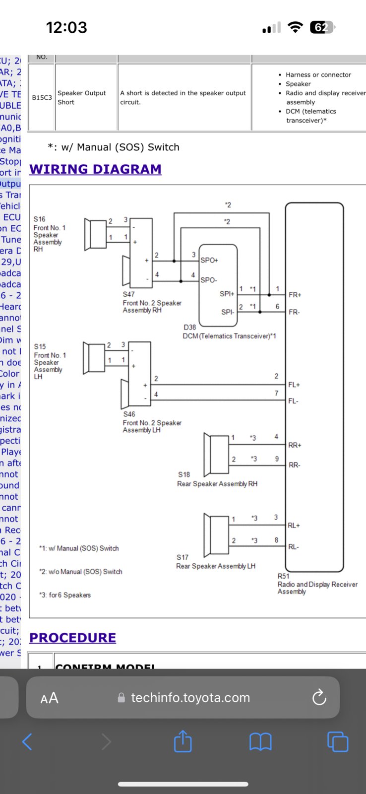

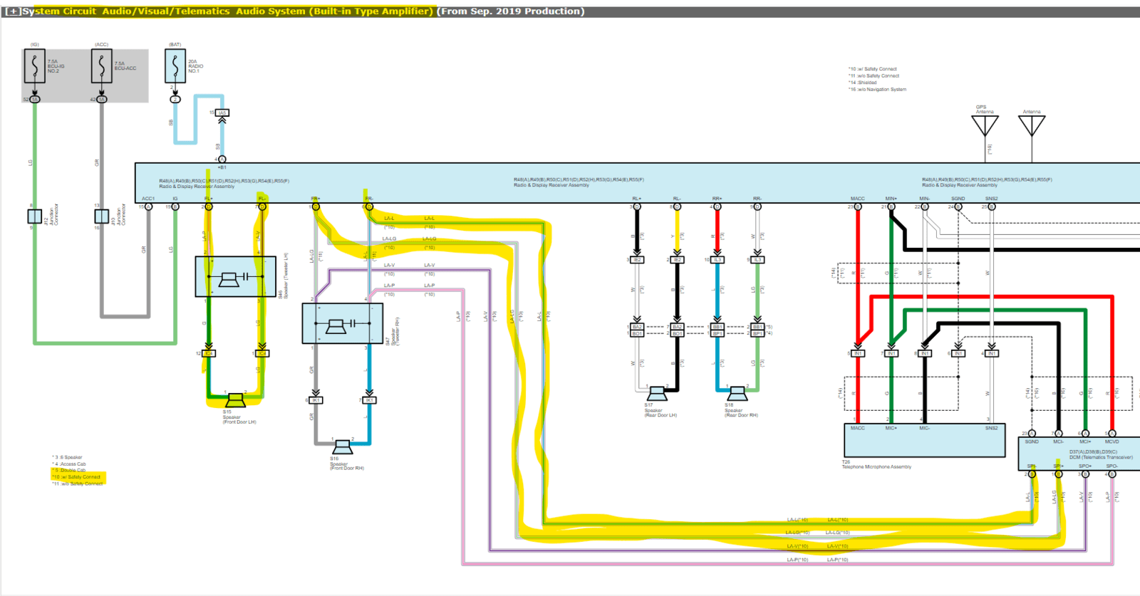

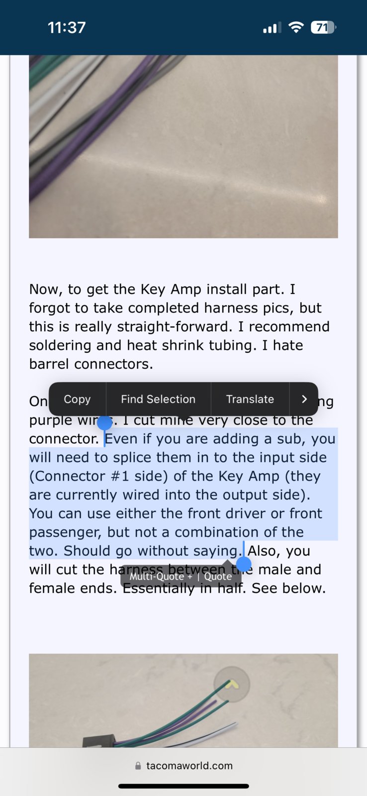

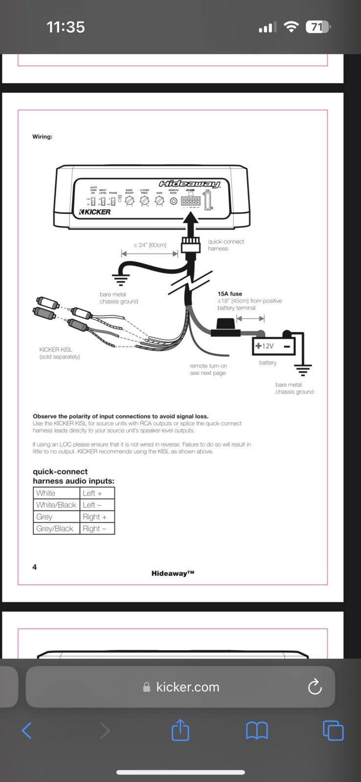

    Thank you for your help. I ordered the harness and the Scosche kit and I have the rest of the stuff. I understand that the Red Wolf harness gets cut in half and then connected to the appropriate harnesses that come with the key.
    #397 on this post helped me out a lot: https://www.tacomaworld.com/threads...ker-key-amp-install-assistance.568985/page-20
    I just have a couple more questions if you don’t mind answering them.
    1. The post I mentioned above, he says “if you are adding a sub, you will need to splice them in to the input side (Connector #1 side) of the Key Amp (they are currently wired into the output side). You can use either the front driver or front passenger, but not a combination of the two. Should go without saying.” but the Kicker Hideaway comes with wires to go to two speakers, is it okay to just connect it to one? If it’s okay to just connect to one then disregard my next question.
    2. The wiring diagram on TIS shows that the Front-Door LH (Driver Side) goes from R51 to the speaker and back but if the vehicle has safety connect then the Front-Door RH (Passenger Side) goes from R51 to D38 and then to the speaker. Am I going to need another harness or would I just splice into it?

    So I want to say this and hopefully help, because I can tell you're thinking very seriously about this, which can be good in most scenarios.
    You're thinking way too deep lol
    The hideaway wires CAN go to both speakers. White to White, Grey to Grey. There's 2 sets of wires for a reason. Most songs are mixed for the bass to come from left and right so it's not crucial to use both, but the wires are there so I always wire them both.
    The hideaway wires do need to go on the input side of the key. If they go on the output side, they will have the auto-EQ and crossover settings, and you dont want that.
    As for the telematics receiver, that whole service got discontinued back in 2022 so the module (for those who have it) is just dead weight at this point. I genuinely forgot it even existed until I saw it on that diagram. SO dont worry about it at all because it doesnt work anymore.
