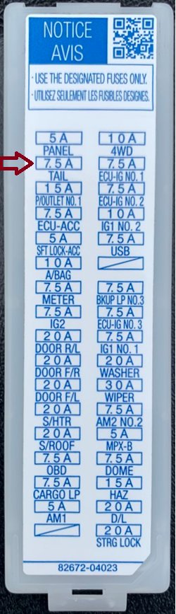

    Does it affect the parking/tail circuit, or just disconnect the input?

    It's a test. So you can visualize the effect. Replace the fuse after.

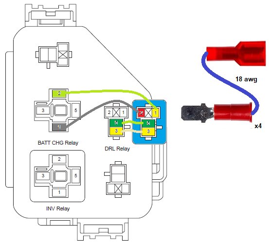

    Do you happen to have a pic of the drl relay bypassed?
