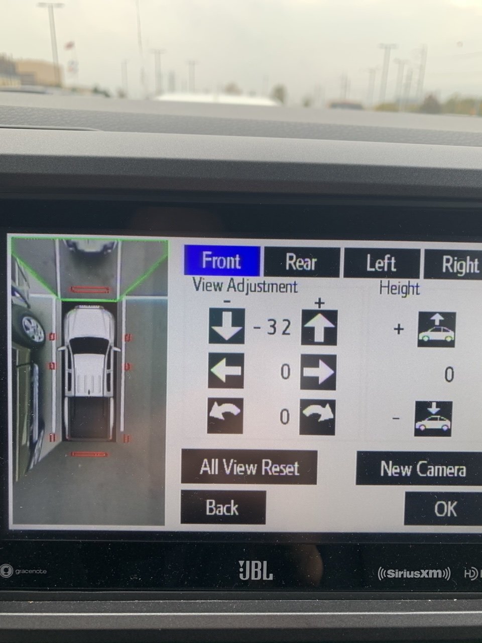

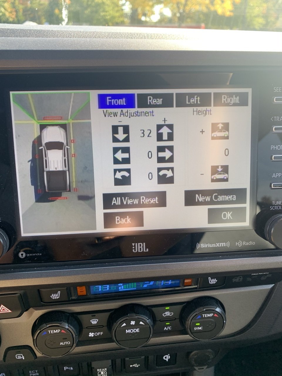

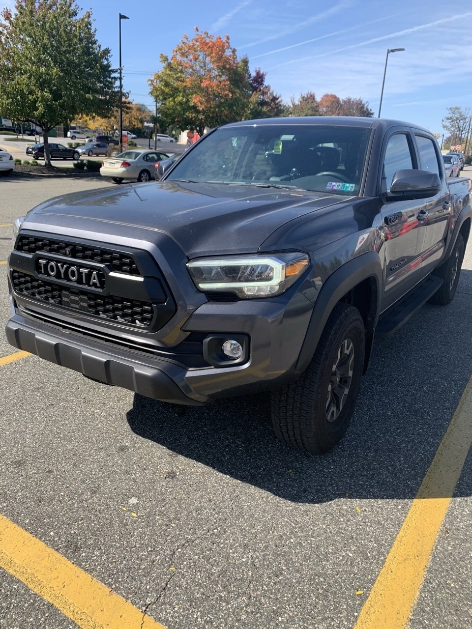

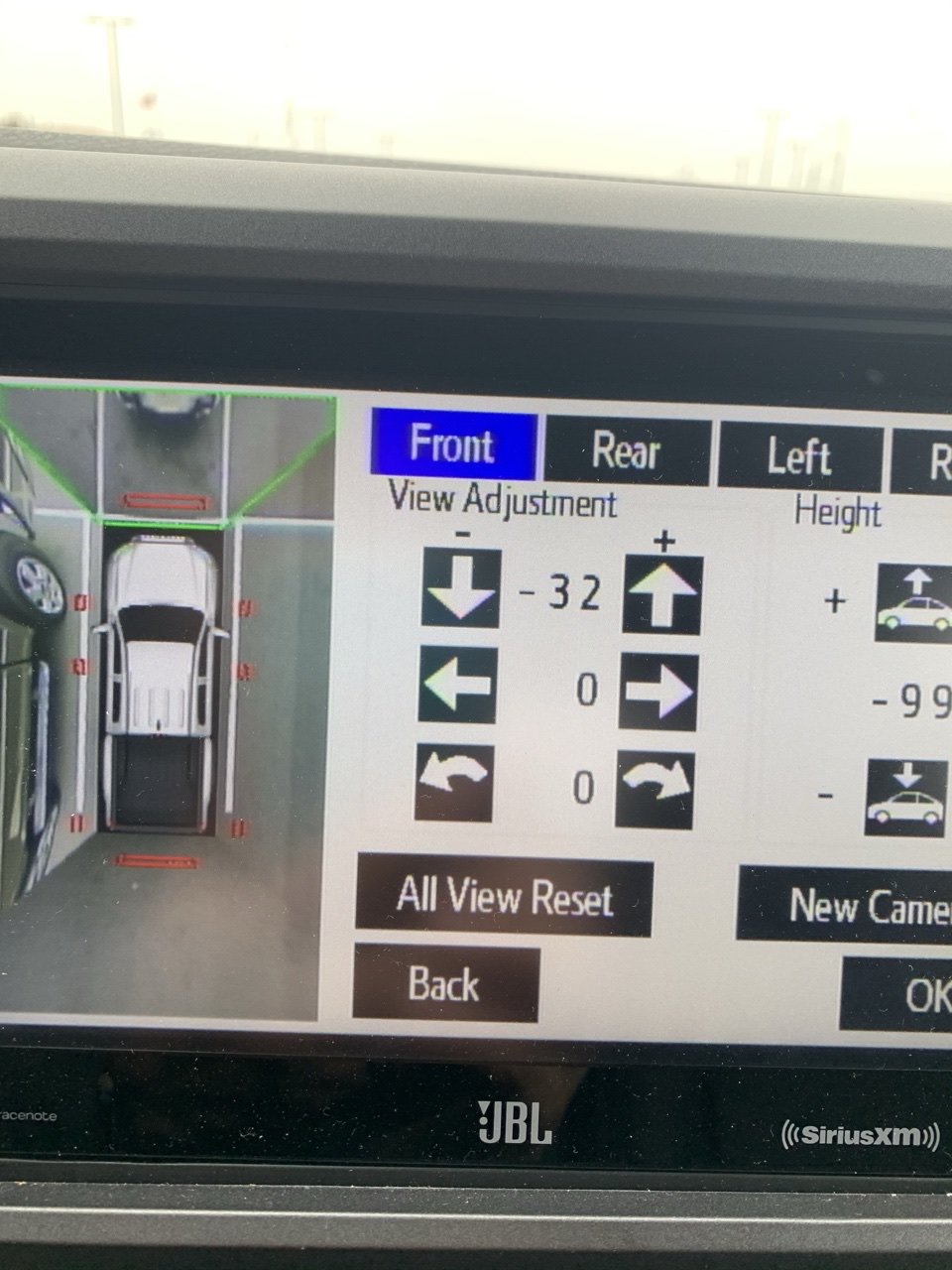

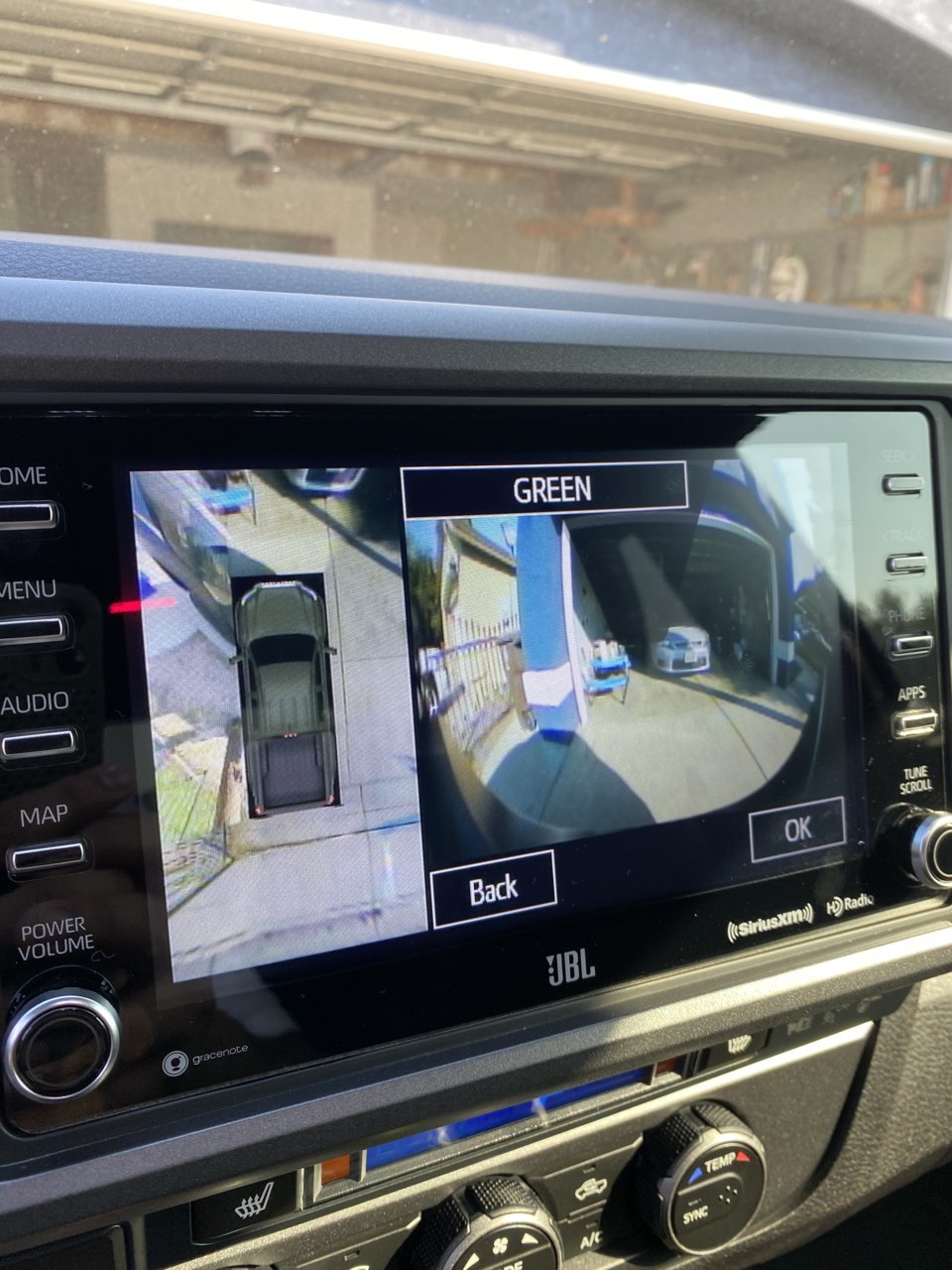

    Here are the pics and observations:
    1. The height adjustment doesn’t work as well as expected. It really doesn’t do much.
    2. When you hit the ok button, it starts all the values at 0 again the next time you go back into the screen. Since I maxed out on tilt up/down, I couldn’t go up even more the second time.
    3. When you tilt it up, it changes the angles of the lines. So the straights lines are now angled.

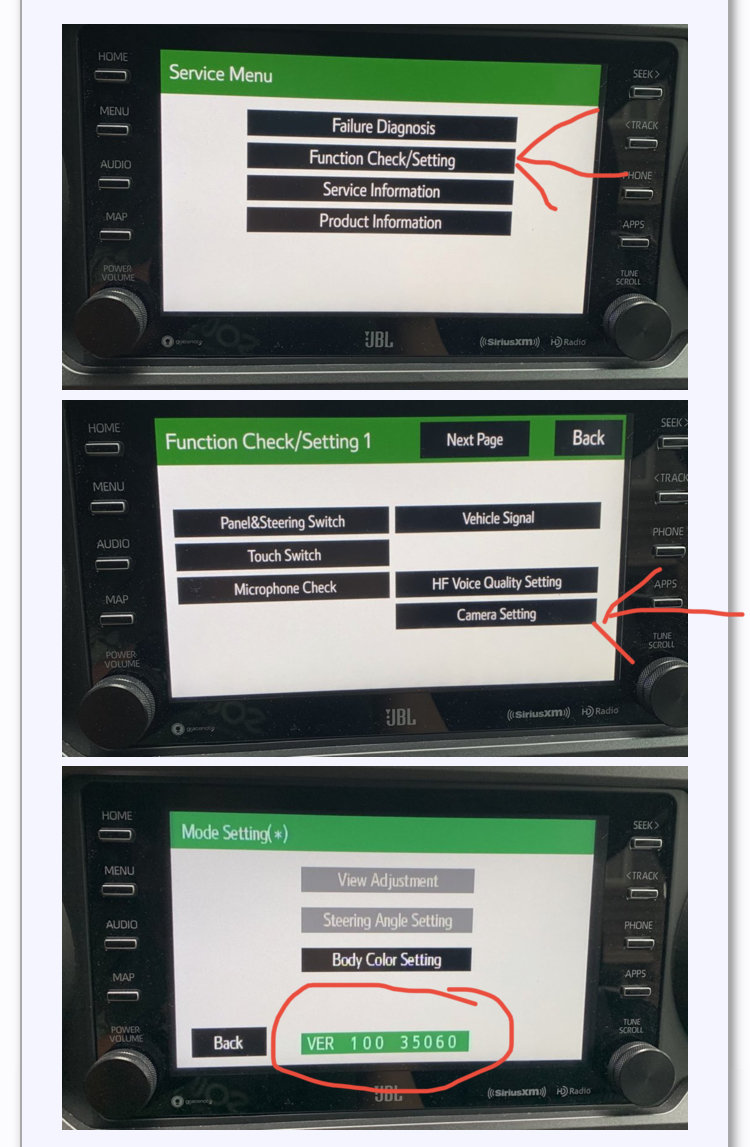

    4. I think the best bet might be to flash the software version for a pro version. That might be more intense
    Baseline
    adjusting vertical pitch?
    Adjusting height (I hit ok after vertical pitch and it set the value to 0 but kept the adjustment)
    camera
    shameless photo op

    Can a TRD Pro 2020 user please post their software version?

    can you take a picture of how the 360 view looks at the max height and lowest height?

    What happens when you adjust the horizontal?

    Move it left and right. So your left line would be straight and continuous but your right would be way off

    I just got a trd pro grill as well. Transfered over the front camera from my 2020 limited tacoma and im getting a same effect. The lines are a little off. Anybody figure out how to adjust the stitched image for this?

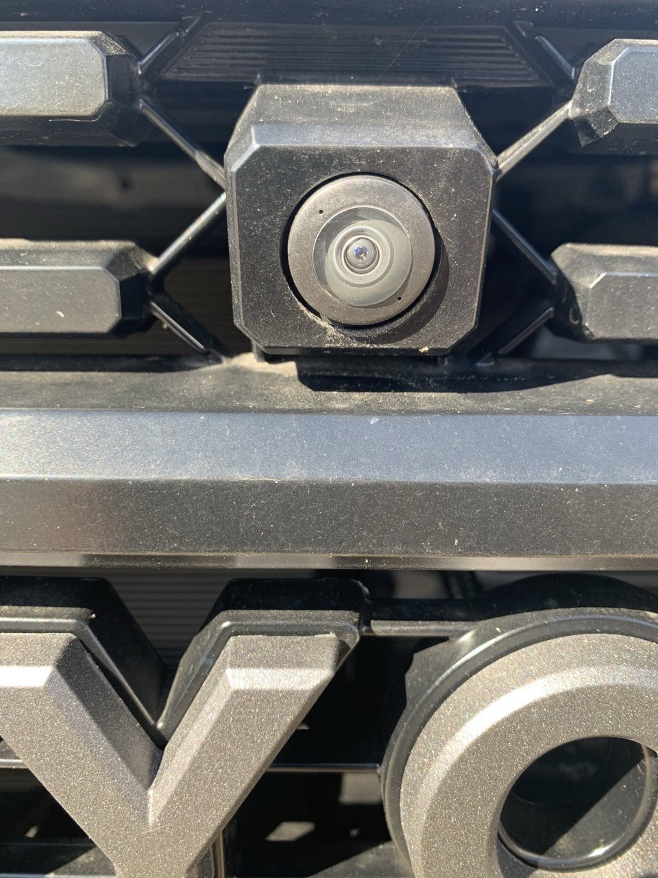

    How did you mount the camera? I had to make a mount.

  14. Oct 22, 2020 at 8:17 AM

    Make sure you don't use PLA, if you park your truck outside it'll warp.

    Nope used PETG!

    I use HTPLA (high temp). Bake it in the oven for an hour or so and it strengthens up - only the high temp PLA does this. Worked inside the vehicle in southeast georgia over the summer and didn't warp. I think I even printed it with only 20% infill. Previous attempts with regular PLA curled up real bad.

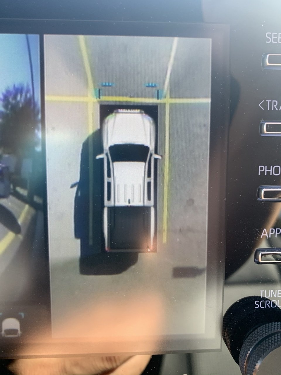

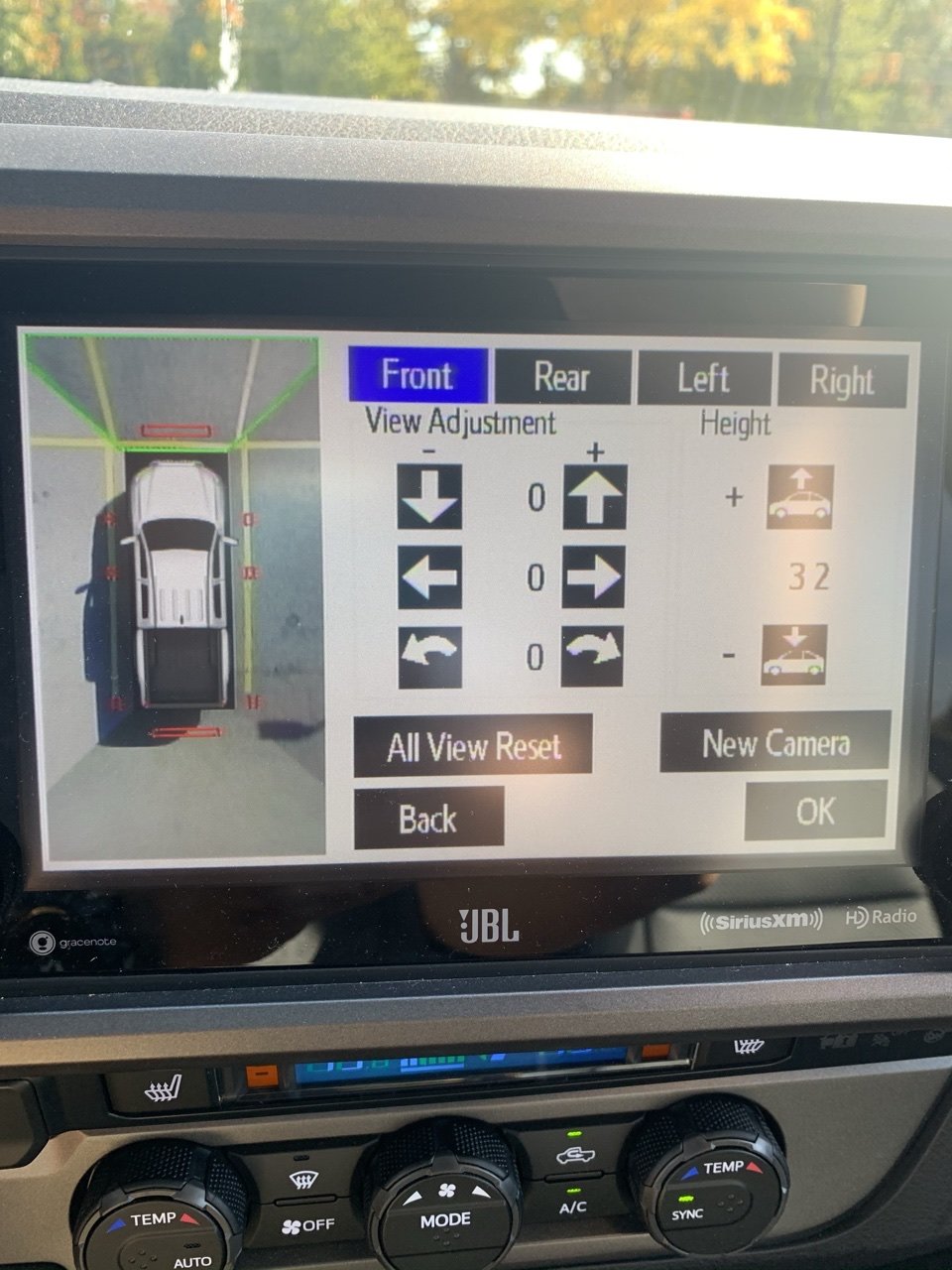

  19. Oct 29, 2020 at 8:08 AM
    #39
    yshin80
    yshin80 [OP] Well-Known Member
    Dec 28, 2019
    #314389
    62
    2020 OR DCSB MGM
    I put the view adjustment back to factory location. Two picks show full range of height adjustments.
    HLTaco likes this.
  20. Oct 29, 2020 at 8:28 AM
    #40
    brenguy
    brenguy Member
    Oct 17, 2020
    #344123
    15
    Brendan
    2021 Tacoma Off-Road
    yeah it doesn't look like it changed much. the max height adjustment is 0 though? that's weird.
