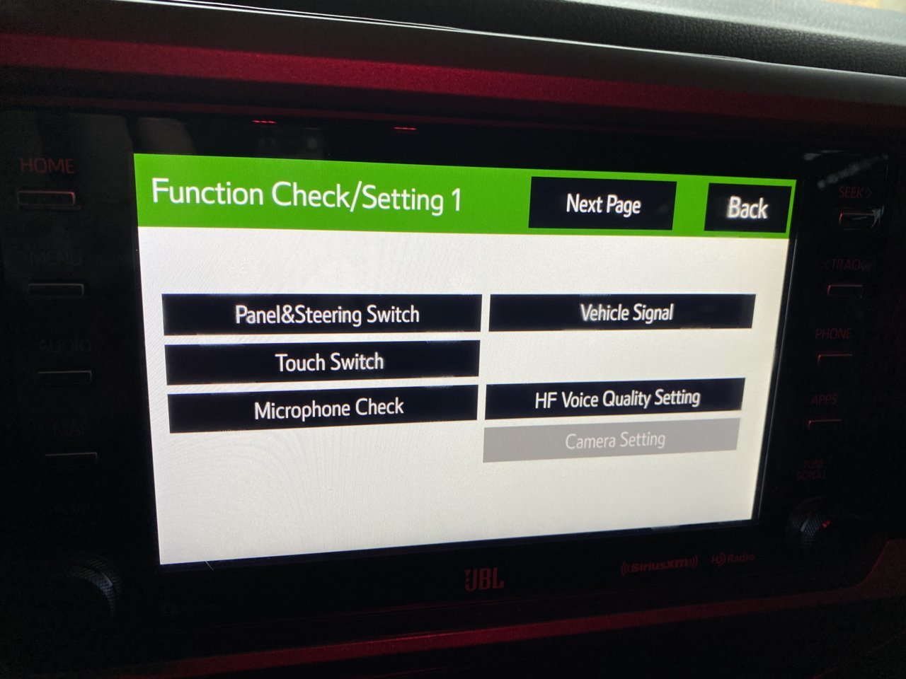

    @yshin80 All of this is probably moot, but while I can get to the menu the camera settings are greyed out. I should take that as a sign to just leave well enough alone but any ideas?

    Gotta hold your finger on it for a few seconds then it opens

    Thanks...I had tried that already but it didn't work.

    FWIW, I was using the "Hold Audio Button While Switching Headlights Between Auto And Off Three Times" maneuver while in Accessory mode to access the hidden menu and had the issue above. Turns out that if you then put the car in Ignition On mode (but don't start it), all the options under Function/Check Settings menu become available.
