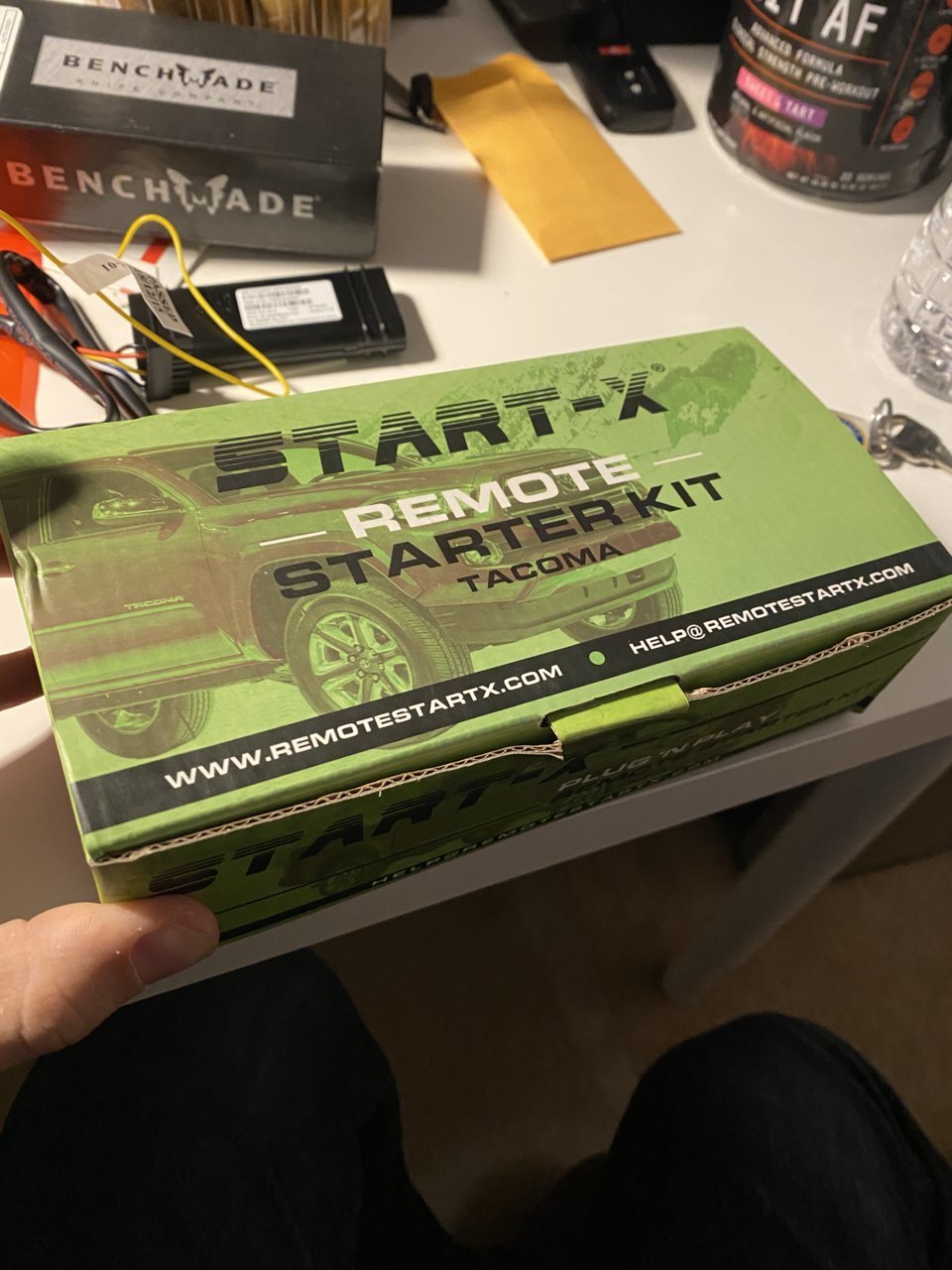

    Easy to install. Works on OEM key fob. Had to splice 2 extra wires and everything else was plug and play. 30min max install time.

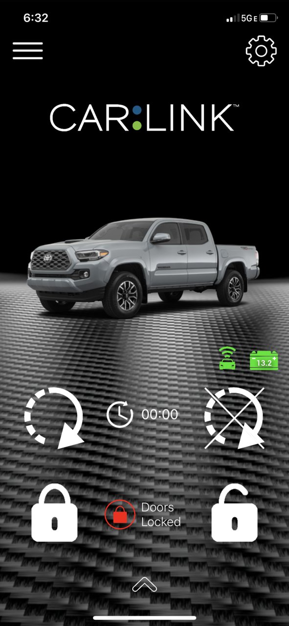

    Added the Car Link today to the remote start. Give me worldwide range now as long as I have a cellular signal.

    Nice. Wish I knew about this beforehand. However it was an easy install and even added a car link. Paid $289 shipped for the remote start and phone module.

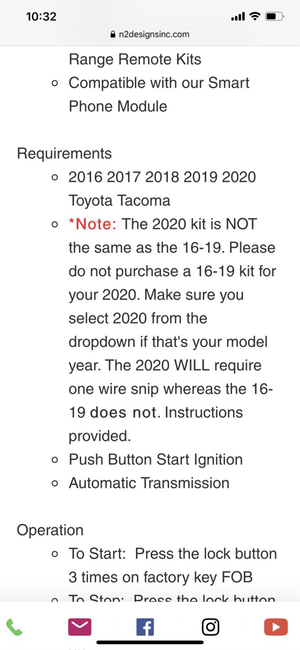

    So I just researched and was about to purchase, but your website also says something about wire snipping? E85F55FD-B7D2-4A03-9D67-D18A5135F1CC.jpg

    2018 that identifies itself as a 2021
    Mods: Is this still a Tacoma?
    Yes, there was no way around it. The original method of fuse pull takes out your hands free. Last minute discovery. I’ll need to delete that or edit it. Sorry!

    Hey do you cut the pink wire off completely then connect the 2 wires to the pink wire?

    Yes I cut the pink wire far back enough to be able to connect the two wires needed to make connection. In total it completes the relay.

    Just installed today, it works. First time I made the mistake by buying the 2019 startx. But switched to the 20. It is an easy install. Thanks for the comment on cutting back far enough. I almost cut right at the plug
