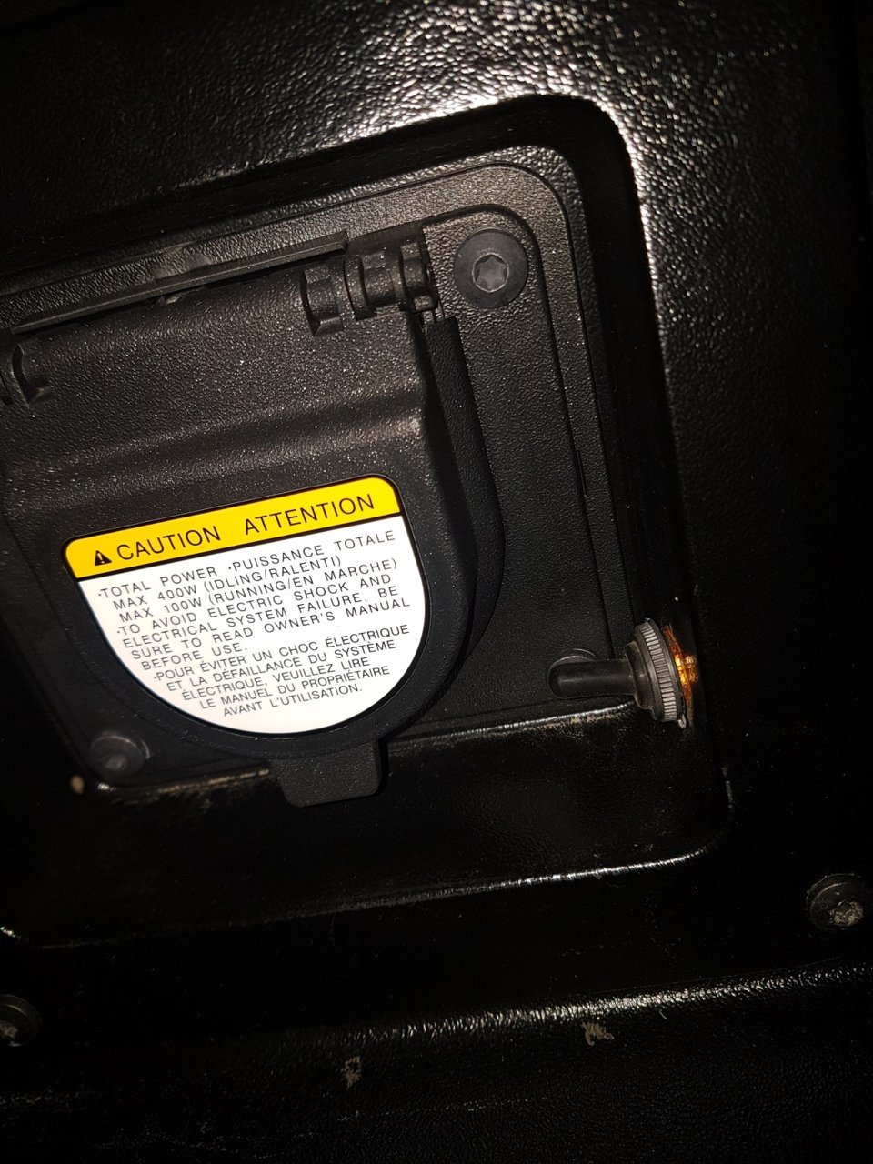

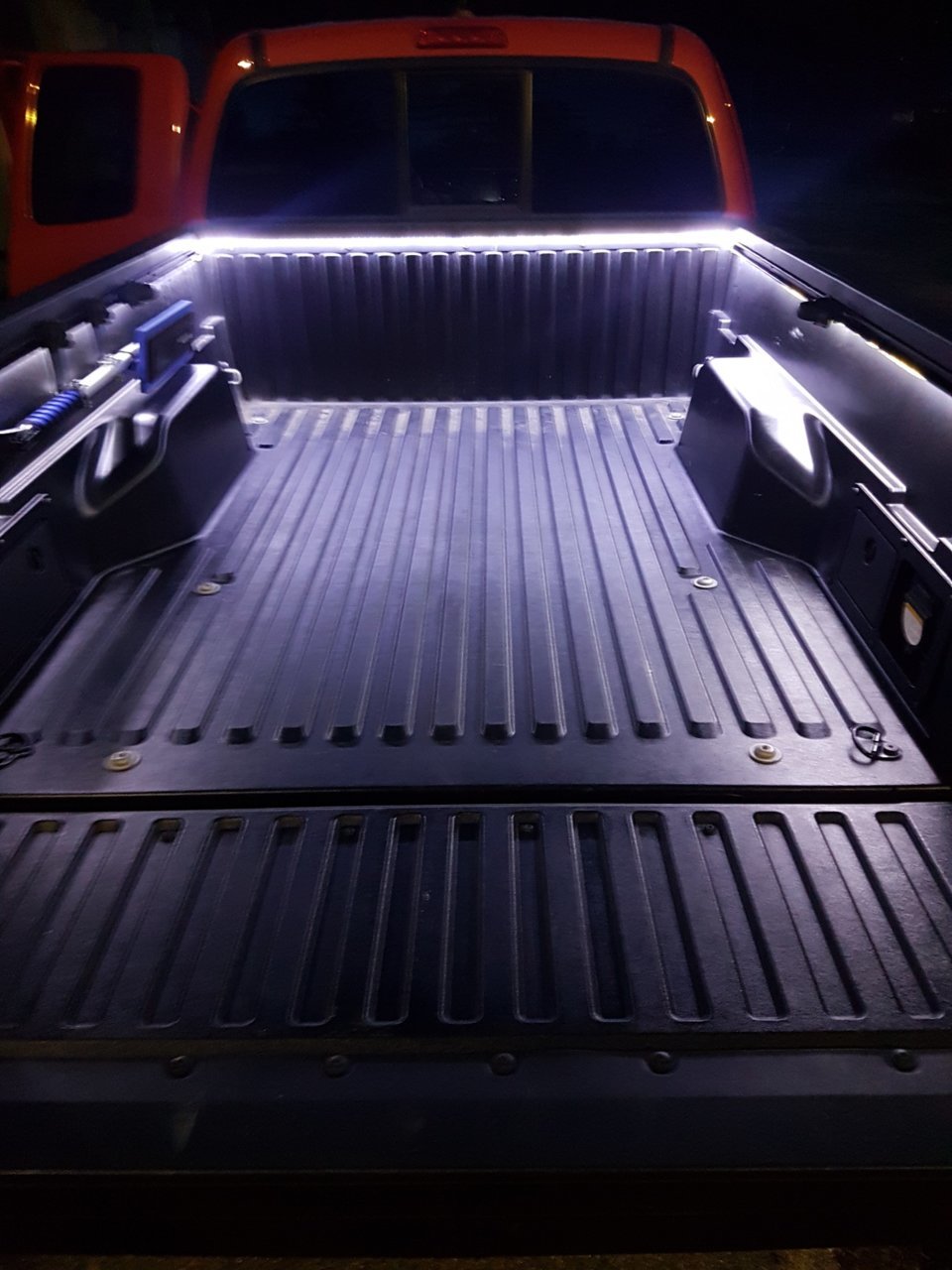

    I got my truck before bed lights were a thing so I ended up wiring my own using waterproof LED strips and a SPST flip switch for ~30CAD, had plenty of LED strip leftover so I also added lights to the hood with a hood pin switch (roughly 6 bucks at Princess Auto; like Harbor Freight for Canada).
    EDIT: added pics, didn't realize my switch was beginning to rust, I should put some protectant on that lol

    Thank you. I didnt realize this before. I opened up the firewall and switch box and I do not have a relay on my firewall. So will need to get that along with the switch. Does anyone have a good source to acquire a switch at a relatively decent price. Dealers want about 70 to 80, about the same on Amazon, that I saw.
  10. Mar 4, 2021 at 12:05 PM
    nseandawn
    nseandawn [OP] Member
    Mar 2, 2021
    #357968
    5
    Nish
    2020 Tacoma Access cab V6
    Nice setup. Do you have a write-up or direction on how you accomplished this? Also, I always wanted a light that came on when we opened the tailgate. I did some digging on this issue but didn't find anything solid. Anyone else has had any luck?

    Ooof it has been so long I don't remember whose write up I used. There were a lot of people selling kits (for 100USD+ mind you) and figured I could do the same for cheaper using their step by step guide. Mind you I have absolutely zero skill and zero tools. Was basically:
    -buy and stick on LED strip
    -cut/wire to size (one end is prewired, you could cut and wire additional sections for sides and back but I'm dumb so just bent it around)
    -wire to switch
    -run wire along bottom of frame
    -wire to battery
    Again, I'm dumb and poor as bricks so all my stuff was acquired on aliexpress/ebay and the dollar store and borrowed any other tools (like a drill). Same goes for every single other mod I've had on my truck (minus the bumper, which I paid to have done since I would need WAY more tools and another person to install that)
    I only skimmed this video but looks pretty much like what I did:
    https://www.youtube.com/watch?v=r4j9PYdsWWY
    Looks like he uses a prewired kit, since his lights have separate sections of the lights already wired unlike my lazy method. He also uses a push button switch which I did have (~7CAD for a pack of 5 on ebay) but it failed me maybe 4 years later, which then I replaced for the current SPST switch last year.
