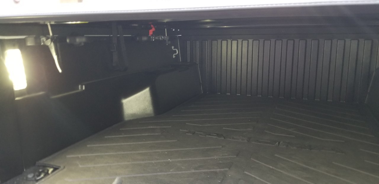

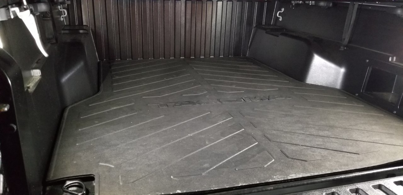

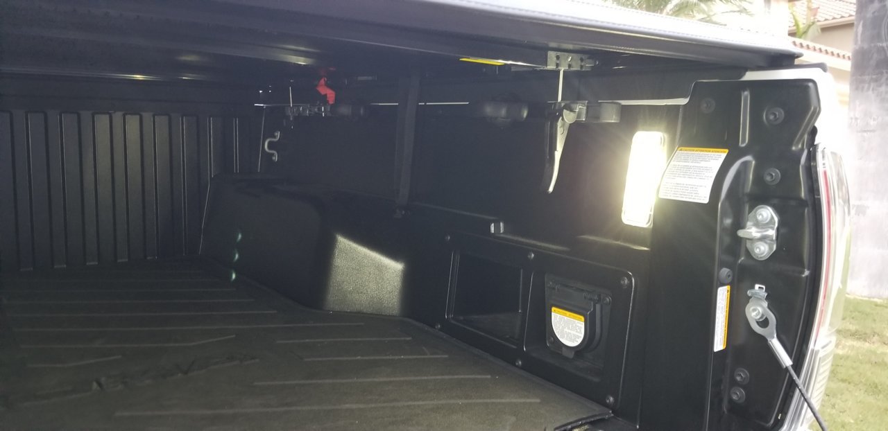

    Not at night but the only shots I have at the moment. First two are immediately post install late afternoon on a cloudy day.
    This one was at 6 am before work, pretty much 'night' time with a couple street/building lights nearby.

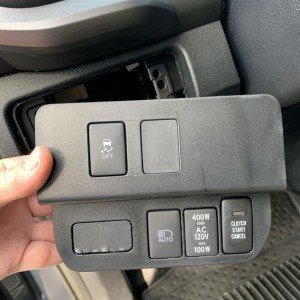

    For the access cab you will need these 3 things... (sorry not a good pic) I ordered these and waiting for them to come in.20200423_155450.jpg

    My bad, on my phone I couldn’t tell FLJB uploaded photos. I have the off-road access cab, with only a 3rd brake light, no bed light attached to the 3rd brake light. So based on the instructions, I just need the switch and bed light kit, no relay. Thanks, your pics were great. One more question though, how do I remove the panel in the first pic CF278285-6459-4DC1-A123-557604243D56.jpg

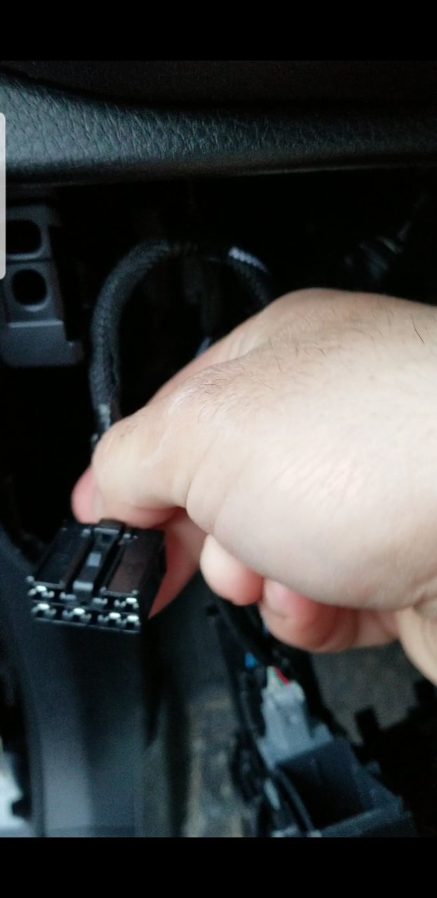

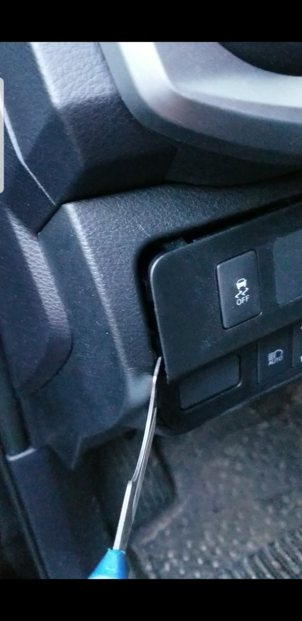

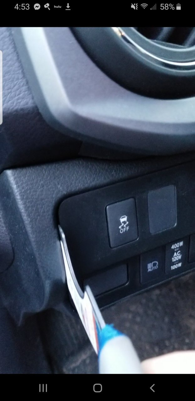

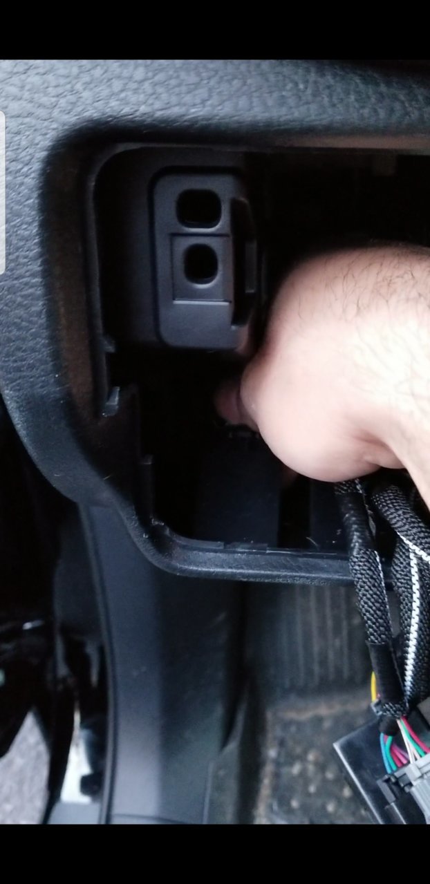

    Yes it is plug and play. To remove the switch panel I used a painter's tool (see photos) and pried it from one side until I was able to get my fingers behind it and just pull it off. You will need the relay too. The plug for the actual switch is just "below" the switch board. I circled it in blue below. Just pull it out from the holder it is in (looks like its already plugged in but it is not) and plug it to the switch.Screenshot_20200426-165333_Video Player.jpg Screenshot_20200426-165358_Video Player.jpg 20200426_165639.jpg

    a few more photosScreenshot_20200426-171515_Video Player.jpg Screenshot_20200426-171530_Video Player.jpg
