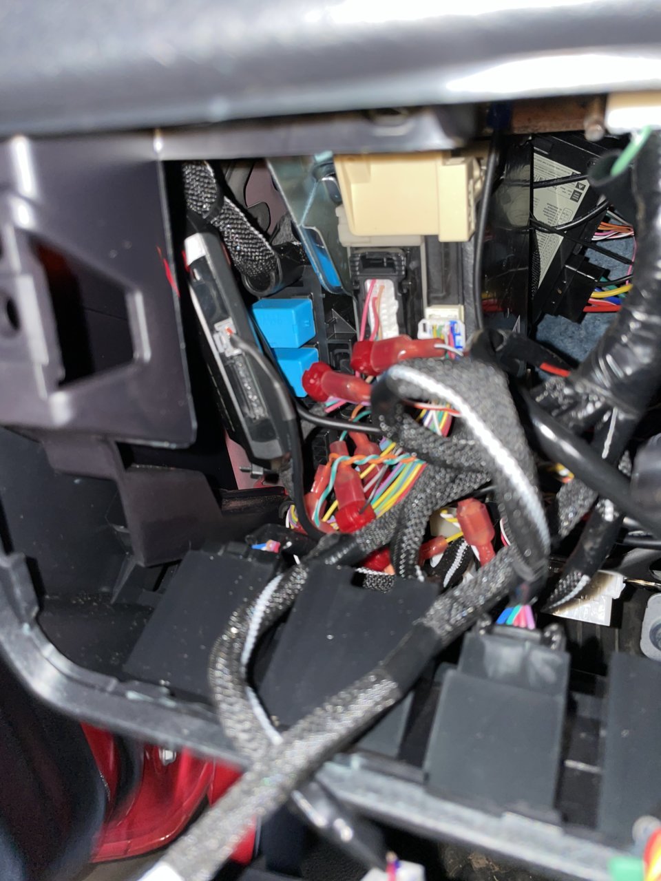

    So I pulled the switch plate and did find the relay block with 2 relays in the top 2 positions.
    I also located the harness plug, so I should be in good shape as soon as the parts are delivered.

    Well I thought I had found the switch harness. NOT!
    Anybody got an idea for an Access cab where it would be??
  5. Dec 21, 2020 at 9:55 AM
    11,786
    In this pic of your nest, what is on the other side of the arrow?
    tgregory6852[OP] likes this.

    Praise the lord!! That’s it. Your a genius.
    thanks!

    Caribe,
    Did you know what the harness on the other side is for??
  12. Dec 21, 2020 at 11:30 AM
    11,786
    Pull the connector and take pic of it...
