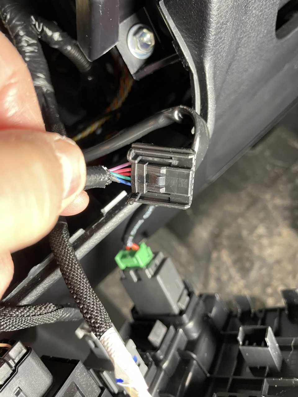

    Dealer under coating. OEM Tacoma bed mat, Weather tech mud flaps and Window Deflectors. Also added bed lights and switch.
    Here’s the pix of the harness from yesterday!

    Any wire colors angle?:D

    Thanks! Won’t need that.

    Do you have a multimeter? Verify pins #5 & #6 when vehicle is ON. You have a IGN source if you add any switches.
