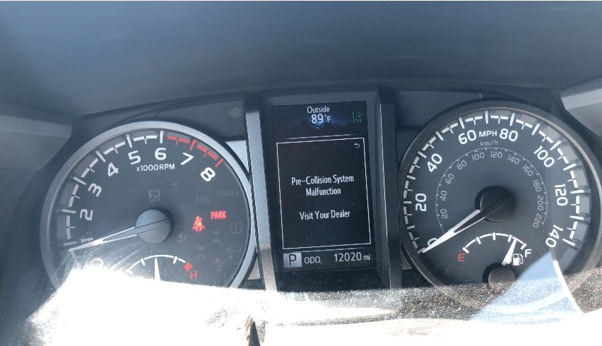

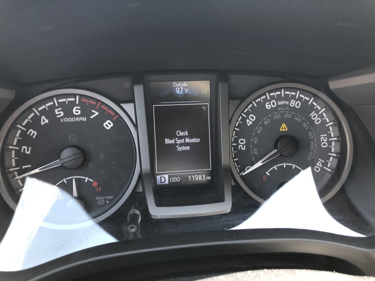

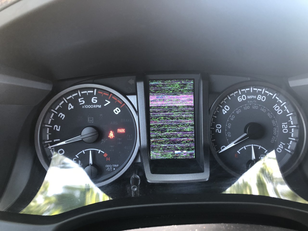

    Hello TacomaWorld,
    Hoping to get a hand with some electrical issues in my 2020 Tacoma. Only 12,000 miles and 9months old.
    1. BSM system check
    2. Pre Collision System Malfunction
    3. Back up camera not displaying (system will alert if something is close to the rear, just not seeing anything)
    Everything has been working for the 9months great. Around 11,700 is when the problems started. So it starts like this…Every morning I drive to work (20 miles) at about 7/7:30am. Everything is fine. After the car sits in the parking lot and I leave work around 4/4:30pm I get the problems.
    I think it has something to do with the heat, and lately getting 80-100 F out.
    Took it to the dealer once, the guy said nothing was wrong. Sent me home. Three days later I was back at the dealer with the exact same problems. They kept the truck for 2 days. Now they are saying it’s because of the LED bulbs.
    I personally find it hard to believe that a light will cause these issues. Especially since the lights were all replaced the same week I bought the truck. I have a hard time seeing at night, so that is always the first thing Ive done with all my cars.
    I feel like they are reverting to some BS answer to try to get out of holding their end of my extended warranty up so they don’t have to warranty a pricey computer comment.
    Any thoughts and suggestions would be much appreciated. Also if anyone knows any good Toyota mechanics in the Denver/Aurora/Centennial area. I am looking to take it somewhere else for a second opinion. (I pick it up tomorrow morning. I will be requesting copies of all the diagnostics ran and can post copies here too.)

    Try a different dealer and show them those pictures or open a case with Toyota

    Change back to original bulbs, when the problem duplicates confront dealer with issue.

    Second picture looks like EMI...could be correct on the LED cause.

    These 3rd gen really do not like led lights. The voltage checks done by the ecu just freak out at the change.

    try taking your LEDs out, and replacing them with stock. If the problem duplicates. Then take it back.

    I concur. Take out LED bulbs. If it fixes it then you know the problem.
