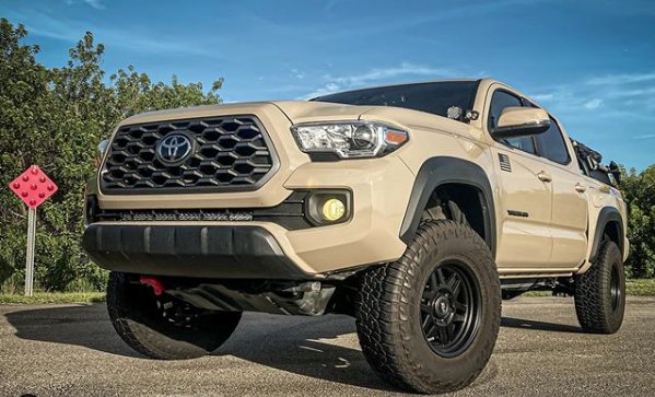

    Let me start off by saying I’m starting this thread to have a place for pictures of the trucks progression and the places that I will take it.

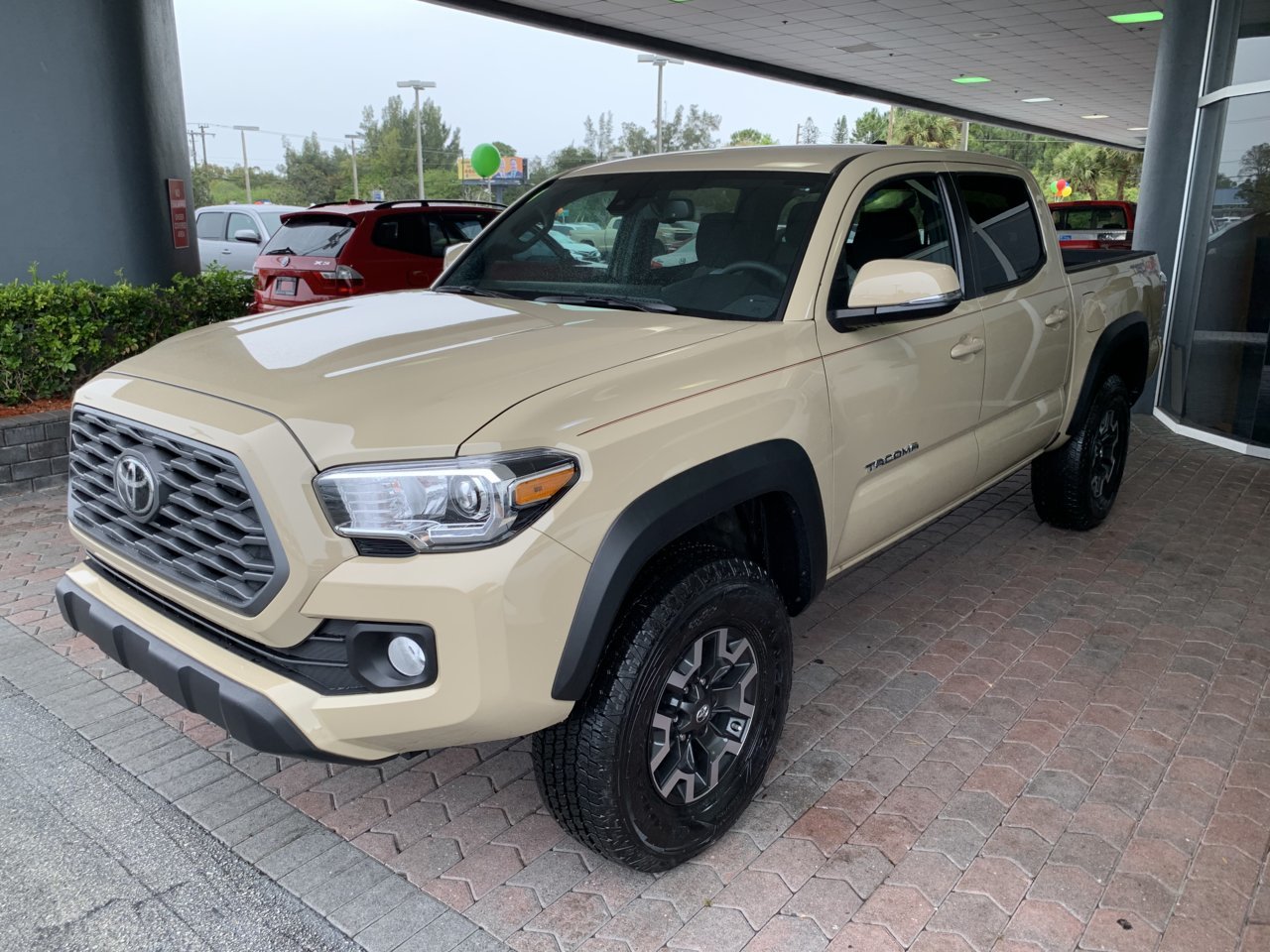

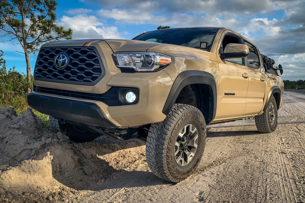

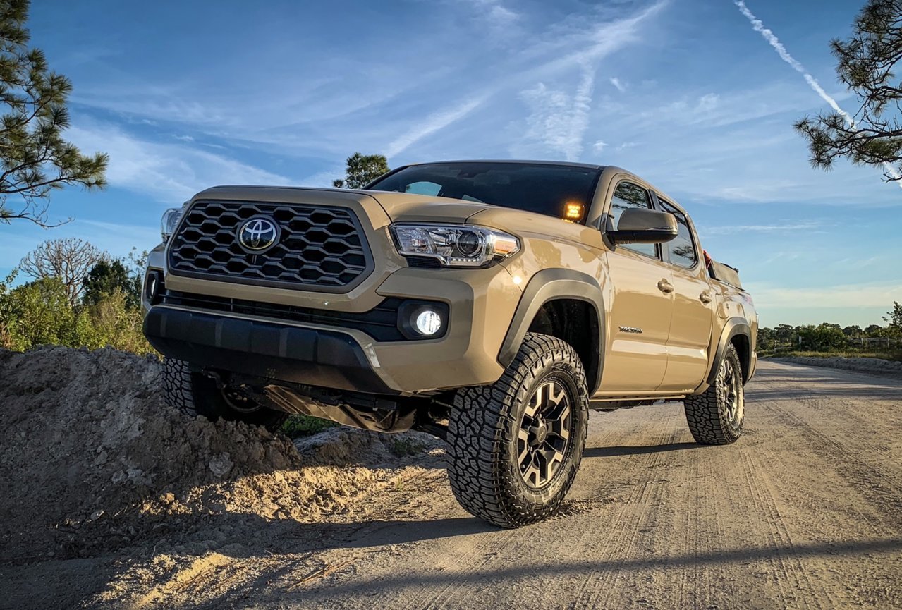

    This is my second Tacoma coming out of a 2018 Tacoma TRD OR 2wd and trading into a 2020 Tacoma TRD OR 4x4 M/T

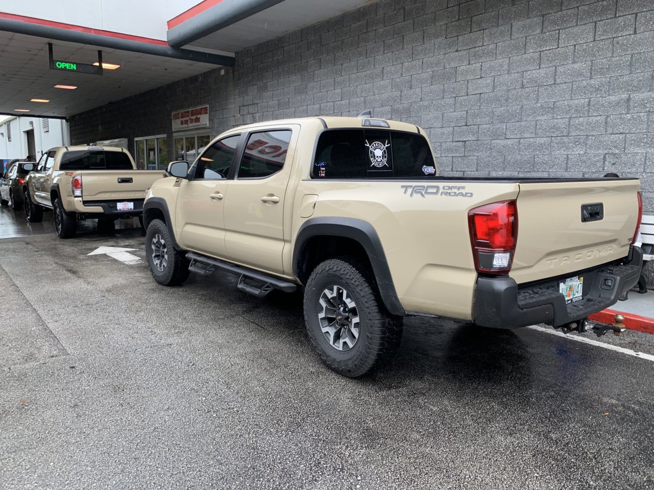

    Here is the first pic of the 20’ at the dealership
    The dealership swapped out the 265/75/16 Falken Wildpeak AT3W’s from my old truck as they only had 1k on them.

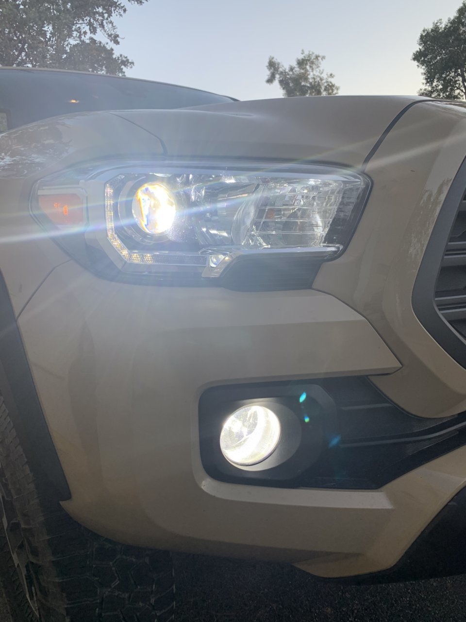

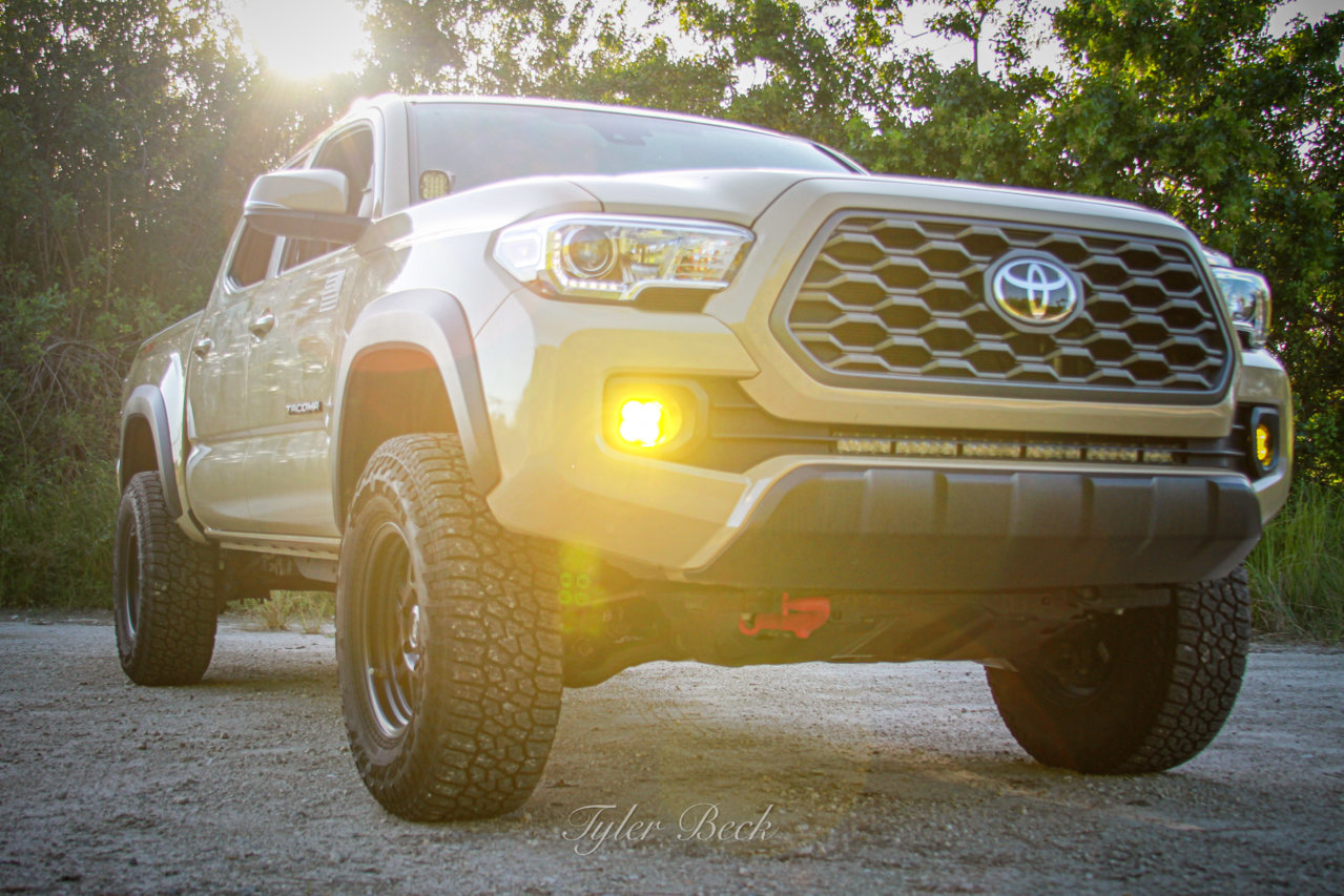

    First thing I did when I got home was swap out the factory headlights / Fog Lights / Highbeams to LED’s. I forget what LED lights I went with as I took them out of my 18’ as well.

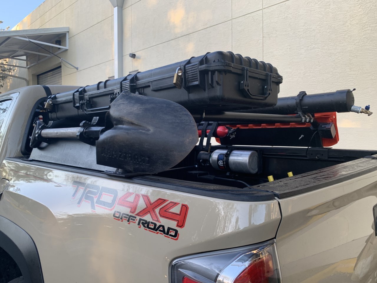

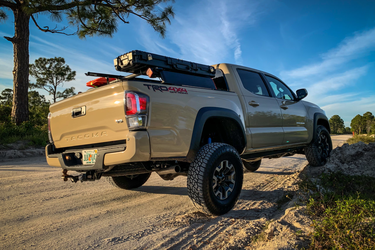

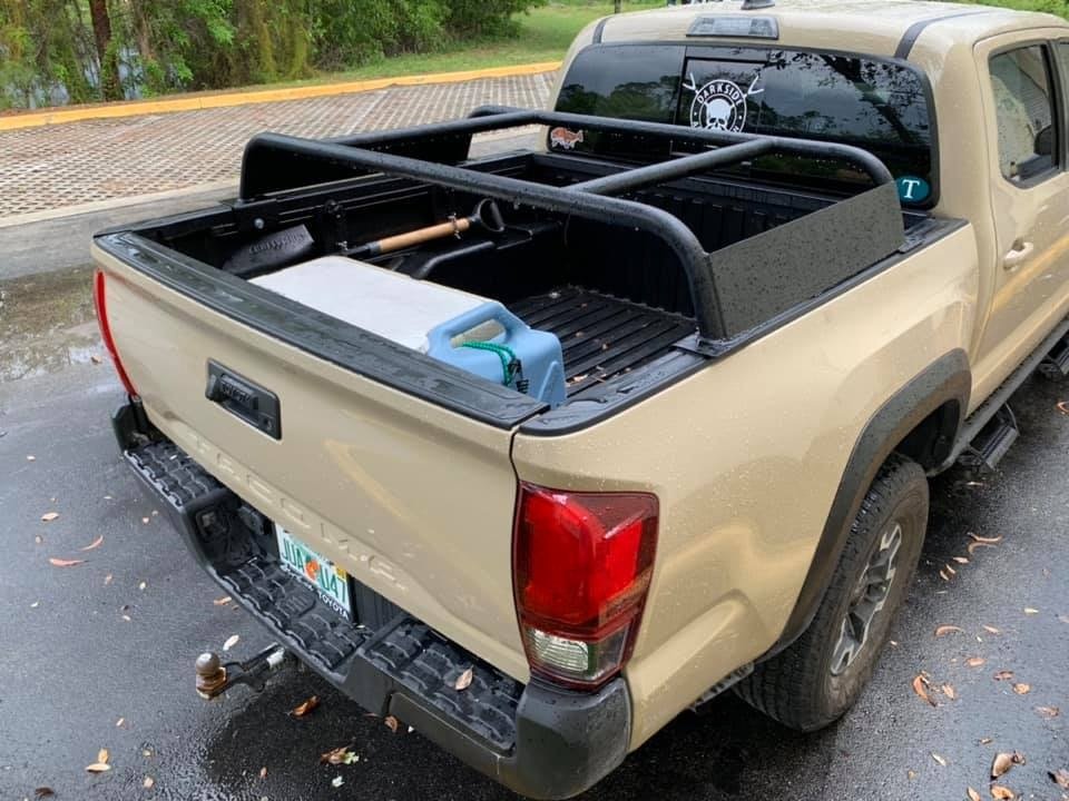

    The next step was swapping over the @allenfab Bed Rack and adding everything that was mounted to it back on.
    The rack has been through a few different setups but this is how it currently sits.

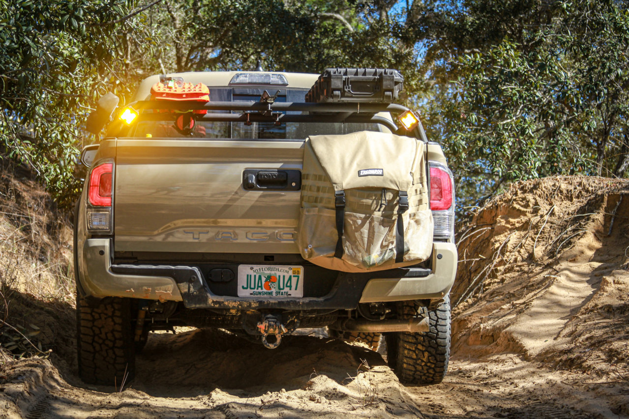

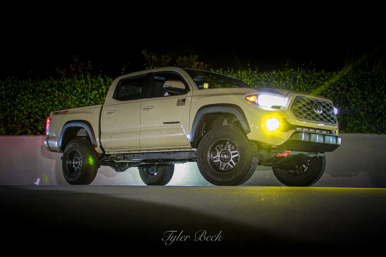

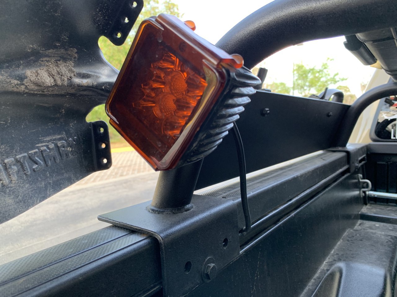

    The next step to the build was adding lighting. I wanted to add Ditch lights and bed rack lights. The bed rack lighting was mainly for using as a chase light on the forrest roads but work well backing in the boat at night without the amber covers on.
    E2A5F870-781B-4B2C-9B15-4CFD0C612A3D.jpg 465A9668-C45D-4D08-95D4-A2153BB7316A.jpg
    The LED pods are off Amazon, they were $40 for a pair. The Ditch light brackets were also an amazon special for $25.99

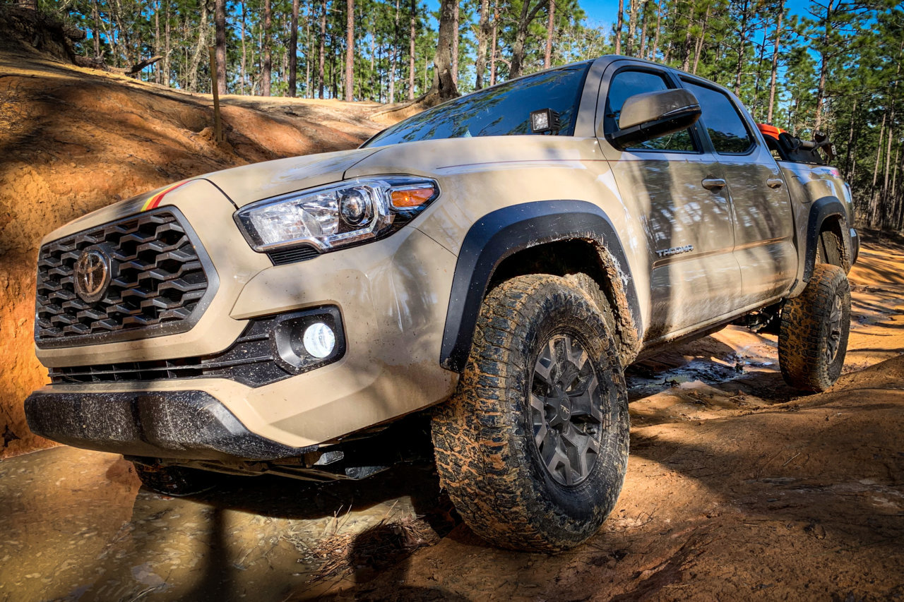

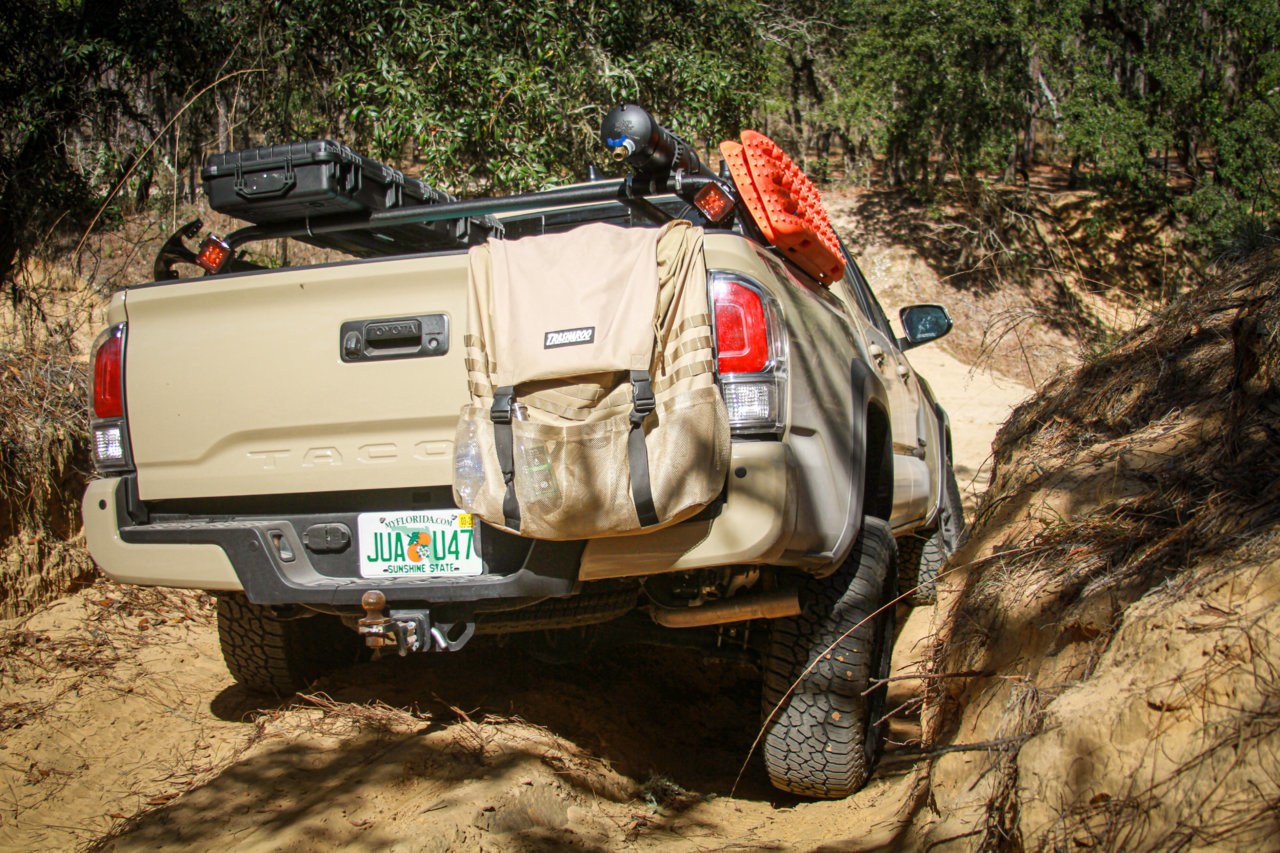

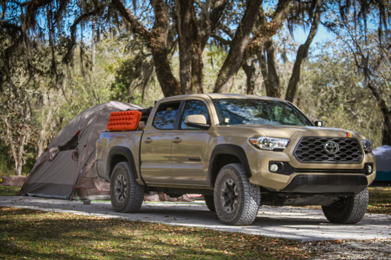

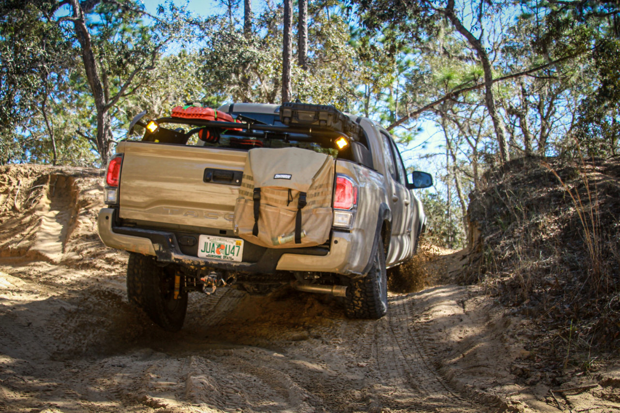

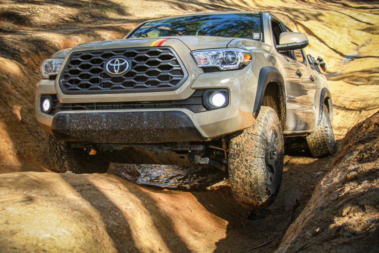

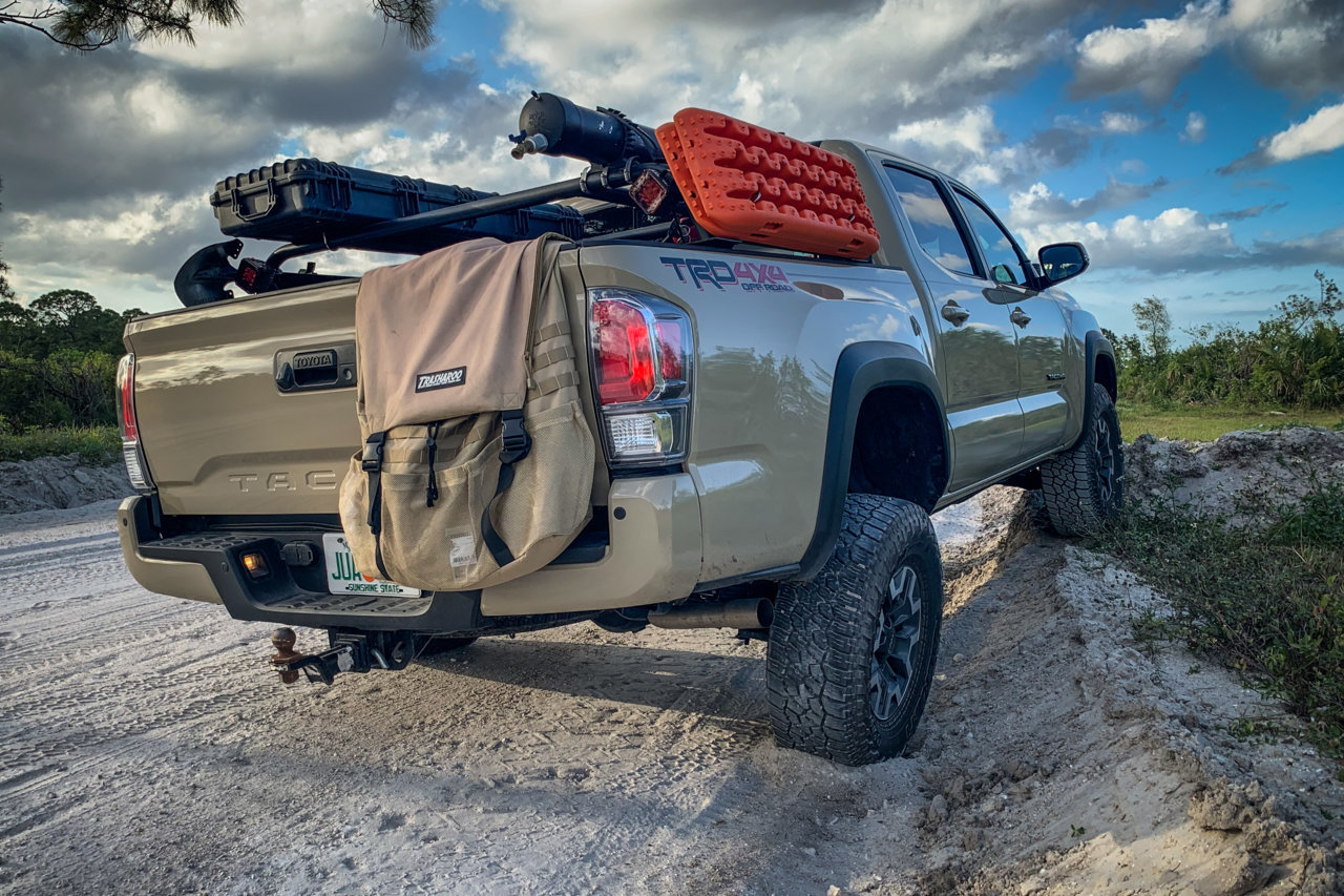

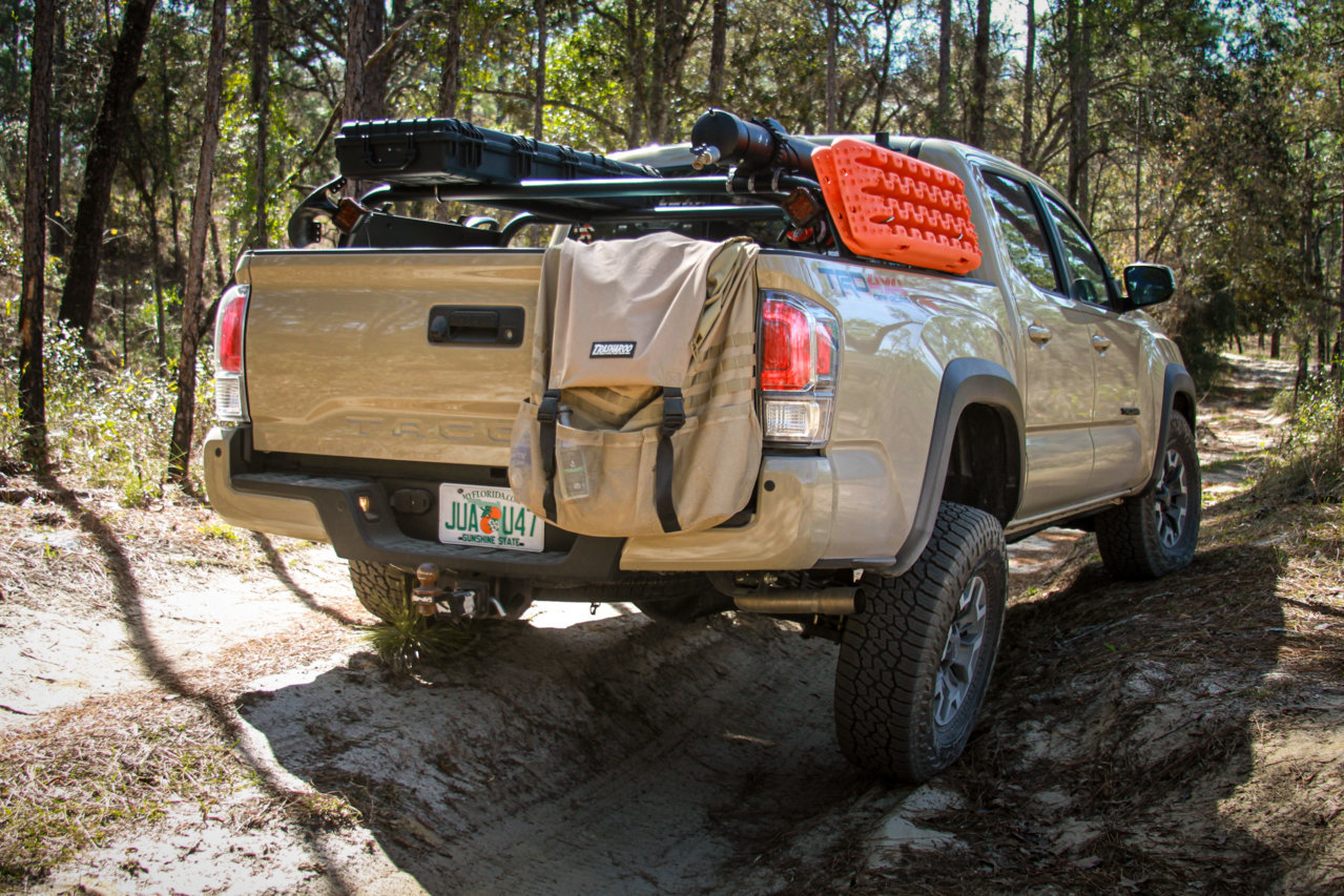

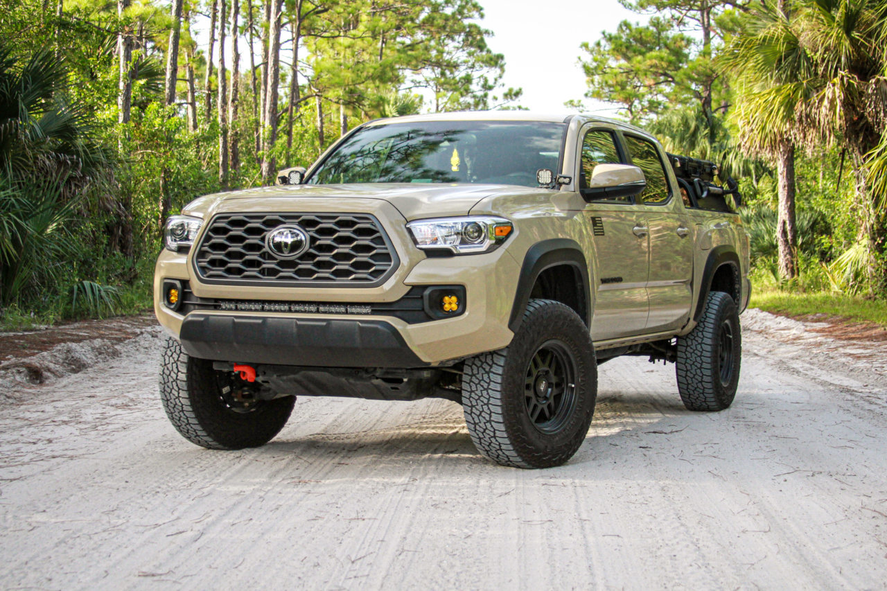

    The first trip I took the truck on was to Citrus WMA and Ocala.
    5332CE42-8D3B-49C3-ABBC-5E7434ADD2A3.jpg DD284935-E50F-4E79-AD89-2D4A4E756831.jpg F119A9EA-729D-4F0A-BDEA-1856D47D1A0D.jpg 56E86A1F-7EAD-4DFE-8376-D30F084459A6.jpg
    I came back home with some gnarly pinstripes and a little less paint on the rear bumper from dragging it on Trail 14...
    It was at that moment I knew I needed to lift it.
    The next trip was back up to Citrus and the Tate’s Hell for a birthday getaway.
    I picked up an Instant Air Supply 10lb CO2 Tank from @Trident904 to replace the Viair 88p and use it as a backup if needed or for one of my buddies that doesn't have a compressor yet.
    E2A4931D-4CD5-43D2-A3CF-F5FAA0A33D8E.jpg B7F4A6C4-C3F5-4429-ABFF-1AFE8F22A1D9.jpg 8D1C7888-50C0-4B2A-BF71-C247E5AACBF9.jpg 54362EB5-D36B-463D-B556-D625231BD5C4.jpg 8F4064E0-F378-4908-99CC-24EA87451935.jpg A64B84EC-C7B5-4078-B540-6FD792E9DF4B.jpg

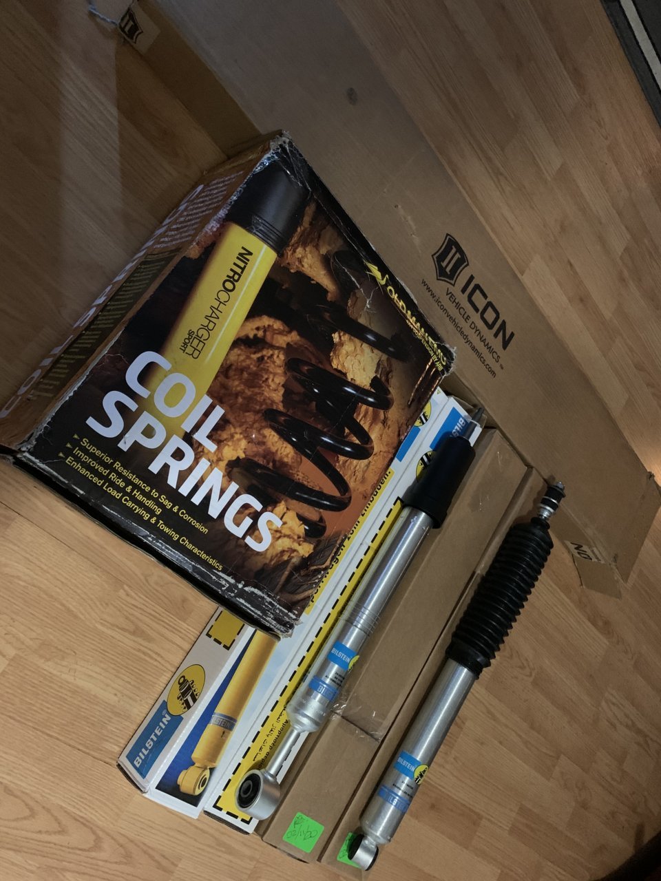

    When I returned from that trip I came home to find my lift came in.
    I went with the Bilstein 5100 Front and Rear and an Icon AAL, after talking with Brain he convinced me to get a set of OME Coils. I went with the OME 887’s.

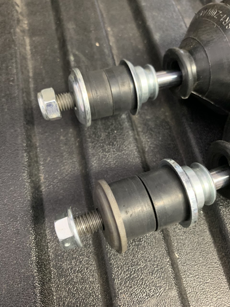

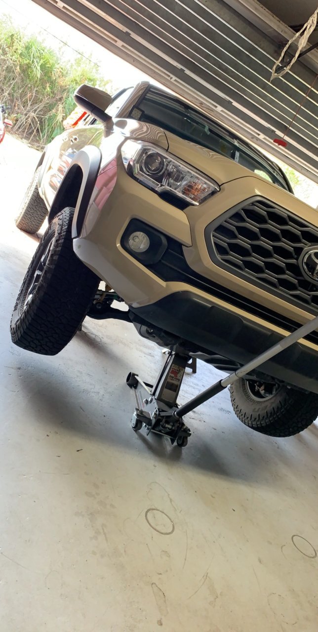

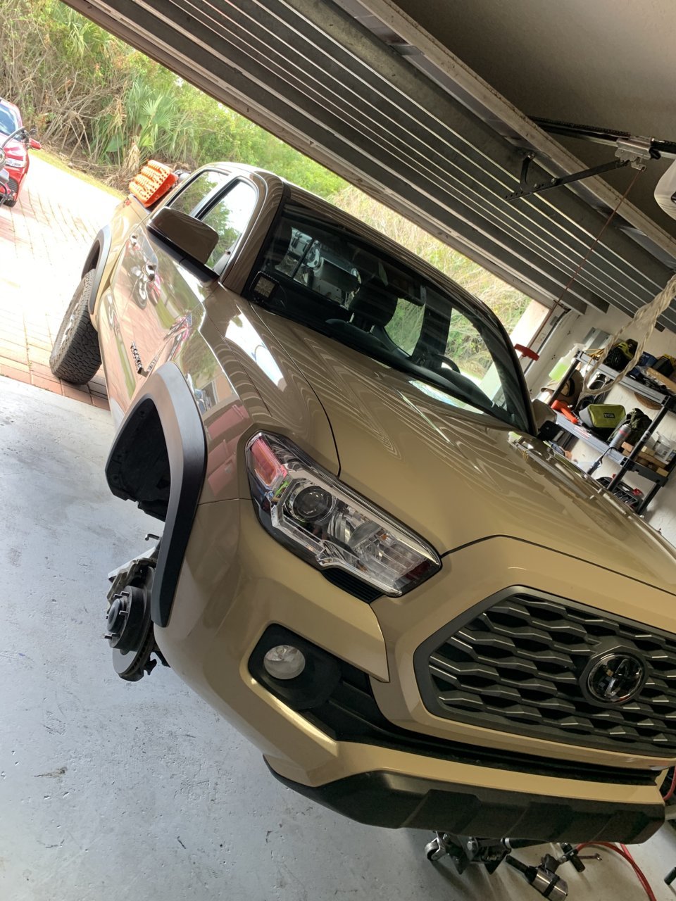

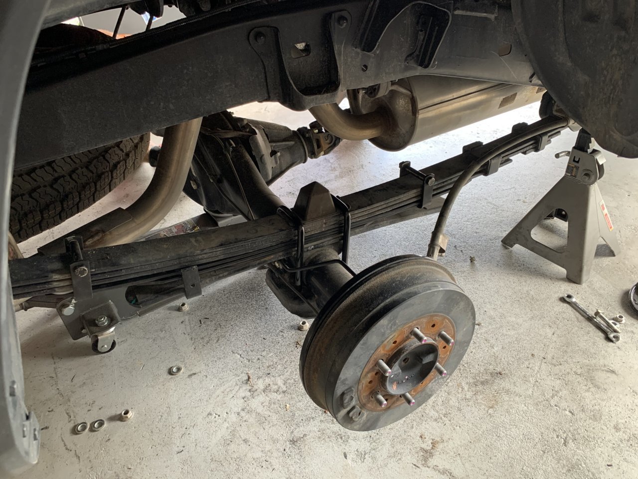

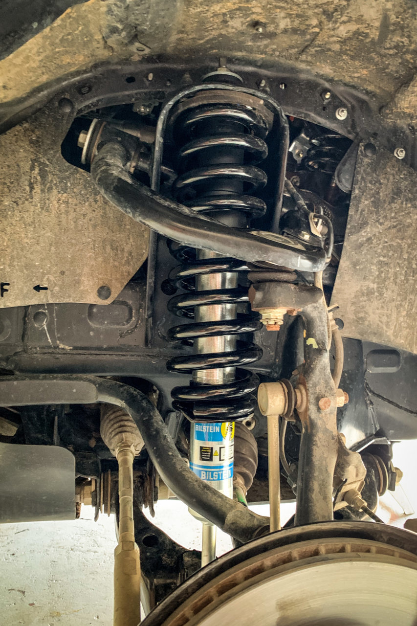

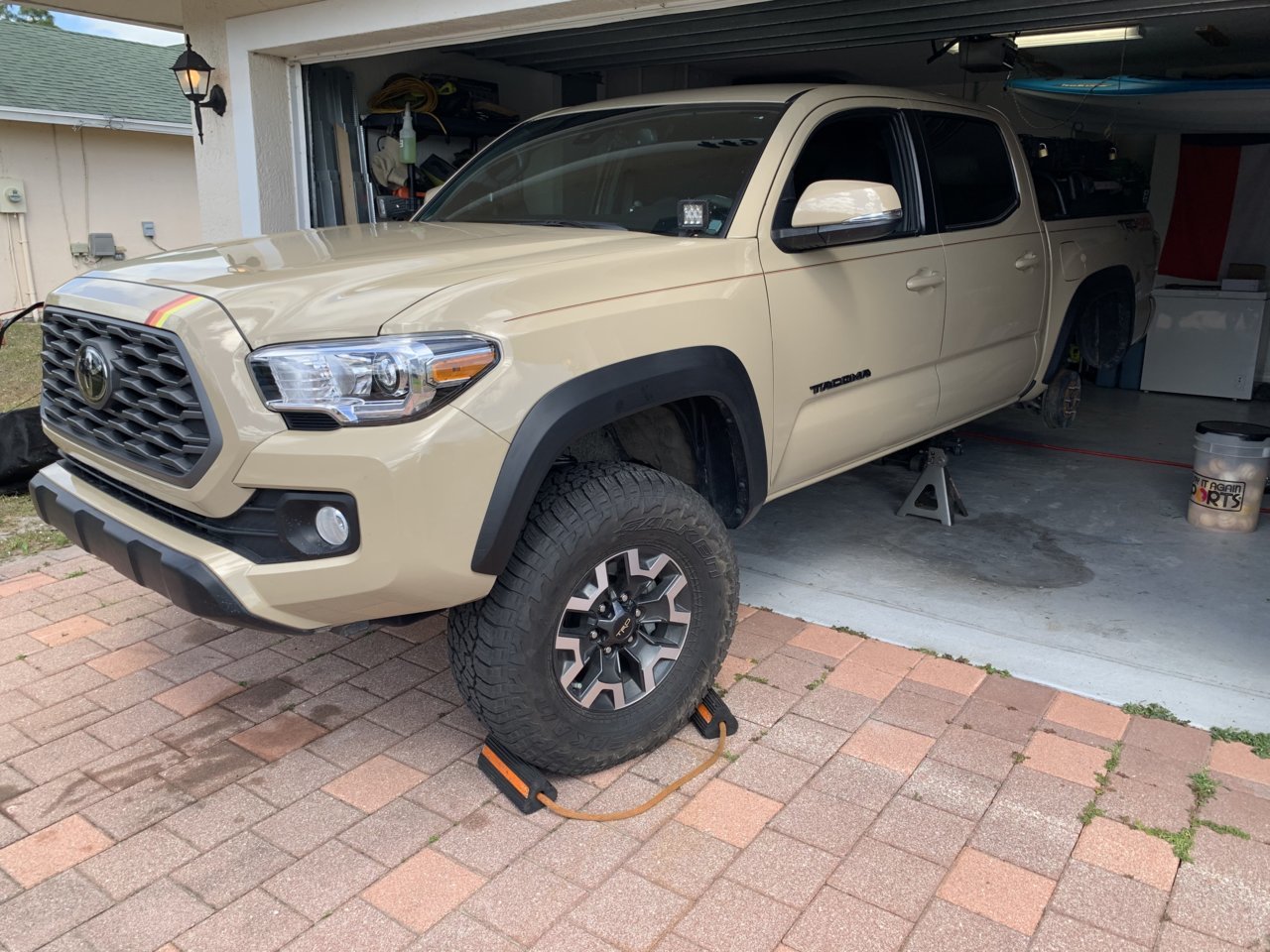

    So for the lift instead of paying a shop to install it and throwing way more money than needed at it, I brought the truck over to @Trident904 and we got it done in roughly 4hrs.
    This was including a trip to the local parts store to get correct hardware for one of the rear shocks that was sent with bad and missing washers and top nut.
    E1AD3BBE-21E7-4D92-A4D7-AF095D1DA065.jpg 5EB4715C-D467-4805-B3C6-4D4A417F7F25.jpg 4C2EDA35-4271-411C-AFEA-2BE61492A838.jpg
    With the fronts done we moved onto the rear.
    I wanted to keep the overload in with how much towing I do, you’ll need to do a little more grinding to keep the overload in.
    These were the rear shocks, the top shock in the photo had the right hardware, the bottom shock was missing a washer and had to small of a nut.

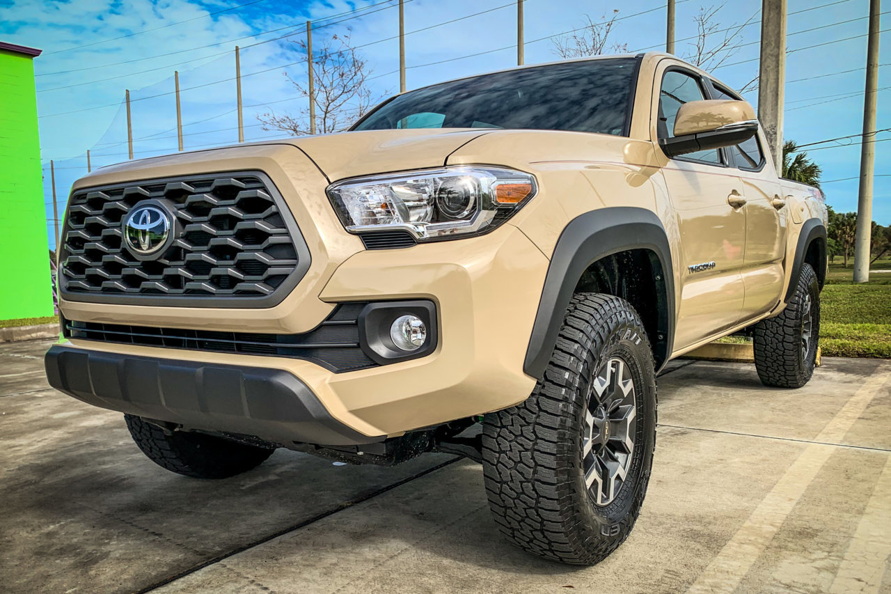

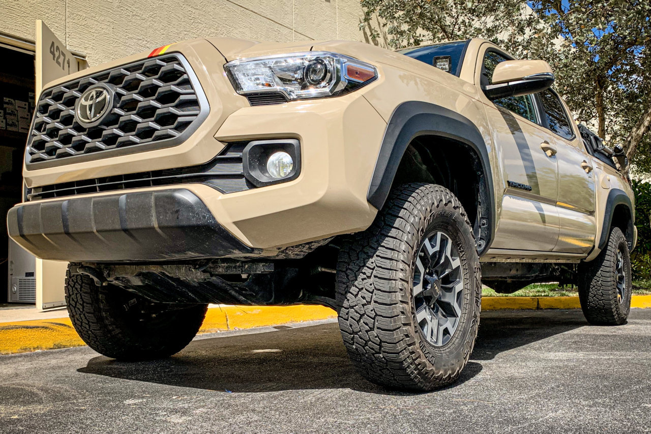

    With the lift Installed it brought me from roughly 21” from center of the hub to fender in all 4 corners to 23”.
    With the weight of the rack it had it sitting level already.

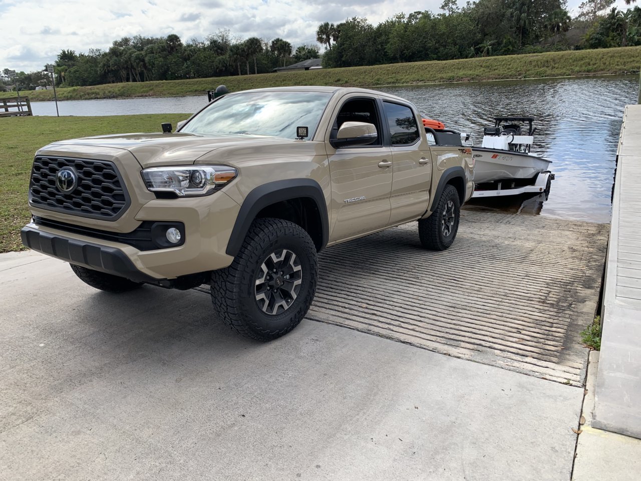

    I wasn’t a big fan of the auto trans but I kept the bitching about it to myself. Too many posts about it lol. After putting 3.5k on this truck I’ve come to the conclusion that it’s the only way to buy this truck to actually use it for what I want.
    My biggest concern was launching the skiff, Towing the boat is a breeze with the manual. Better mpg than the auto towing i’ve found. 859ECD9A-3136-45D9-83C4-B587818E5391.jpg
    A little feathering of the E-Brake and you’re all good.

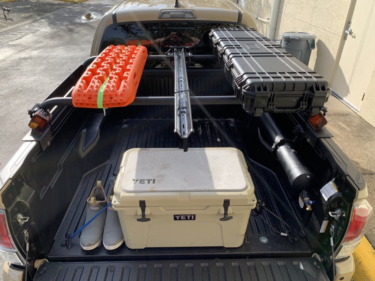

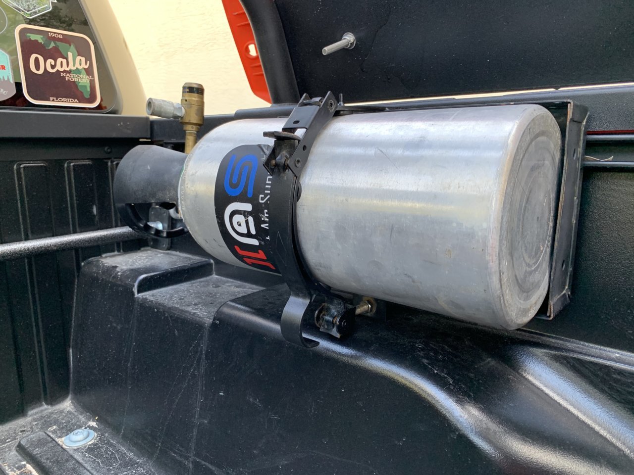

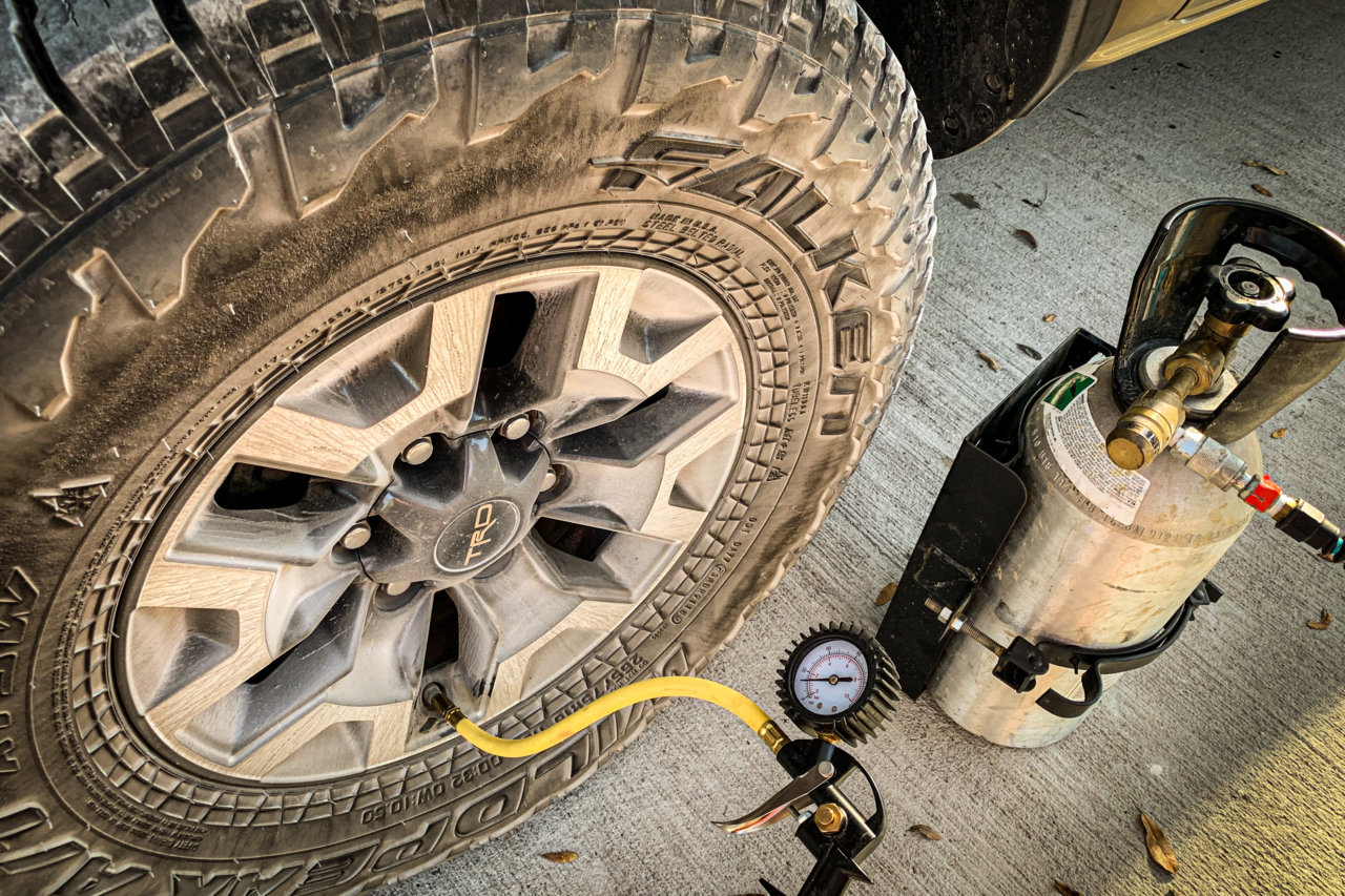

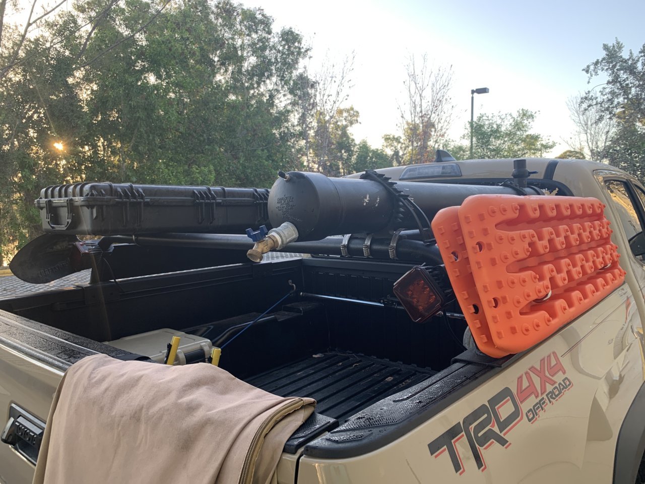

    Finally mounted the Instant Air Supply Co2 Tank. I wanted to mount it Vertical but with the height of the rack it was a no go. 681E8EEA-BA83-4B6F-B793-83A364A9ABBB.jpg image.jpg

    Remember, don’t try to use the CO2 tank with it horizontal like that.

    I'm going to try to slide the rack back tomorrow and mount it vertical, if anything I'm going to order the T-slot rail for the front of the bed and mount it there. That rail might also serve as a spot to mount some rotopax or jerry cans.
