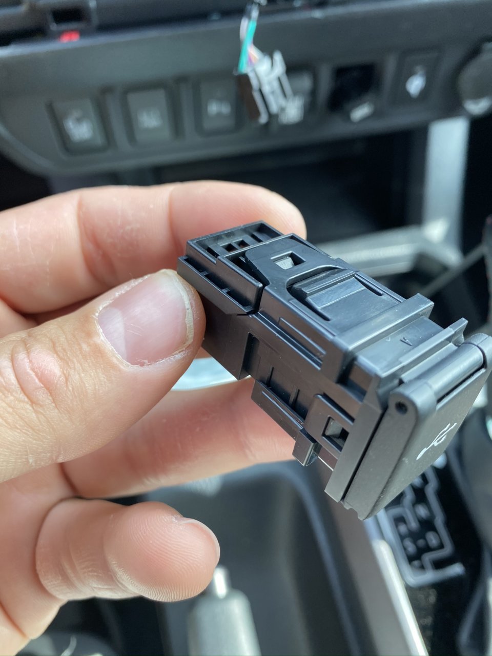

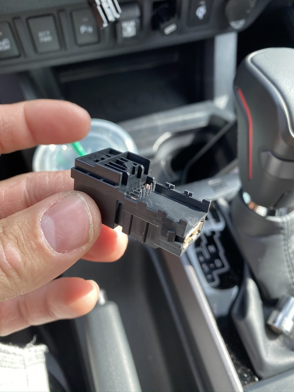

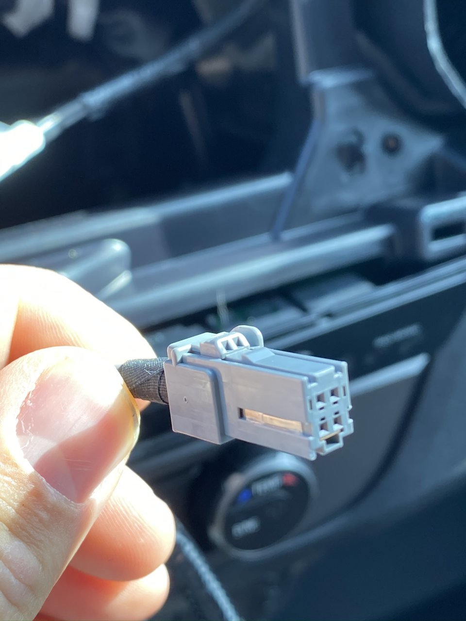

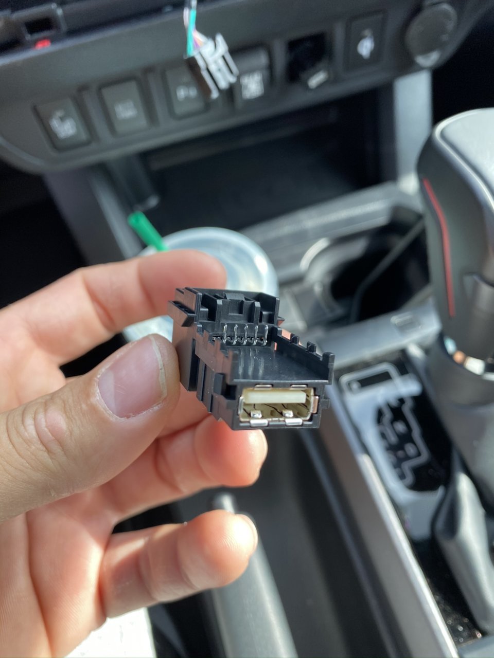

    I love that the new Tacos have apple car play, however I hated the fact that it was in the front USB! It drives me insane having a USB cable just hanging! I wanted to relocate my media port to the center console! I ordered some parts I thought would work, come to find out they did not! Long story short I did the following!
    After removing trim, unscrewing radio and unclipping climate control I was able to remove USB by pressing tab with a flathead.
    Ideally I wanted to find a cable that fit the stock USB so I could keep that one functional in the front, I did not find it. Here are some pics of the USB, and after I took it apart.
    At this point I thought I would just use this hide it behind panel and plug a USB extension to run to center console (which is what I did) and put empty cover back on.

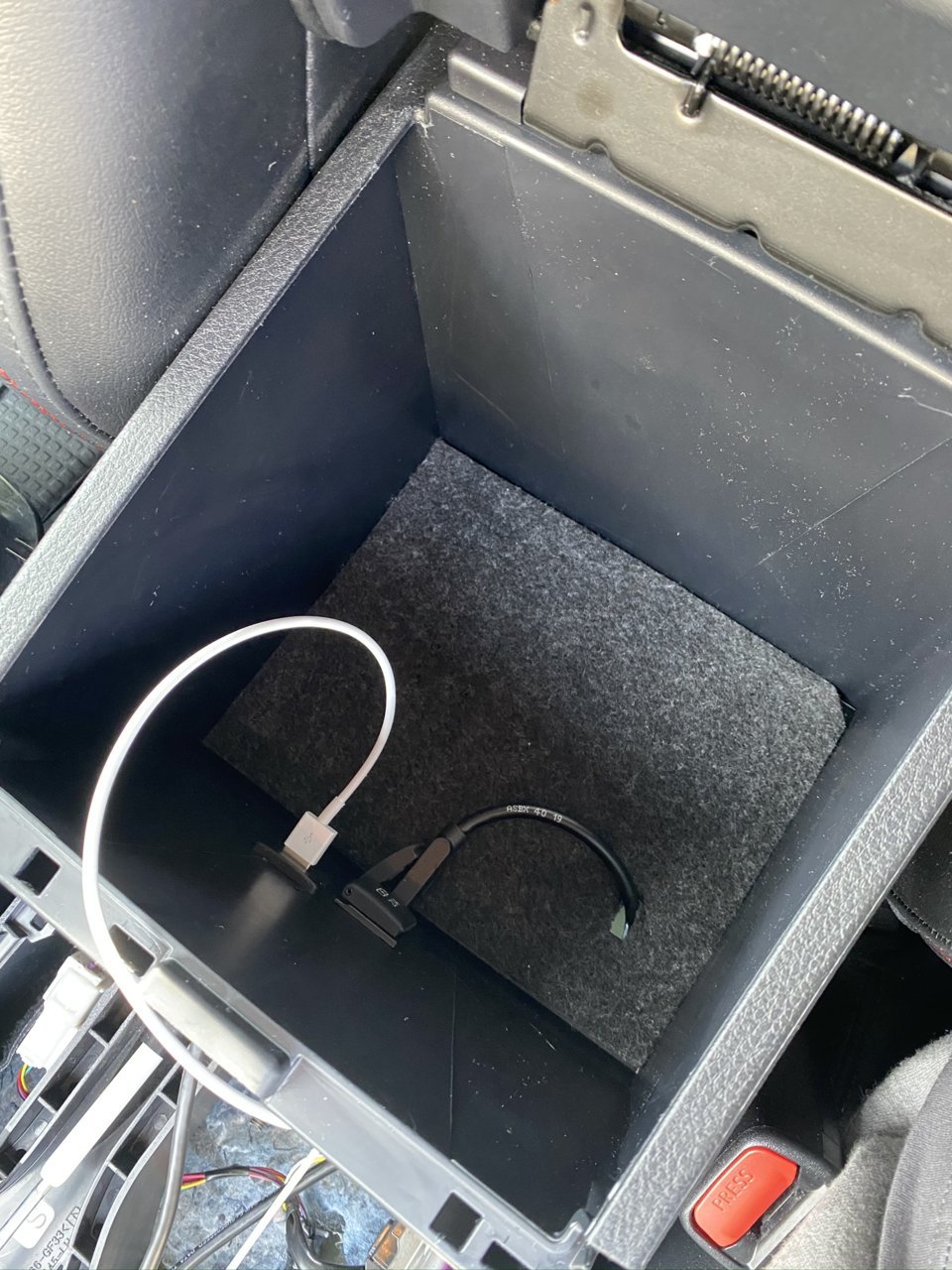

    However I was still going to have USB cover with a hole when opened so I thought about maybe running another extension from center console to front. I do not need 3 USB plug ins in center console so I did just that.
    I had to epoxy one end of the USB to the empty USB cover. It seems sturdy, hope it holds...
    After letting epoxy dry an hr I carefully mounted USB plug and ran wire to center console. Now I have a functioning USB charger in the front.
    This is what the inside of the center console looks like now. My lightning cable is connected to the new extension which enables carplay. The bottom USB is connected to the front via extension as well, top USB is open.

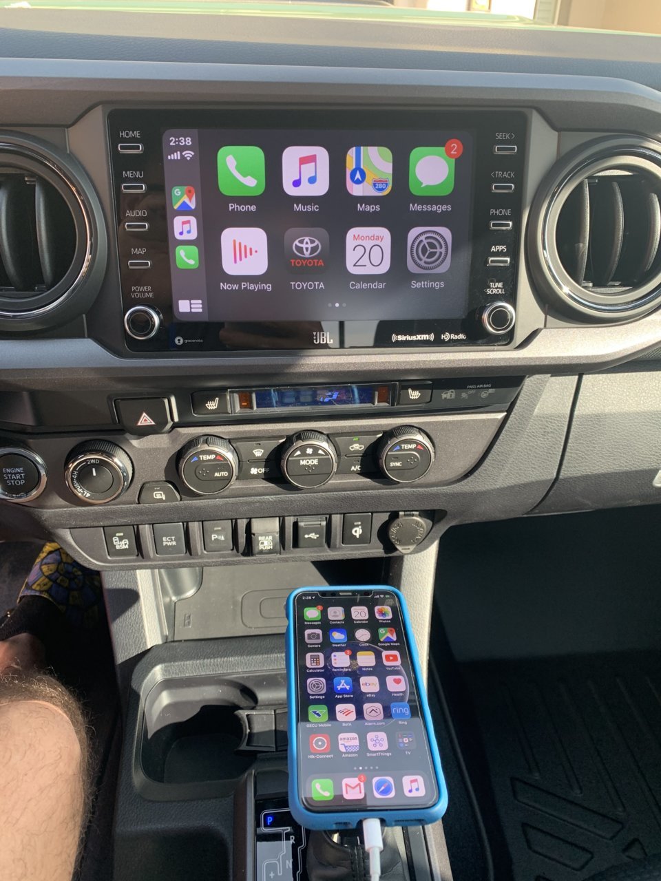

    Carplay from center console!

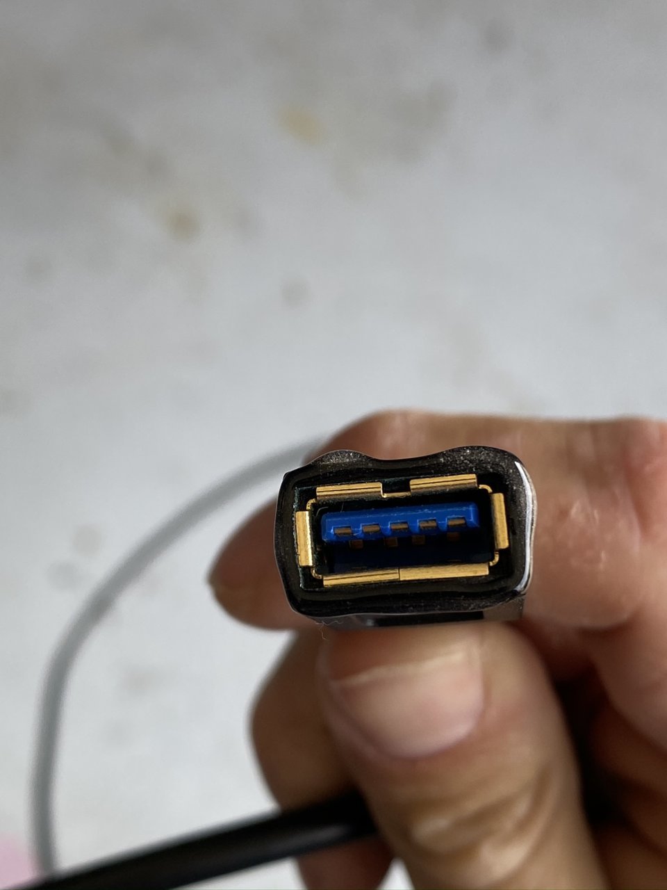

    FYI this is the usb that plugs to the back of the unit, not sure if it's different from previous years. I ordered a plug that was supposed to fit back of unit and it did not.

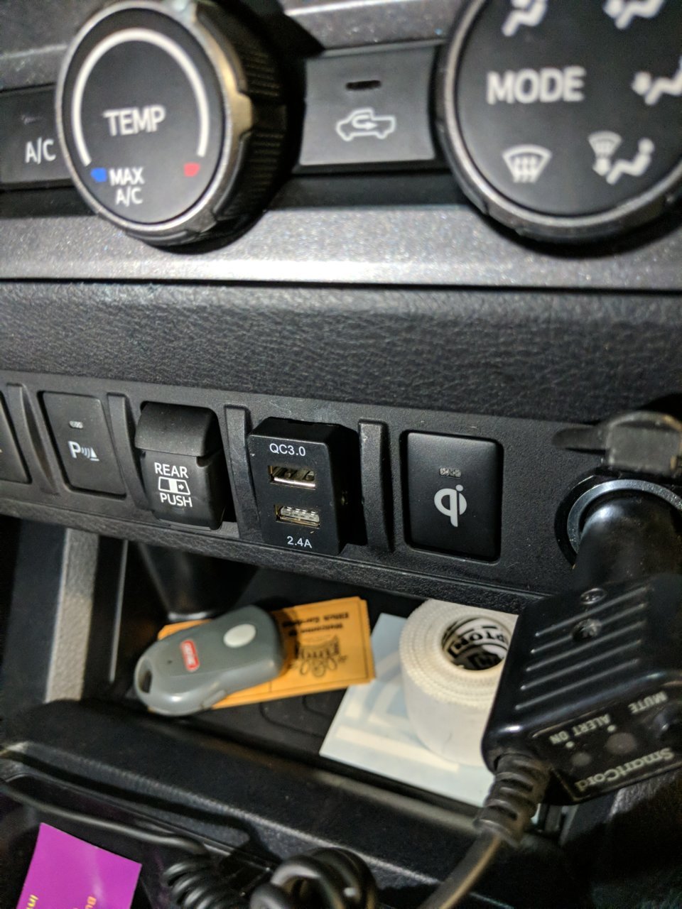

    Just did mine as well the same method with a USB extension. Replaced it with a powered USB port.
    I kind of don't like it seeing as it doesn't fit will. I will probably just end up replacing it with something else. However, since that hole is a bit wider and shorter than the standard swiches, hard to fit something in there.
