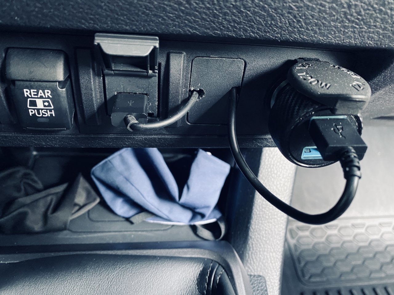

    Didn’t take any pictures. But I purchased the adapter harness from aliexpress, unplugged the factory media port from the back of the radio, plugged in the new port, finagled it down to the center console and attached it to a 6ft anker usb to lightning cord.
    Lastly I put a tiny notch next to the USB ports in the console, just enough for the cord itself and reassembled.
    with that I have a 6ft black lightning cable that can reach anywhere in the cabin, and is wired for media.
    yeah the factory port is dead, but I’ll never use it and it’s easily reversible.

    I ended up moving the factory port itself into the center console and then where the factory power used to be, putting a fast charging USB port in its place for the passengers.

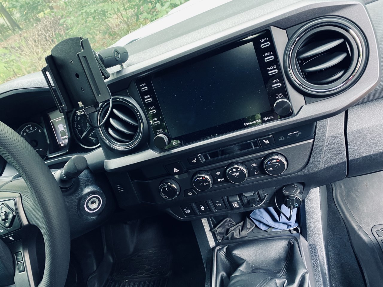

    Any idea if the cable above would work on the non-JBL radio in a 2021 OR? I currently have the OEM USB cable disconnected from the port and floating behind the dash with a USB extension running up to a DMM mounted phone. The whole connection is wrapped in electrical tape to protect the OEM pins but wouldn't mind switching out and setting aside the OEM cable.

    Yes it will. I ran that specific cable, along with a extension to my center compartment in my non Jbl 2020 sport. Works great.
