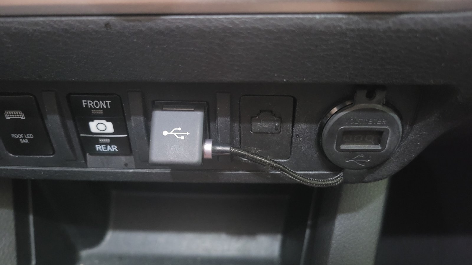

    I'm interested in doing it your way with some small modifications. Could you just clarify that what I plan to do would work please? Just wanna make sure I won't mess anything up.
    I have a 22 TRD Sport.
    My plan is to cut off the female USB A plug off this cable and connecting it to the harness coming from the radio (yellow to red (power), blue to black (ground), purple to white (D+), orange to green (D-)). From there I'll plug my wireless android auto device and mount it somewhere ontop of the radio so it's not visible. Lastly, use the rest of the converter to tap into the ground and power of the cigarette lighter and wire the previously cut usb end the same way as described above. Is there any other issue with what I've posted? Thanks in advance!

    My 22 Sport has USB ports in the central console. Yours does not?
  4. Nov 20, 2023 at 12:44 PM
    #84
    WalkingTornado
    WalkingTornado Kind-of Known Member
    May 18, 2021
    #366106
    133
    2022 Army Green TRD Sport MT
    It does, but that's for charging only I believe. It doesn't pull up the android auto. I have the Motorola MA1 to give me the ability to use wireless android auto. The dongle however is visible and I'd like to tuck it away in the dash. I'd also like to convert that central dash port into a charging one so that it still serves a purpose. Wondering if the wiring I wrote about would work.

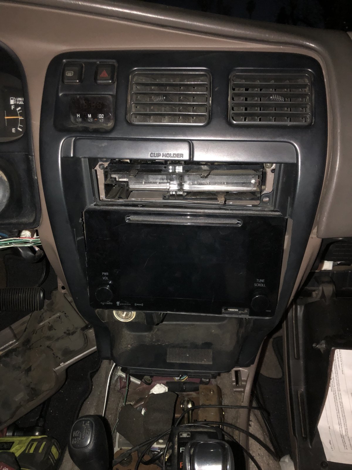

    Hello I have a 1997 Toyota 4Runner , in my project I’ve purchased a STOCK 2020 Tacoma head unit because I love to obtain this Toyota look and i absolutely love my head unit in my 2020 camry so I knew this was something I needed to add to my 4Runner , however this is a COMPLETELY CUSTOM project, currently this project is my daily use for Bluetooth only
    I’ve purchased a ;
    https://www.ebay.com/itm/333959045702
    6 PCS Set Wiring Harness Toyota RAV4 Corolla Prado Radio CD USB AUX AV Bluetooth
    https://www.ebay.com/itm/176157876796?epid=10063613601
    GPS NAVIGATION ROOF ANTENNA MODULE OEM 2020-2023 TOYOTA TACOMA 86862-58020
    I’m still looking to purchase a gps Sim Card so that my maps can load , a front camera that has a front and back camera botton from
    https://www.anytimebackupcamera.com/products/2020-kit
    I’m am looking for your help I still want to obtain the USB PORT WHERE YOUR PHONE PLUGS IN AND AUTOMATICALLY CONNECTS TO APPLE CARPLAY
    IF ANYONE CAN HELP ME WITH THAT PART OR PLACE TO BUY IT THANK YOU MY FELLOW TOYOTIANS

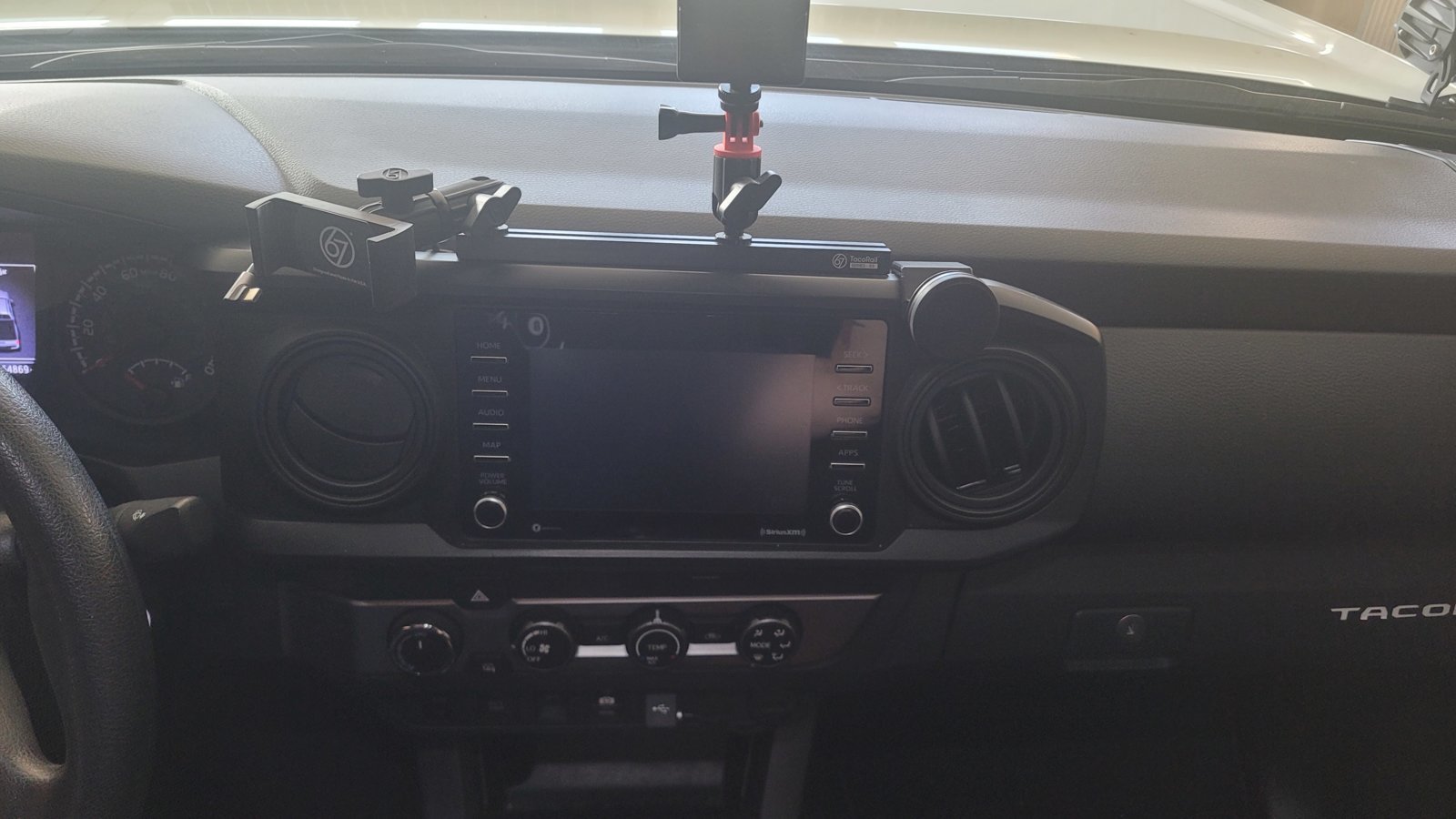

    This is how it looks

    Southwest Tacoma
    Southwest Tacoma Well-Known Member
    Mar 5, 2020
    #321331
    396
    Southwest
    2020 Super White SR DCSB
    Another option. I used a USB cable with 90 degree ends, routed it behind the head unit and out behind my Taco Rail where it plugs into my phone.

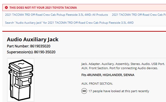

    4
    21 Tacoma TRD Off Road
    Does anyone know the part number for the media port? I need to replace mine and can’t find it anywhere online.

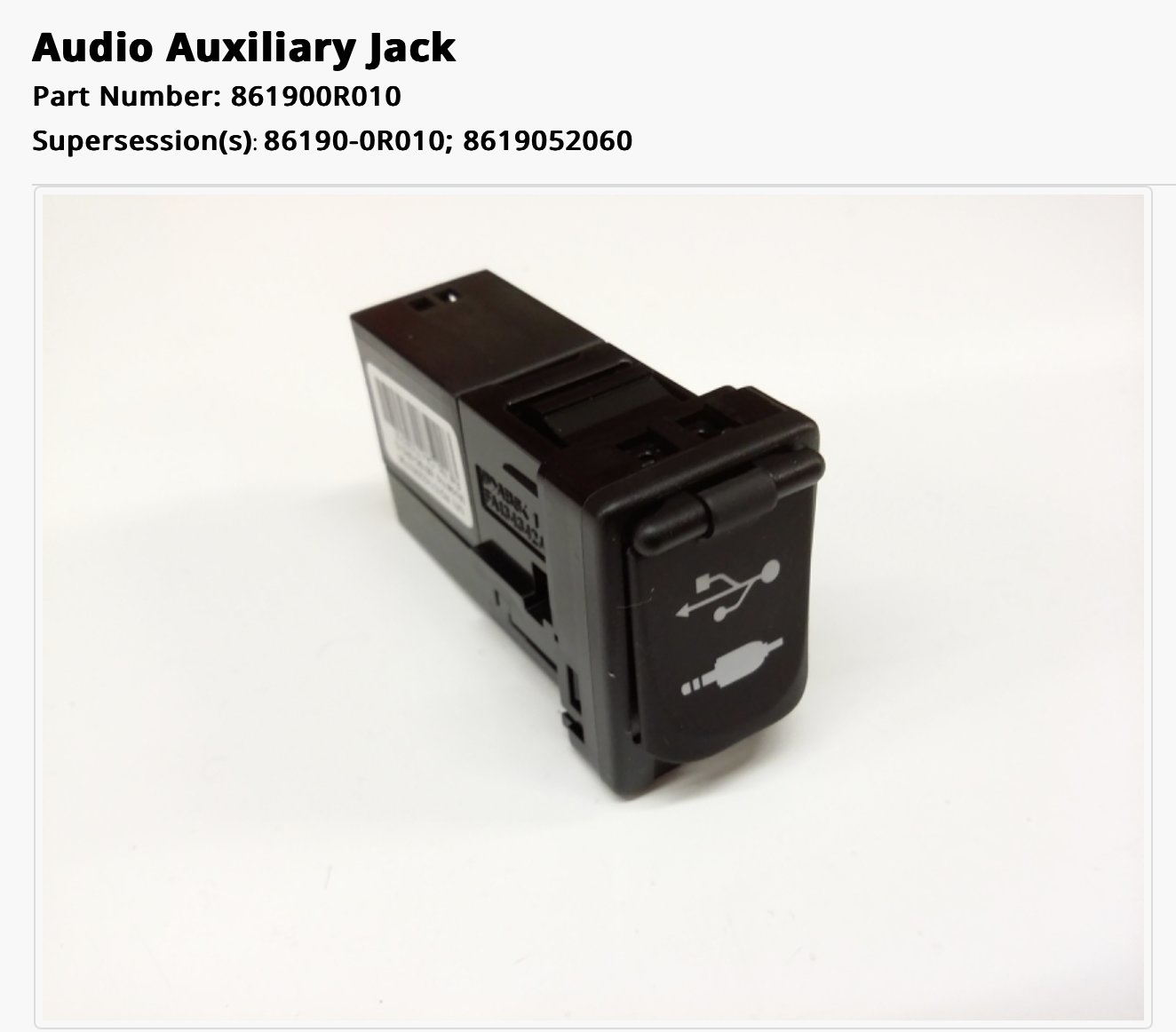

  11. Mar 13, 2024 at 7:14 AM
    #91
    markram
    markram Well-Known Member
    Feb 26, 2008
    #4967
    552
    washington, state of
    2020 TRD OR DCSB 4X4 Cement
    this what your looking for?

  14. Mar 13, 2024 at 2:23 PM
    #94
    markram
    Feb 26, 2008
    #4967
    552
    ok, see if this number will work for you...

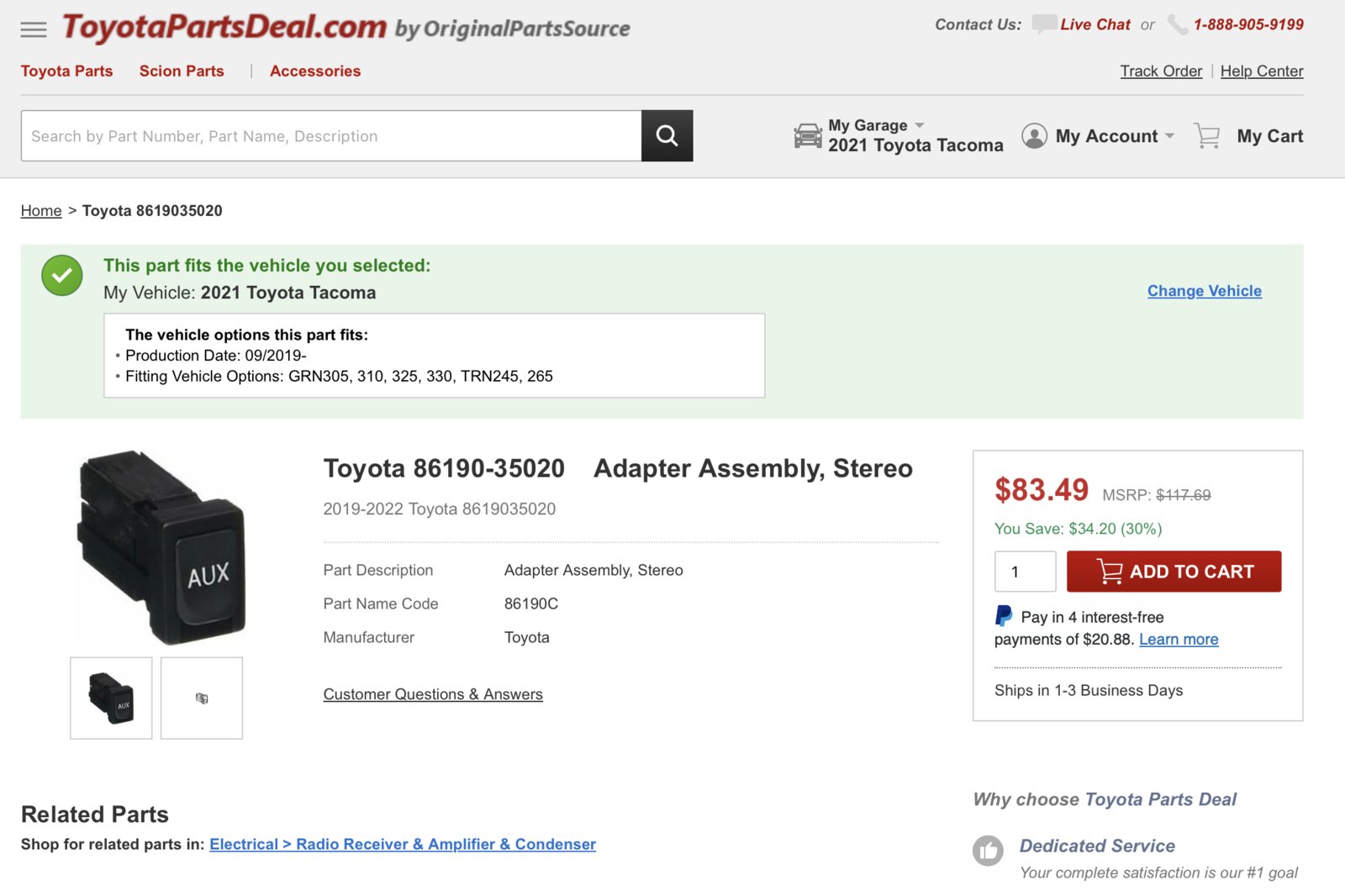

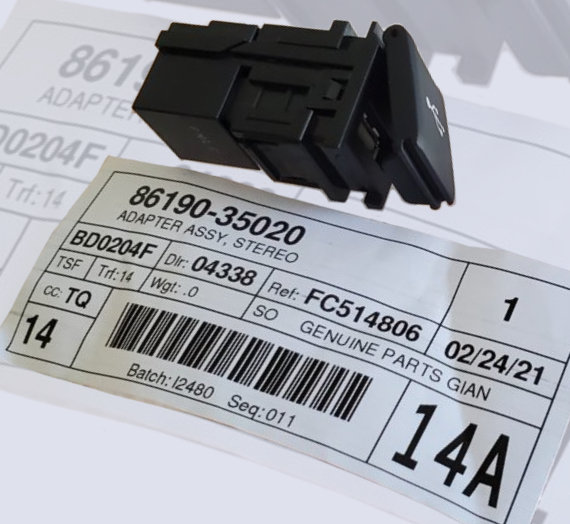

  18. Mar 14, 2024 at 7:44 AM
    #98
    markram
    Feb 26, 2008
    #4967
    552
    kinda weird how some websites say it will fit and others say it won't. i would do as 2020SilverSky suggested and if you do find the correct part number post it on here... :thumbsup:
