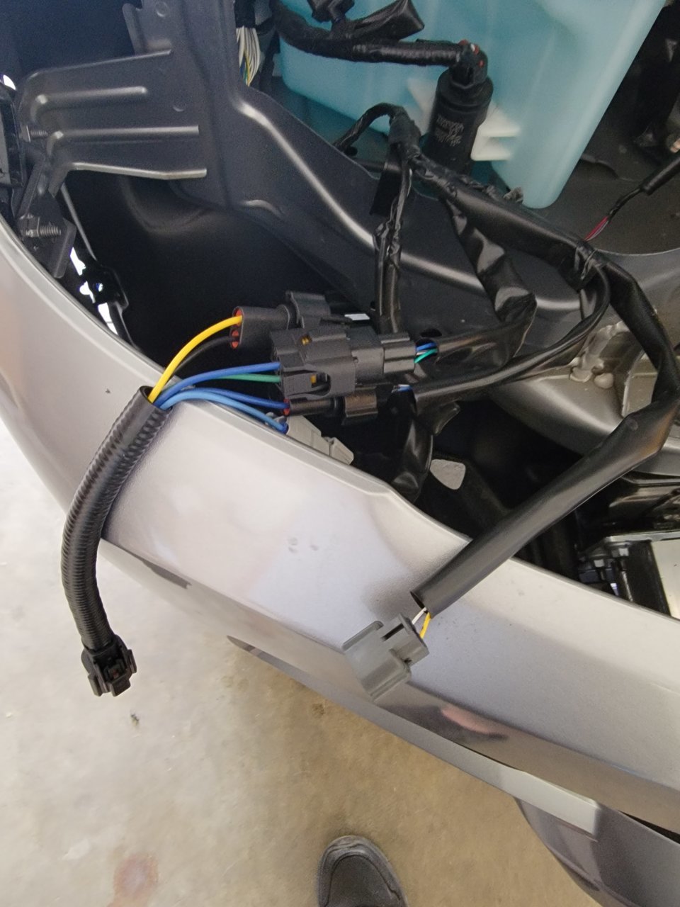

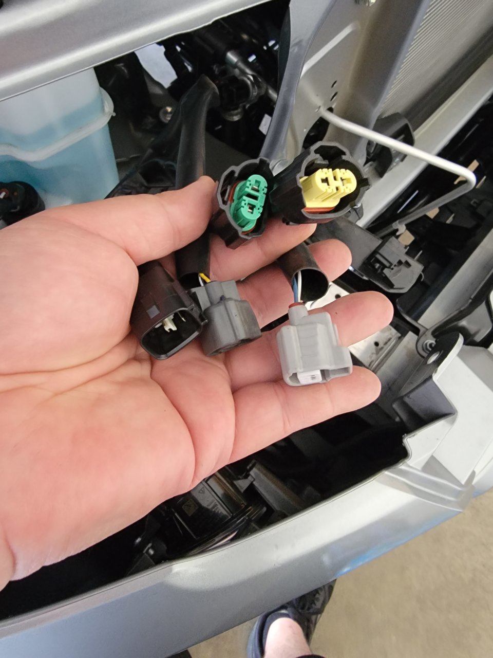

    one of them is not used. Use the supplied cap to cap it off.

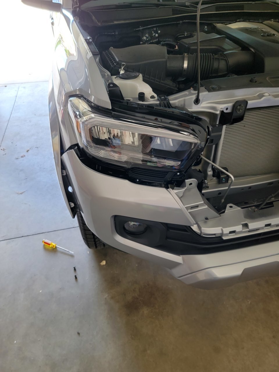

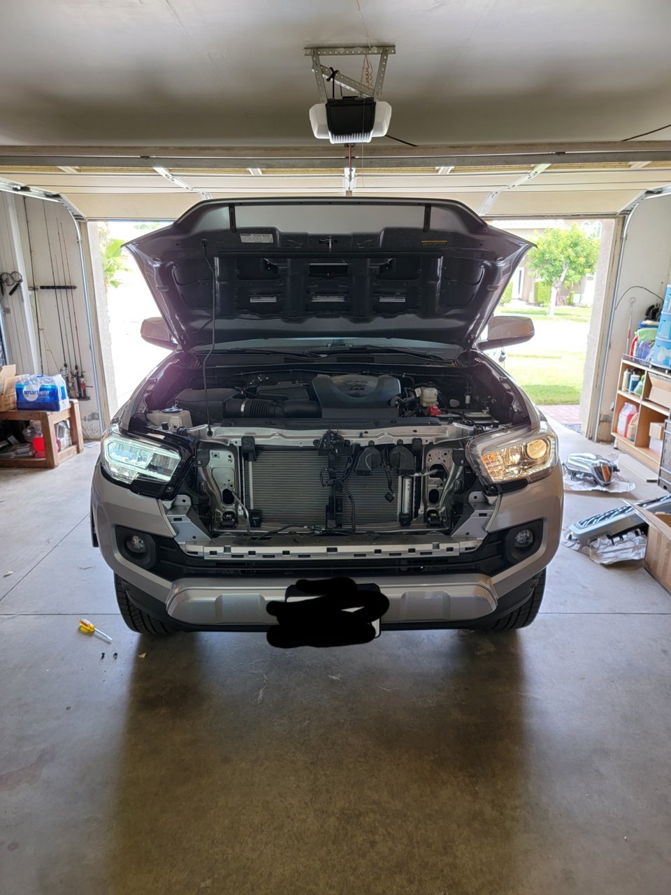

    So putting the new assembly in is being a bit of a challenge for me. Is there easy way to put back in? Feel like im gonna scratch the hell out of it and the paint trying to put it in.
    Whew! Got it in! Had to bend that lower bumper piece and use a little force.

    I also found that part to be a bit more effort than I expected, and I managed to put a small scratch in mine doing it. I think once you've done one pair you are all set for the next pair so it's a bummer we're all doing one-and-done.
    Also, the headlight trim panels are a fun thing to do with this since the bumper is down but if you didn't already order them up then this is really poor timing to mention them :)

    It's working! Adjustment doesn't seem to be needed? Drivers side should be faster since i know the feel for things now.
    Thank you all that have been helping me out with this.

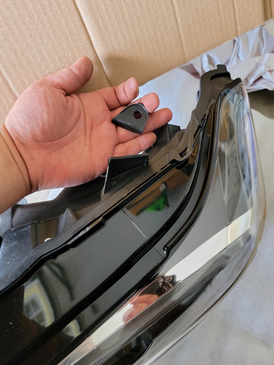

    My effing luck... came broken
    Ahhhhhhh!!!!!
    Guess im driving frankeneyes for the week.
    Didn't bother to check before install, because it was packaged very well inside...

    Yup, I had everything ready to install too, when i put the light in, i was like nooooooo!!! Found the tab in the box, fml. I guess my fault for not checking first. I am super annoyed and tired right now lol.

    I sure wish I had a means to buy one of these broken tab LED headlights for my test harness. If the dealer you bought them from doesn't require you to ship them back, hit me up. I think they mostly take them back, get credit from Toyota, and they end up in a trash bin which is a shame.

    What you guys think of repairing tabs? This guy does the Tacoma headlights.

    It’s definitely doable. @no vtec 4me has done it a bunch.
    but for brand new full price merch packed poorly, I’d consider that not your problem.

    I fix broken tabs all the time and never have an issue with them failing. They need to be plastic welded. Most people just try using epoxy or something to glue them together and that never lasts.

    They are requiring me to send it back. They said they won't be able to order another for me, and to find it locally. I wonder if it's back ordered now, or they don't want to risk another damaged headlight to me...
