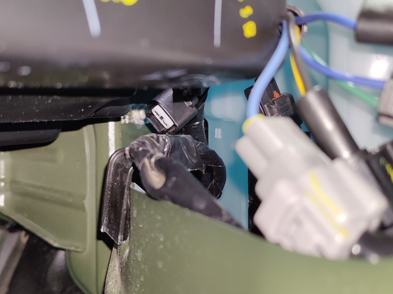

    Hey guys, I was looking at the passenger side headlight guy wiring harness, I see one plug that doesn't go to anything, least that's what I came up with. Attach is the plug by the windshield washer reservoir.
    Please can someone confirm this stays unplugged?
  16. May 1, 2021 at 9:59 AM
    #1816
    no vtec 4me
    no vtec 4me Well-Known Member
    Jan 29, 2017
    #209016
    1,595
    Kevin
    West Chester, Pa
    2017 Tacoma TRD Sport
    yup that’s not headlight related
  17. May 1, 2021 at 11:04 AM
    #1817
    poe_fosho
    poe_fosho Well-Known Member
    Nov 23, 2020
    #347630
    62
    Colorado
    2021 Tacoma TRD Sport 6 Speed Manual
    Ok that makes me feel a bit better, but what the heck does it go too? Other see that when they did the swap?
  18. May 1, 2021 at 11:14 AM
    #1818
    daveeasa
    daveeasa FBC Harness Solutions
    May 14, 2020
    #328079
    7,479
    David
    PNW
    2016 Tacoma OR DCSB 6MT, 2005 RC 5MT PreRunner, 2002 Tundra SR5 RCLB 4x4
    Is this your truck or someone else's? It's some video of the installation where you're noticing it?
    It looks to me like it could be the female 6 pin MX150 which plugs into the LED headlight (the other end of the conversion harness) but that's a tough photo. Some additional context?
    EDIT: Actually, looking at it again, I think it's the sidemarker. You cap that with a male or you cover it with tape. I am pretty sure mine is grey so the black threw me off but OEM connectors come in black, white and grey depending on the batch. 99% confidence that is a female sidemarker which feeds the OEM Halogen but isn't needed for the OEM LED. For the LED housing, the sidemarker is fed from parking light which comes through off the DRL connector (as you need the DRL wire for DRL capability so might as well tap there for parking light vs an additional connector in the conversion harness.
    If this isn't your truck, as mentioned before, you got this bro! We will walk you through any trouble, just take your time and if you hit a snag post up.
    My colors are potentially different than others but connector-wise, clockwise from the bottom, female MX150 feeding LED headlight, DRL, H9 high beam, H11 low beam, Turn (grey)

  19. May 1, 2021 at 12:14 PM
    #1819
    poe_fosho
    Nov 23, 2020
    #347630
    62
    Colorado
    Hey there!
    Thanks for support. It was my truck. I just finished the install and noticed it..
    I had one of mike's clips break on me :(
    I just reached out to him about a replacement.
    Yes the driver side didn't have that connector I noticed.
    Let me know if you want anymore photos, but the new headlights work fine. I was just concerned it was left out in the open like that..
    For the meantime I just taped the connector together until I get the replacement.
  20. May 1, 2021 at 12:45 PM
    #1820
    no vtec 4me
    Jan 29, 2017
    #209016
    1,595
    Kevin
    West Chester, Pa
    that connector is for an accessory or something your truck doesn’t have. It was never plugged in.
