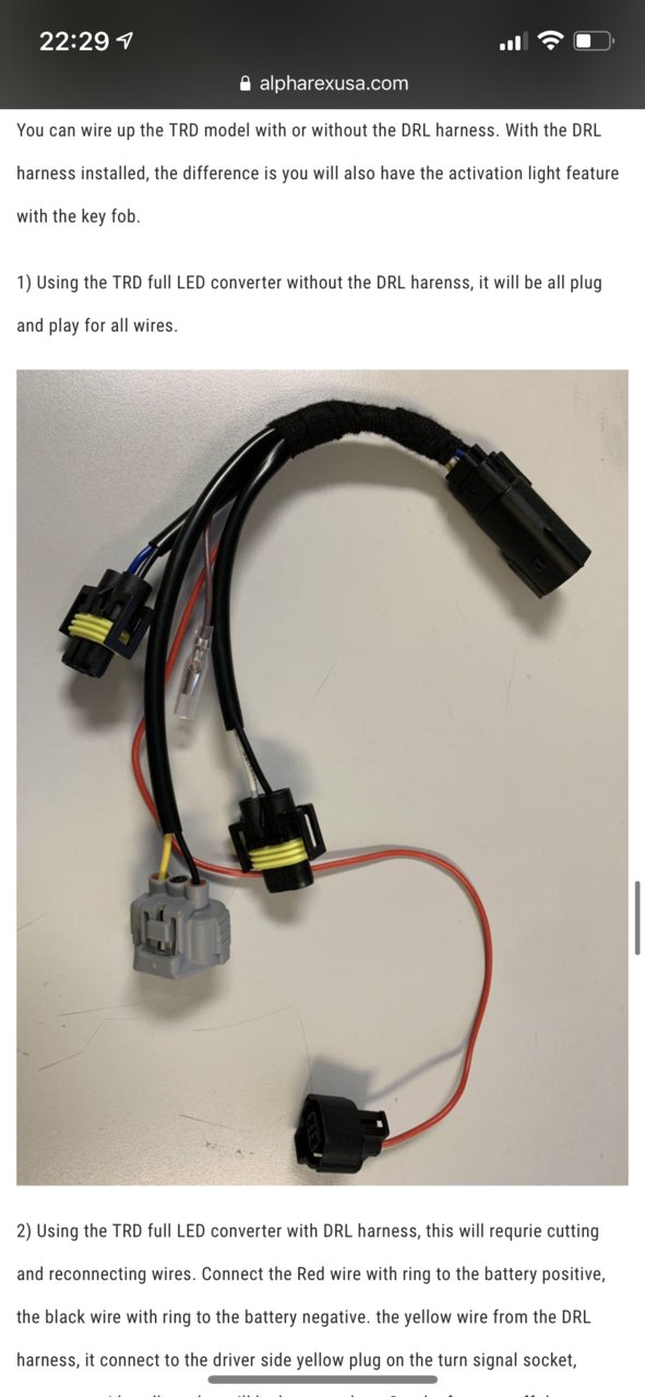

    [​IMG] So I made the mistake of buying the alpharex knock offs.. they don’t perform well, but came with a wiring harness for installation.
    I just ordered the OEM headlights, and wondering if anyone knows if the alpharex conversion harness will also work with the oem headlights.. if not I need to pick up a new harness. Thanks!
    Edit: added photo from install guide

    Post a photo of the harness and we can help you.

    I added a photo from the install guide, if this isn’t helpful let me know and I can try to get a better photo from my truck

    I believe the harness you posted is for SR / SR5. A photo of your harness would be best assuming you do have a sport.

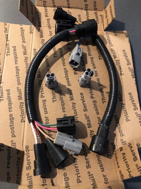

    I found a pic of my harness prior to install on TRD OR. Not sure if this would help.

    daveeasa
    daveeasa FBC Harness Solutions
    May 14, 2020
    #328079
    7,479
    David
    PNW
    2016 Tacoma OR DCSB 6MT, 2005 RC 5MT PreRunner, 2002 Tundra SR5 RCLB 4x4
    That’s the one, should be good with it. Looks like a Mike harness to me.

  10. Jun 5, 2021 at 8:28 AM
    #1870
    MiTacoTRD
    MiTacoTRD Well-Known Member
    Aug 24, 2019
    #303129
    1,359
    N. Idaho
    2019 Tacoma TRD Off-Road DCSB
    That’s affirm! Solid harness.
