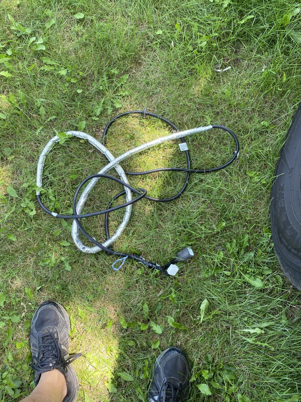

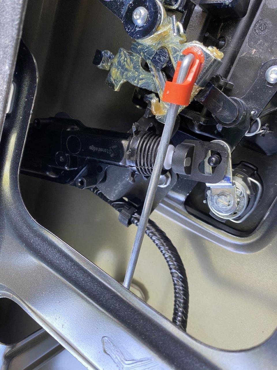

    Just installed own kit today works great with oem remote

    Is it plug and play or did you have to splice something? Also how much was it?
  6. Aug 8, 2020 at 6:42 PM
    xsquid
    xsquid Well-Known Member
    May 8, 2018
    #252897
    171
    SF Bay Area
    If you go with OEM it’s basically plug & play. OEM kit runs ~$150. There’s a few threads on em.

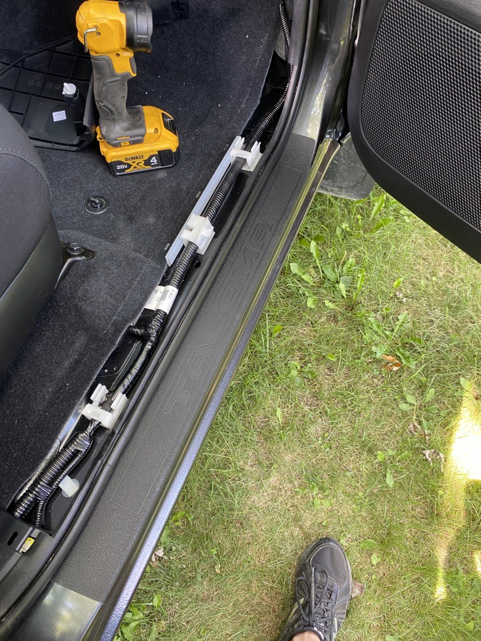

    Installed the OEM kit on my 19. It is plug and play. No drilling, cut some plastic Zipties and metal Zipties(bands) that secure harness near exhaust. Hardest part was getting harness thru rubber grommet under passenger seat carpet. Removing seat bolts made it much easier.
    Wear eye protection, Dirt from undercarriage will definitely fall in your eyes/mouth.

    The OEM kit was well worth the money. Fit perfect right out the box. One of the easiest and useful mods I’ve done on my truck. Makes you wonder why Toyota hasn’t made it a standard build.
