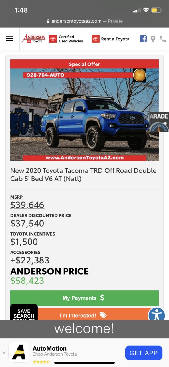

    Hello, I just bought a 2020 trd off-road from the dealer a month ago, the truck has a 3in toytech full suspension lift with upgraded leaf springs, it’s sitting on 17in fuel wheels with 285/70/17 BFG tires, everything was put on by dealer prior to purchase, truck now has 3k Miles on it, I am having an issue when truck is cruising at 80mph it will not shift out of 4th gear most of the time and be ringing it’s neck at 5300 RPM for 5 plus minutes on a flat even highway even with a slight road decline, taken to dealer twice for them to just tell me it’s normal! I’m getting 11mpg I believe it needs to be re geared, dealer will not help although they built this truck and had it on display as their “dealer special upgraded truck” paid 47k for truck and they won’t do nothing, any help or ideas? I will attach link to video of exactly what it’s doing!

    This truck was built by the dealer prior to purchase and not by my request, dealers said since they put it all on and certified it and that the truck was brand new they warranty it all, they put everything on themselves even roof rack and light bars

    This is my truck but someone bought the bed kit prior to me buying truck
