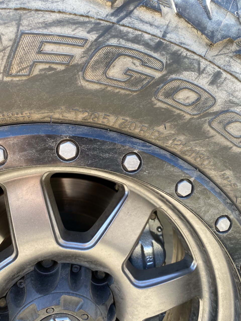

    That says 285/70R17 so if you know how to read your fingers dont know how to transcribe what you mean.
    Your first post says 285/75/17 tires which is a 34 inch tire.... which you just edited to read 285/70/17.
    Sorry bud.... in 4 days you've completely blown your credibility with me.

    Your right I had fat fingers and accidentally typed the wrong size and I apologize for that but regardless the issue at hand had nothing to do with speed or the 0.8 inch of tire height
