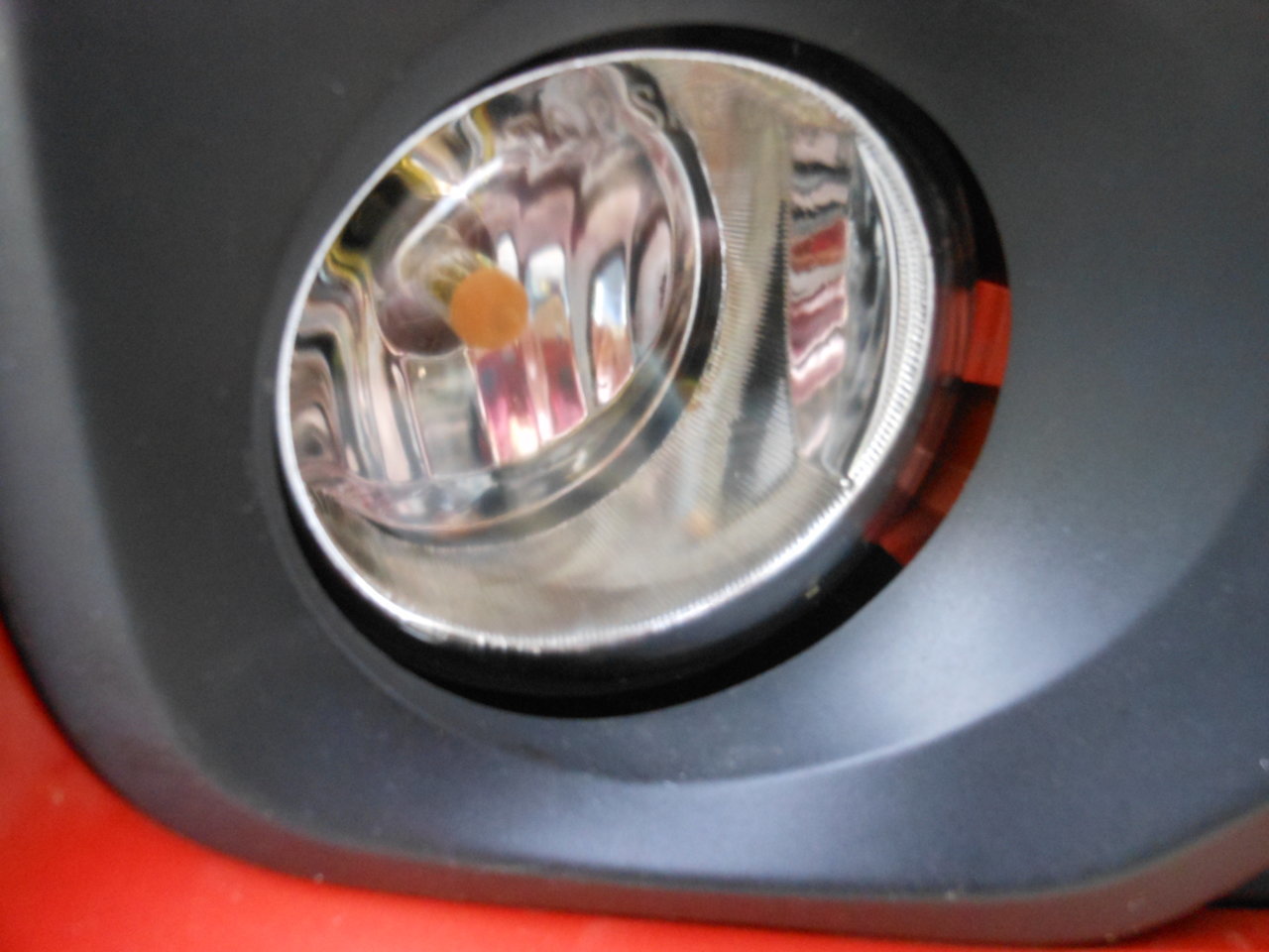

    Follow up to the install..... This is a nice quality product,....HOWEVER... The Unit that I needed to replace the OEM ones... The bulb housing itself) does not fit properly....The glass front does not come forward enough (1/4"--3/8") to tough the bezel.
    This leaves me a big hole for water and shit to come in there.....not like before.
    Not a good product.....:thumbsup: (turn this thumb down)...:eek::eek::eek:

    Here is how bad the fit is... That's 3/8" gap :eek:.

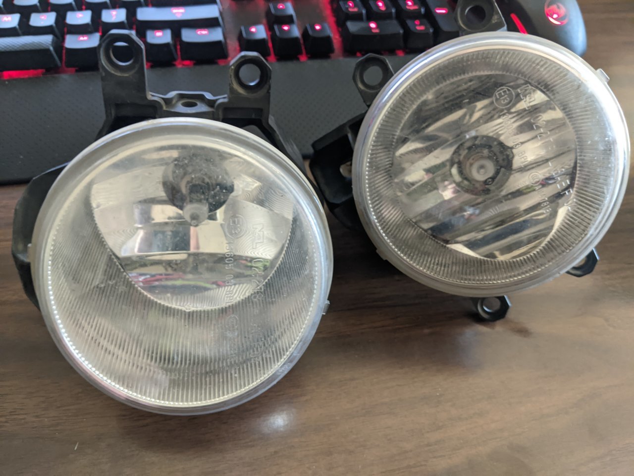

    I have a set of stock sr5 fogs off a 2018. They are yours if you want, just make an offered shipped.
