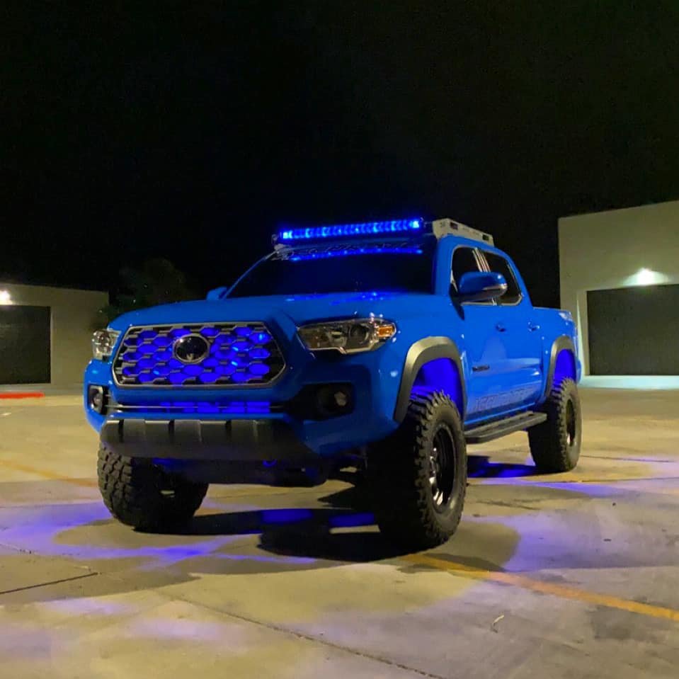

    2020 Tacoma won't shift past third gear on highway, problem occurs on cruise control @ 80 mph, will not shift past 3rd and will hold 5300rpms for many miles, tsb update has been done to truck, speedometer has been recalibrated, shift adaptives have been reset, pedal commander has been tried, does it weather ect is on or off. truck is slightly lifted on 33's every modification was put on by dealer before i purchased truck brand new, truck has been back to dealer 13 times, truck is still currently at dealer, problems started at 2500 miles, truck currently has 7100 miles i will attach link to youtube video of the problem and ill attach picture of truck, thank you for your help.
